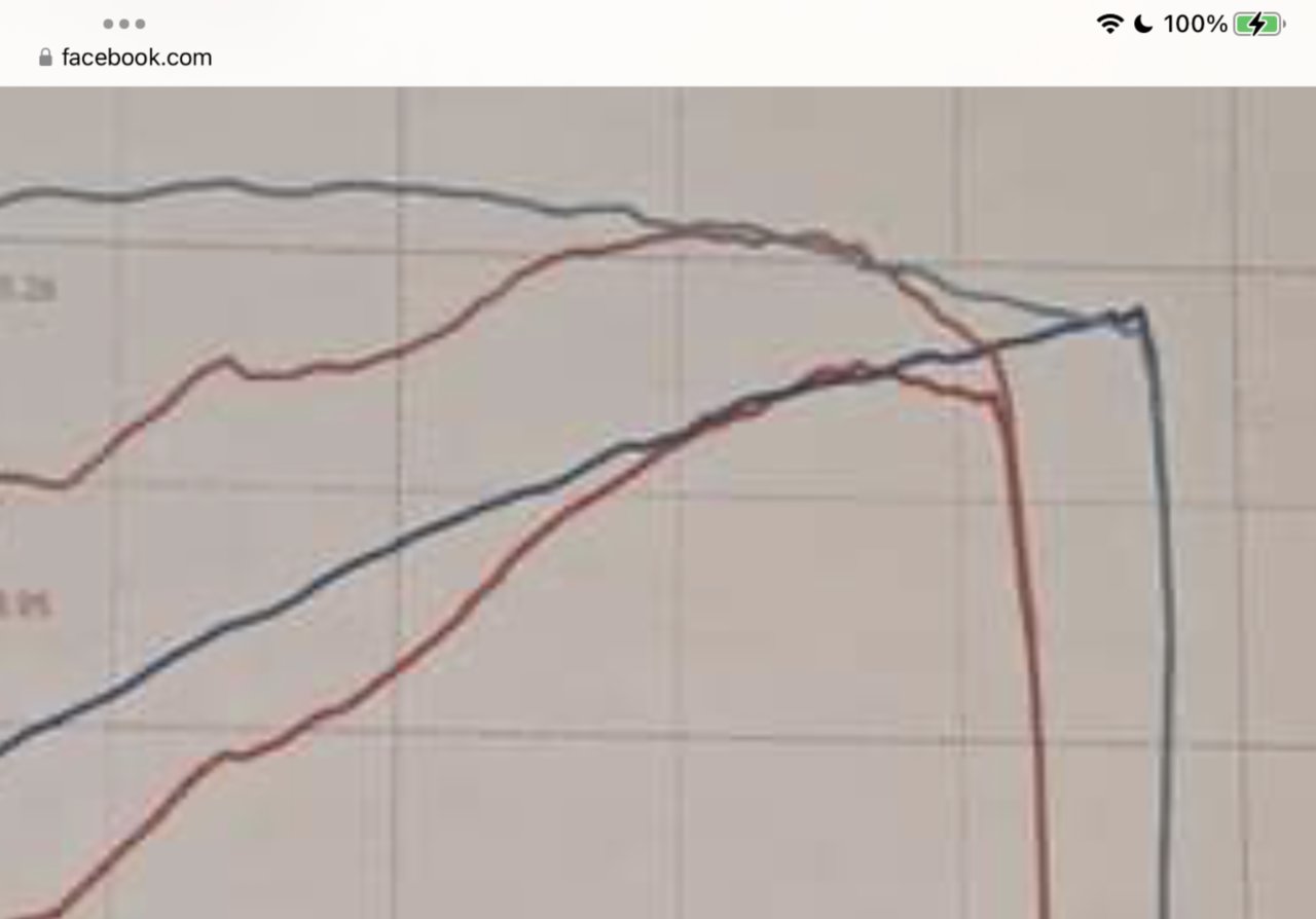

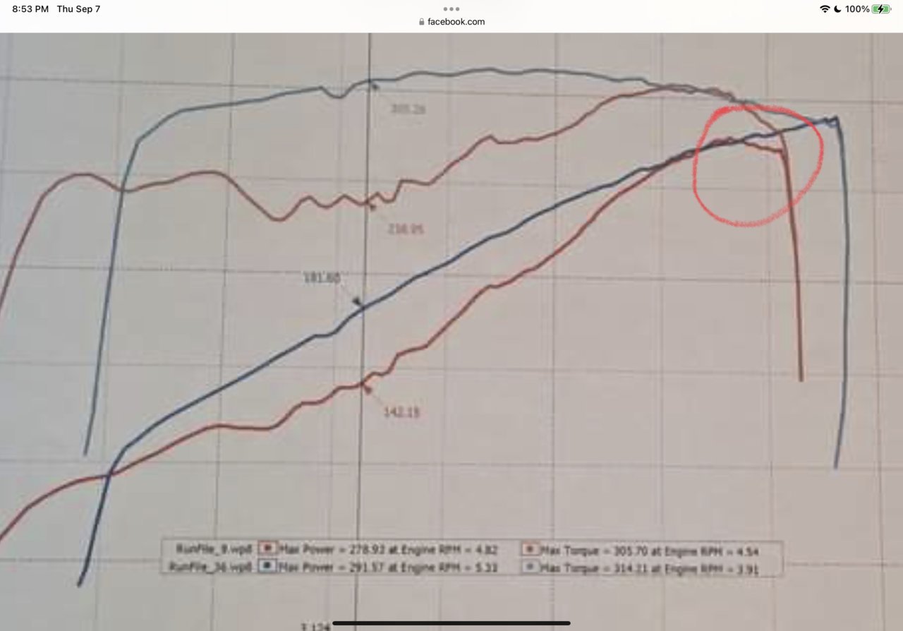

    Actually the efficiency is huge over the old supercharger.
    It puts out the same power with 4 pounds of boost compared to 7 pounds and heat soaked issues I have not seen and I’m not running methanol now,
    And you hit full boost much quicker,
    Power does not drop off like the old supercharger either from heat.
    the dyno graph shows the hp still claiming at redline too where the old supercharger it was going south before redline

    I always figured you were on a 2.2 or 2.1 pulley, but you were pushing 7psi on the old S/C?
    That graph is awesome though- about the same peak power but also so much more power under the curve.

    I had a custom pulley 1.9” and boost was 7-8 at 6000 feet.
    I lost about a pound with adding headers and varying with summer heat or winter temperatures.
    You can see the power goes south at the higher rpm’s too unlike the 1320,
    It’s funny because from years I’ve heard people say the power HP drop off was because of the cam valves.
    Guess they were all wrong :bananadance:

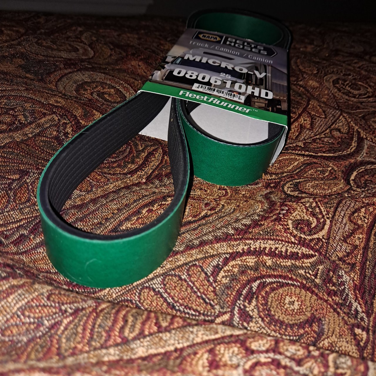

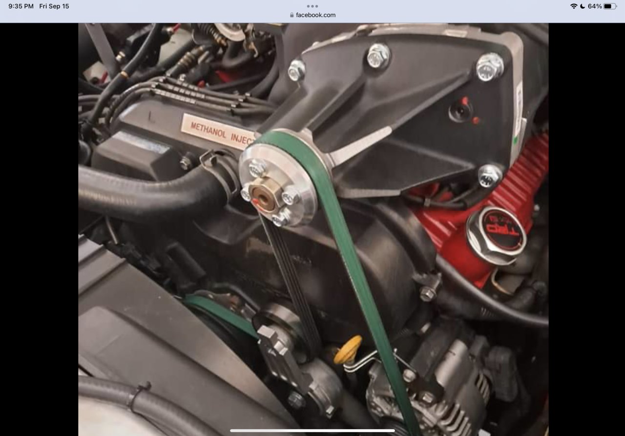

    So I found out that my supercharger pulley was slipping (belt was to large for the 65mm) causing the rocky part of the dyno graph.
    There is no 4 ribbed belt that’s the correct size needed so I found an 8 ribbed HD gates belt and cut it in half now having two belt.
    Runs much better now and gained a little more boost

    That's a good heavy duty belt.
