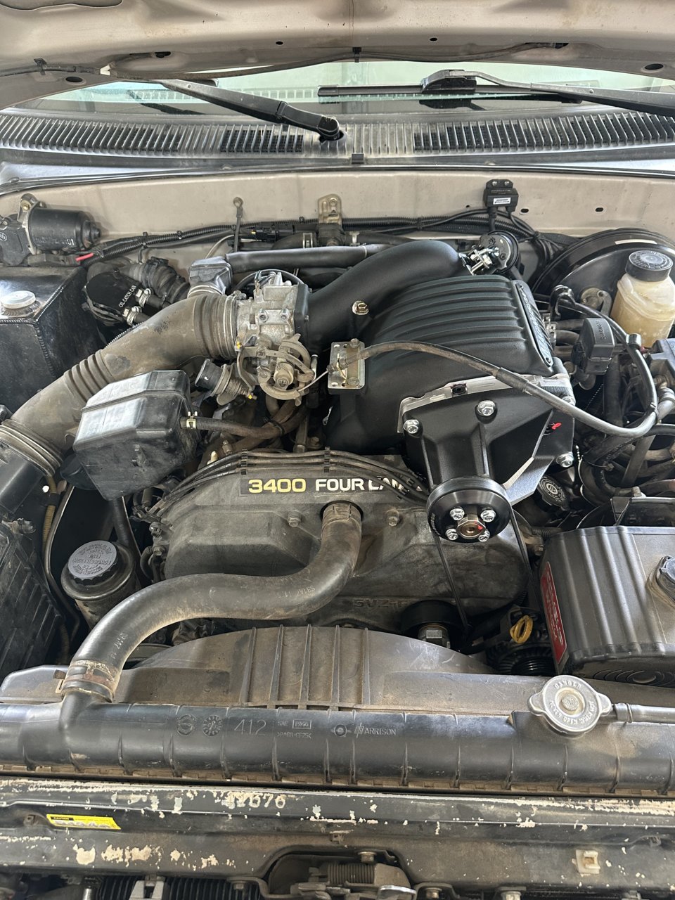

    Yours is black but they seem to only make them in blue, did you paint yours?

    I got mine from snpspeed.com.
    It’s a modified version for the 3.4 with the correct size barbs fitting and the correct hose and clamps

    Right, but on their own website they state its blue (even though the pic is of a black one).
    I'm on the war-path to put my OEM injectors back in and use their FMU kit to give me 'limp home' ability if my piggy has a failure. I now have had two separate Greddy EMUs have intermittent glitches, i think their solder age is showing.
    I want a black FMU to keep the OEM like look in the engine bay.

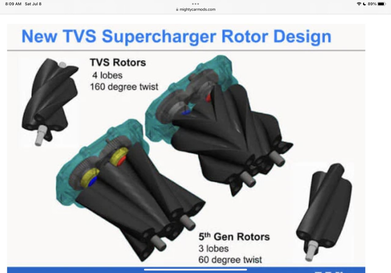

    The 1320 with the 65mm pulley came in at almost 300hp and 315 QT and my belt was slipping just a little,
    1320 has a lot more power without heat soaked issues and full boost is much sooner

    No, the snout doesn’t need to be modified and shaving the snout would gain only a few mm.
    The 65mm will work with the current snout.
    At 6000 feet + 65mm I get 5 pounds of boost compared to the 8 sometimes 9 from the old supercharger.
    The 5 pounds from the new supercharger is significantly more power than the old maxed out ported 1.9 pulley old supercharger because of efficiency and lack of heat issues and new rotor design
    another tvs1320 just got tuned at sea level and was at 7.5 boost but belt started slipping over 4000rpms.
    The belt was not adjusted tight enough at the alternator location.
    Boost probably will be 8-9 which is a lot at rotors being 30 percent bigger and 4 lobes instead of 3 and the rotors twist at 160 degrees instead of 60 degrees,
    it really a completely different supercharger on every level

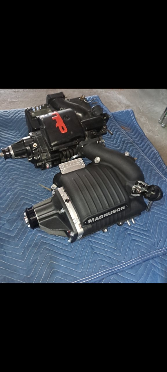

    Done, need a pulley to get back where the gen1 was with a 2.1/2.0 pulley. It’s been ordered so I’m just waiting for it to ship.

    Excellent neighborhood:),
    What pulley size and what tuning are you going?

    That thing hangs out over v/c a little more it looks like.

    It's a little longer, a little taller a little wider

    65mm so far. I would like smaller for sure.
    AEM FIC currently, I’ll jump to the Haltec soon but that’s a new engine harness and injectors. My current harness has been cut up to much to use with a stand alone.
    Are you on the north side of town?
