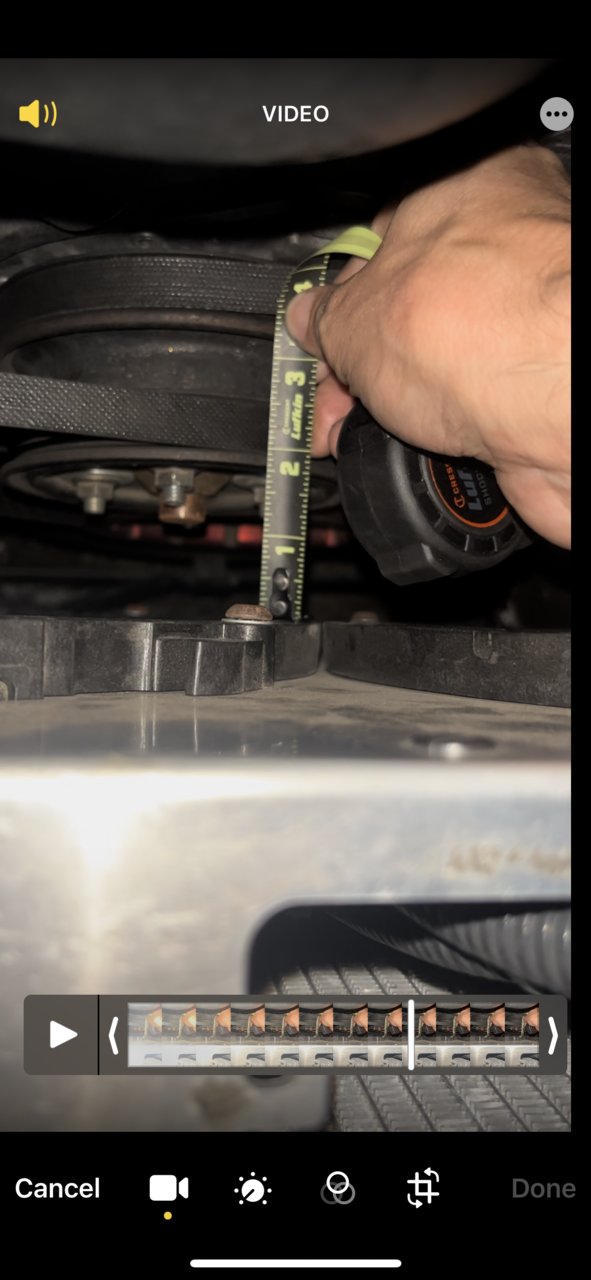

    What would be cool is if we could get a longer snout and a 6 rib pulley. With the correct electric fan setup you could, in theory, turn the fan bracket into a “jackshaft” and have a supercharger drive pulley made for the repurposed Jackshaft then run a single belt from the new Jackshaft pulley to the longer snout of the supercharger. That way we could finally get a 6 rib setup with a dedicated supercharger belt and tensioner. This would solve several issues. A much larger market for off the shelf belts, the supercharger belt being the outermost belt, and getting much higher potential for grip.
    obviously, that would all depend on being able to create enough space from a electric fan to fit all the updated pulleys, supports, etc. but I think it’s plenty doable.
    There is about 1.75” of room between 4” of shroud and fans and a 6 rib belt is like .875” wide. I think it’s definitely doable but might be tight and slimline fans might have to be utilized.
    this was actually something I’ve been thinking about for quite some time. I’ve spent countless hours over the last few years trying to create my own supercharger setup with a used TVS1320 or TVS1720 head unit and an old TRD Supercharger housing and mating them up. And doing all the brackets etc. but I’m a terrible fabricator and other things got in the way so I never really worked on it much. Now that the new system is out it’s solves most of those issues. Though I would have preferred a front inlet like the Colorado has which, in my completely unprofessional opinion would have better flow. But this new unit is much better.
    Maybe get this to Gabe to think over. Though, I’m sure he’s too busy to mess with something with such a small market.

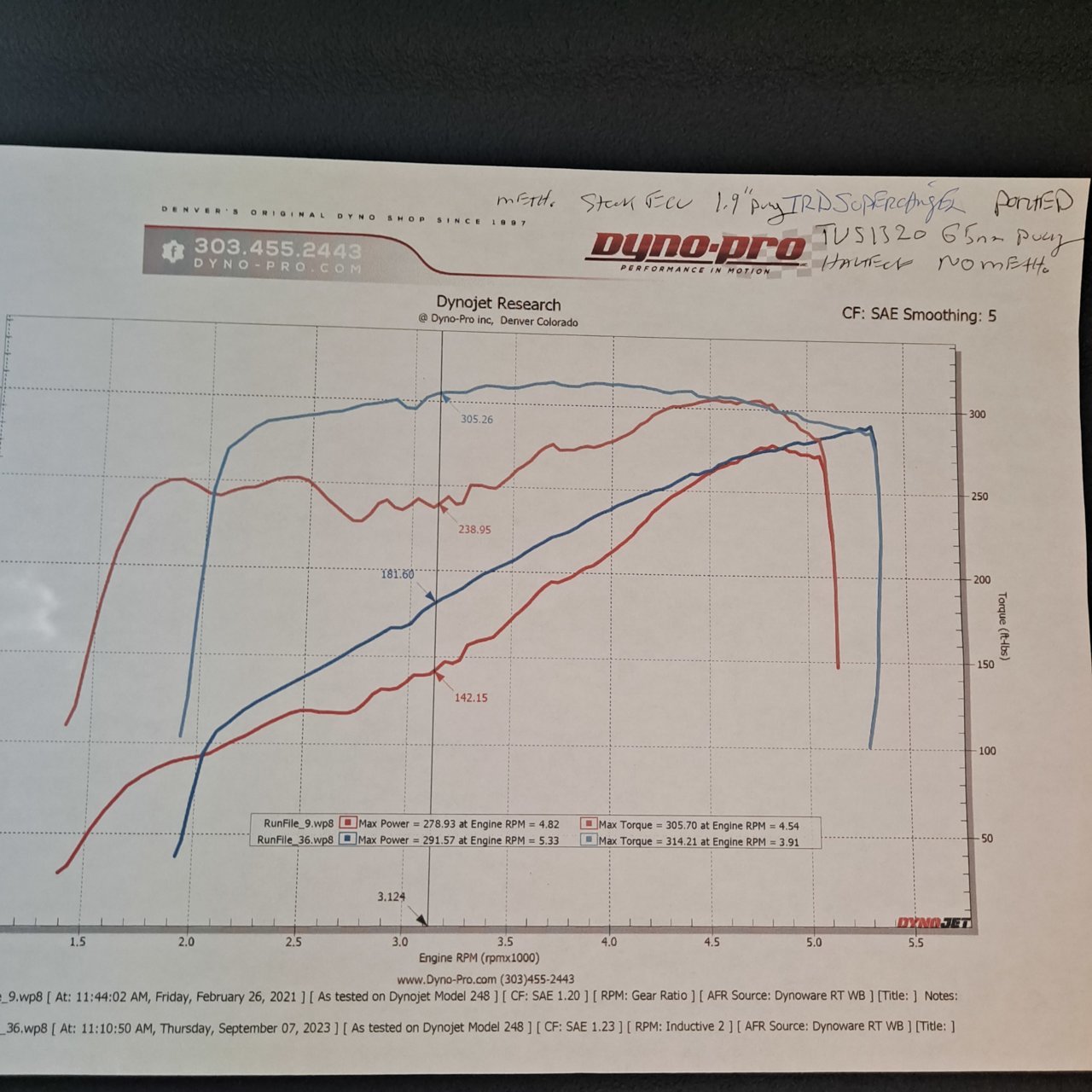

    So this dyno is comparing the TVS1320 with standalone to a M62 on stock ECU and meth?
    Do you have one comparing M62 with standalone to TVS1320 with standalone?

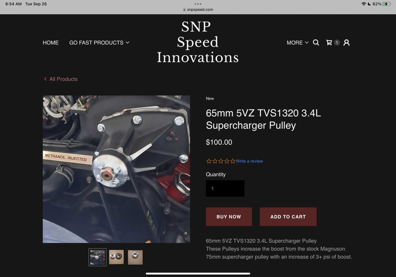

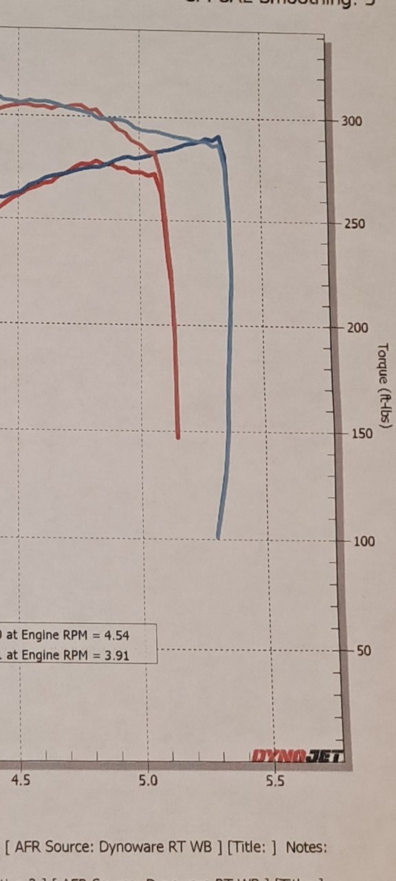

    My belt was slipping because it was too long for the 65mm pulley, you cant use the same stock belt and I need to raise the red line to 6k and do another dyno.
    The tvs1320 is still making positive hp at 5400rpms in blue unlike the TRD supercharger the hp goes south at 4800rpms
