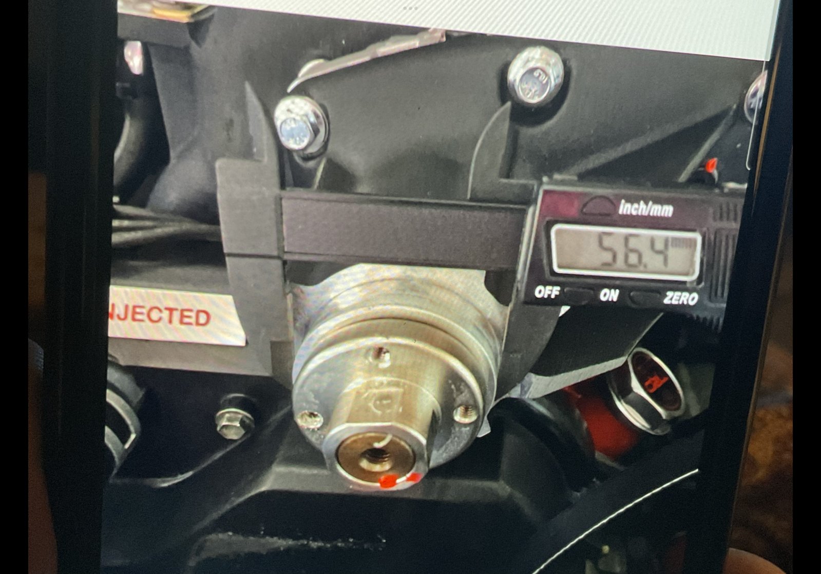

    @1997tacomav6 got that, but I would like to measure my snout to see if it's the one that can fit the 60mm pulley or is there anyway else too know. So I don't buy the pulley at some point too relize it won't fit.

    Umm, so which snout do you have? Do you have the one with the extra/large support fins or no? Beefier snout can use the 65mm pulley. The less beefier snout can go to the smaller 60mm pulley for more boost. @1997tacomav6 was pretty clear with his answer IMO.
    @Althornes post a photo of your snout

    @SUMOTNK gotcha! Didn't notice the difference in fin size in his pictures. Apologies dude, just assumed the shaft that the pulley bolted up too would be the main difference. Guess I didn't pay enough attention!

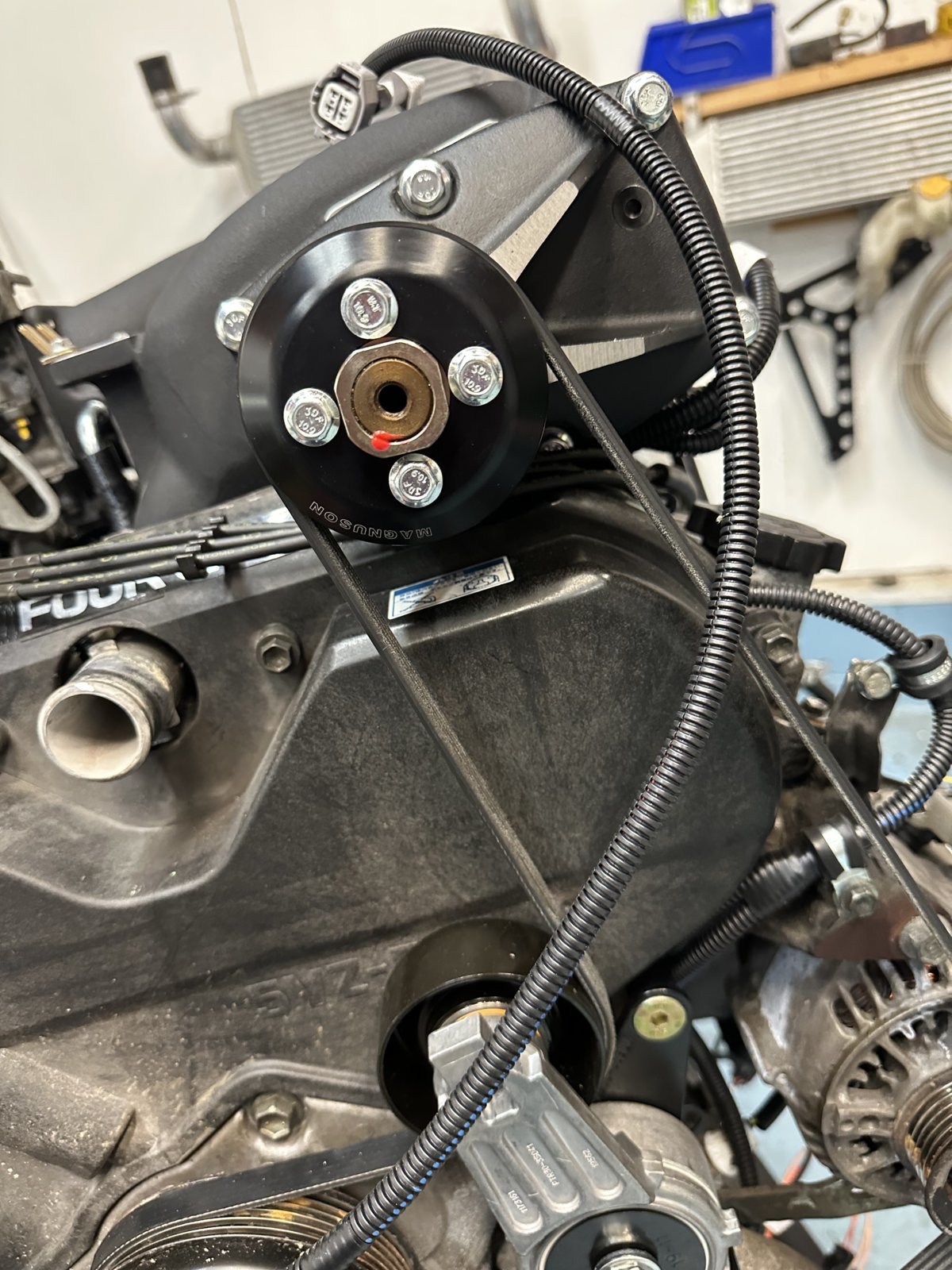

    This is the snout with the fins the 1st style that can only go to 65mm.
    The housing section is larger than the pulley hub as shown so the pulley can not slide over this section limiting it to 65mm.
    The newer snout has this section smaller
