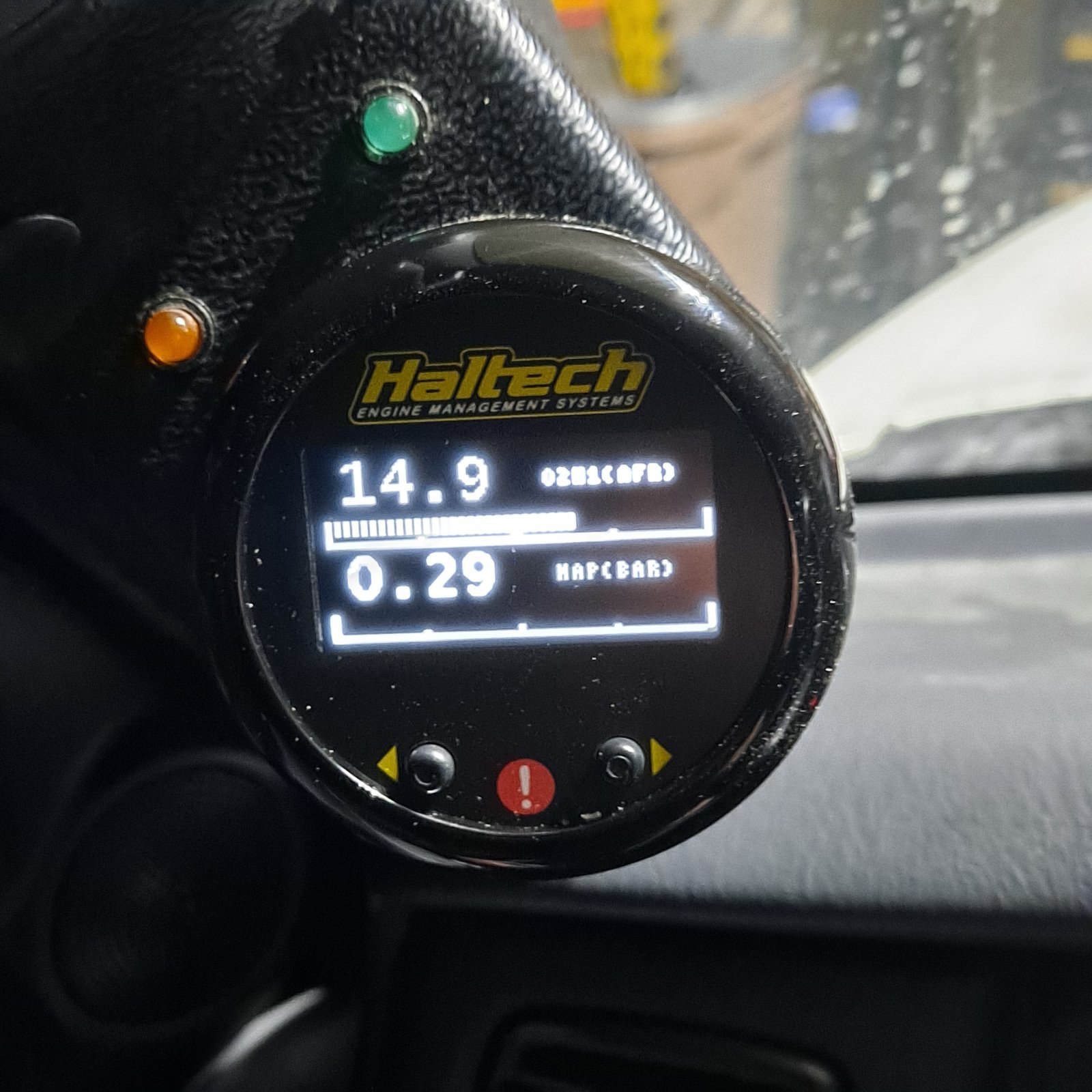

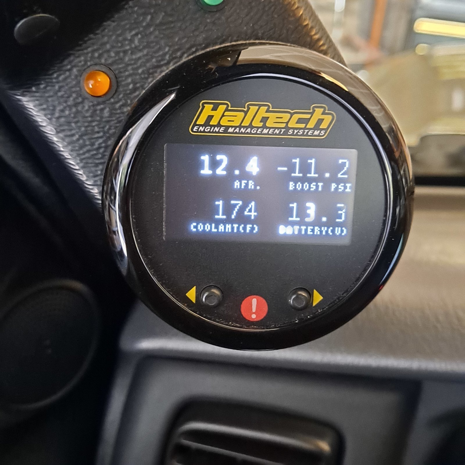

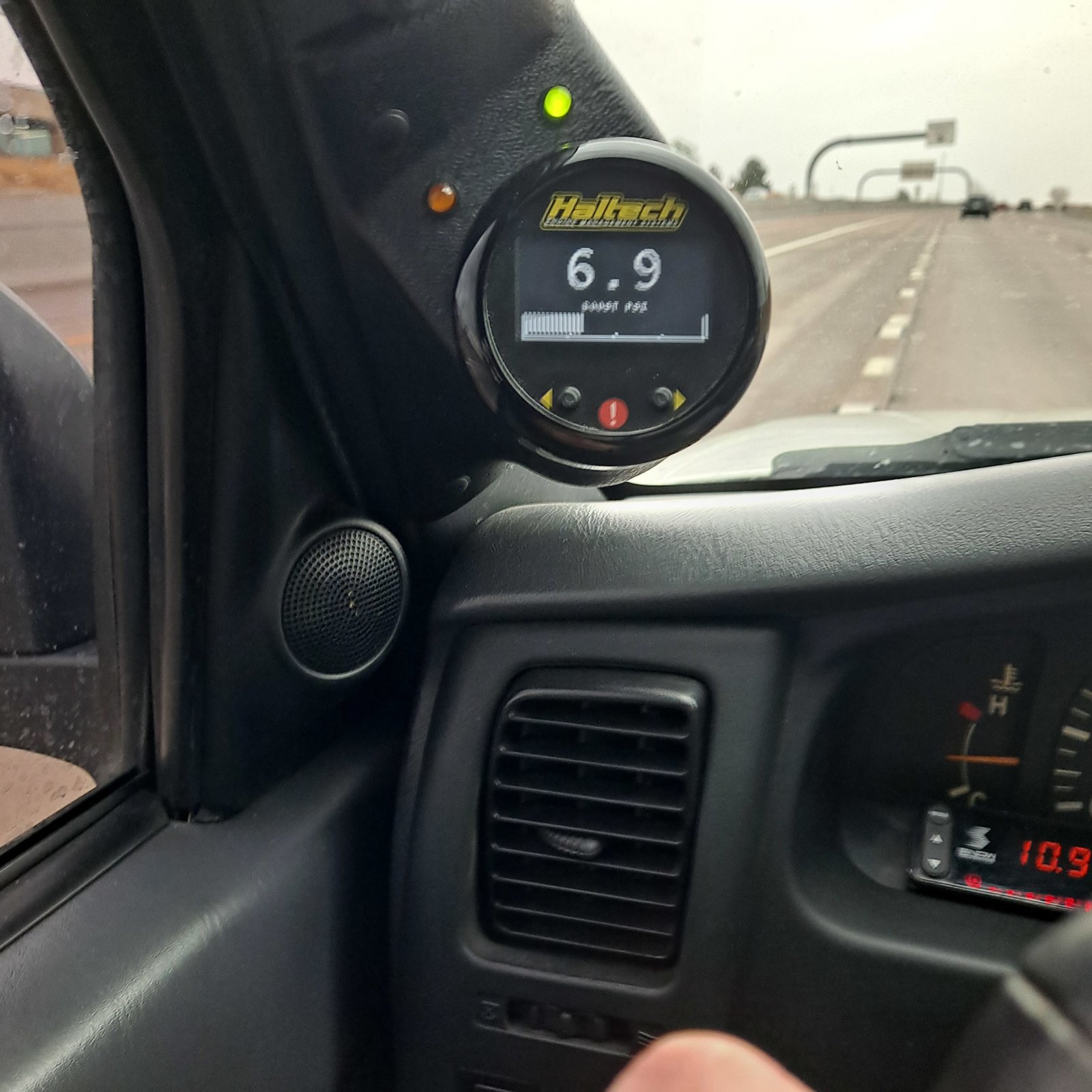

    How are you all mounting up your gauges? I've got a haltech 2" CAN gauge, I'm thinking of doing a single pillar mount under my grab handle. Is it only a universal one, or is there color match/carbon fiber options?

    1997tacomav6
    1997tacomav6 [OP] V6 5sp,RegCab,TVS1320 Supercharger,Haltech, 800k
    Oct 5, 2013
    #113940
    10,388
    John
    Denver
    97 reg cab, v6 5sp 300hp supercharged, Methonal Injection, 800,001 plus miles, Original Owner
    V6 5sp,RegCab,TVS1320 Supercharger, 56mm pulley, methanol injected Haltech ECU, AC Tvs1320 supercharger,(MUST DO) every 125,000- 150,000 needs rebuild Projector headlights HID 5 speed manual Amsoil for all drive train Smaller 56mm custom pulley, (MUST DO) 2004 DESNO fuel injectors, zero ping ping, 2004 side door mirrors Dick Cepek Rims, Michelin tires LTX, ATM Pathfinders Dynopro ATM ( that last 100,000 miles) Now running Dynopro ATM mud and snow tires KN cold air intake Cat back dual exhaust with ss exhaust tip, Raised exhaust tail pipe to 2" below body line Optima*dry cell battery,red top Alpine sirius radio, 200 watt amp, focal is165 split door pod speakers Focal door speakers Subwoffer behind seat Viper alarm, Electric Locks Dark tinted windows, bucket seats corbeau lg1 Tacoma Rubber floor mats TRD fender extenders, Bilstien shocks, King shocks JBA UCA trailer iv hitch, electric brake control, Drilled slotted brakes, High carbon steel (MUST DO) EBS green stuff 7000 series pads(MUST DO) TRD engine oil cap TRD stick shift, Marlin crawl shift kit. Rear sliding window 2002 4Runner functional hood scoop cut into Tacoma hood, 4Runner dual overhead map light Gentex Auto dim + Compass + Temp, garage,rearview mirror Snow Methonal kit stage 2 Custom 3 core aluminum radiator Linex bed liner Haltech stand alone ECU, Intake supercharger gauge. Stainless steel brake lines, Custom leather wrapped steering wheel, Haltech stand-alone ECU,
    It’s a universal size and I think black is the color and a few others maybe,, grab bar is still in place.
    two different variations depending on the year of your truck

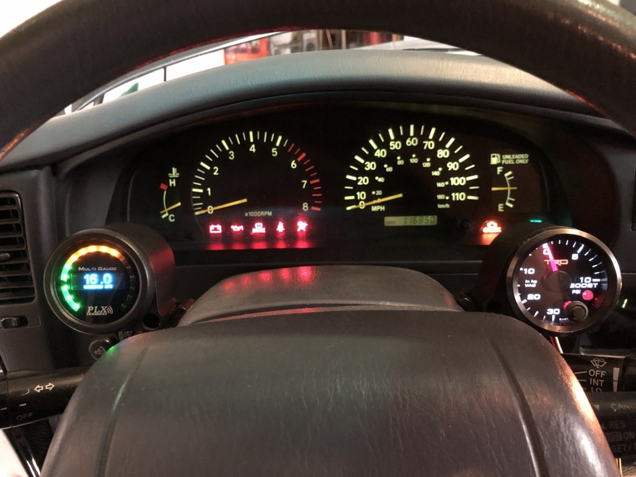

    Here are your options for pillar gauge pods that fit the 01-04 Tacoma.
    https://gaugepods.com/products/tacoma-2-pod-full-pillar-01-04
    https://www.autometer.com/2-1-16-single-pod-toyota-tacoma-01.html
    I like my grab handle, so pillar mounts are a no go for me. So I went with the one below.

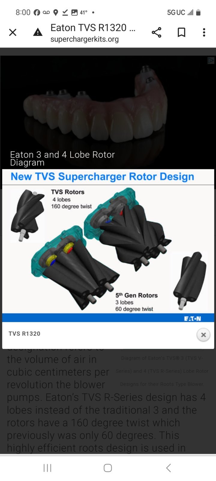

    The tvs1320 is designed to match the same output numbers of the old supercharger so that retesting every year and every vehicle Application would not have to be done for carb emissions. Also the ECU and stock fuel system is not capable of much more power without upgrades.
    1320 is a completely new design that’s much more efficient updating the 25 year old previous supercharger. It turns much slower and creates much less heat because it’s 30 percent larger and less boost needed to get to the same power.
    You’re going to see the same hp maybe a little more with the stock pulley as it turns so much slower and less heat with rebuilds probably being at greater intervals.
    You should get an FMU, high flow pump, clean injectors new fuel filter and two step cooler plugs and be good

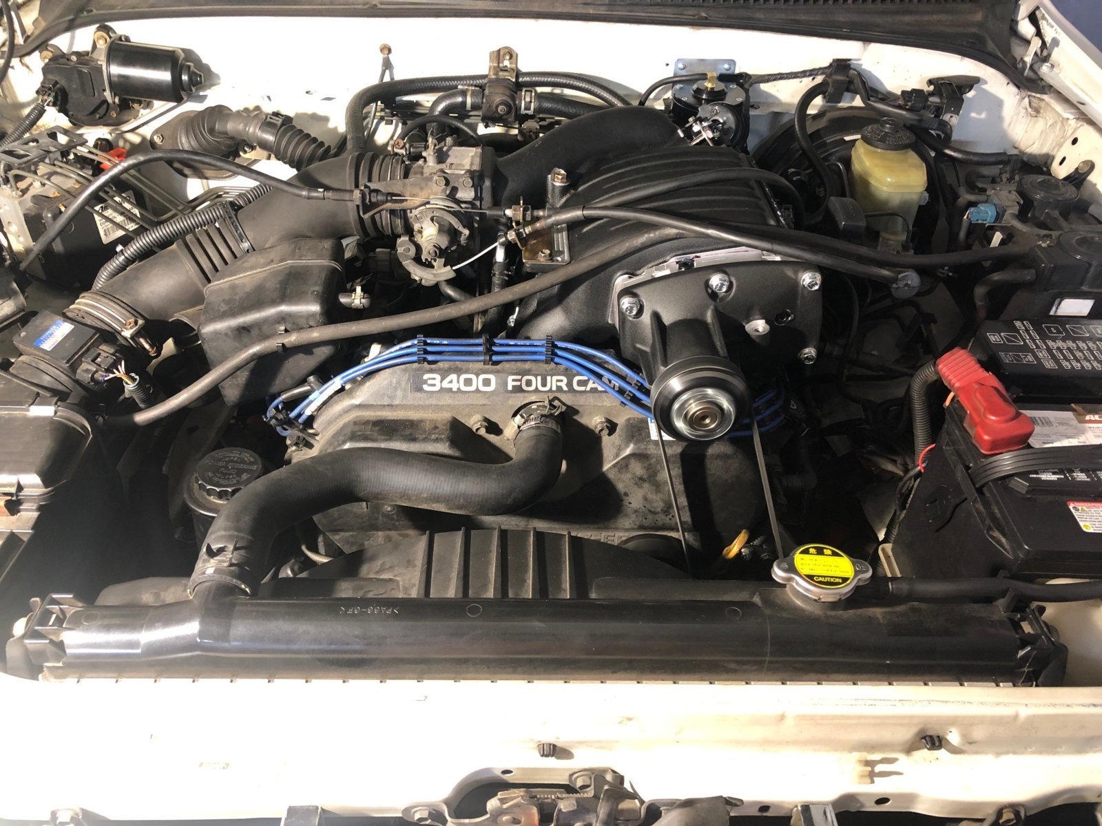

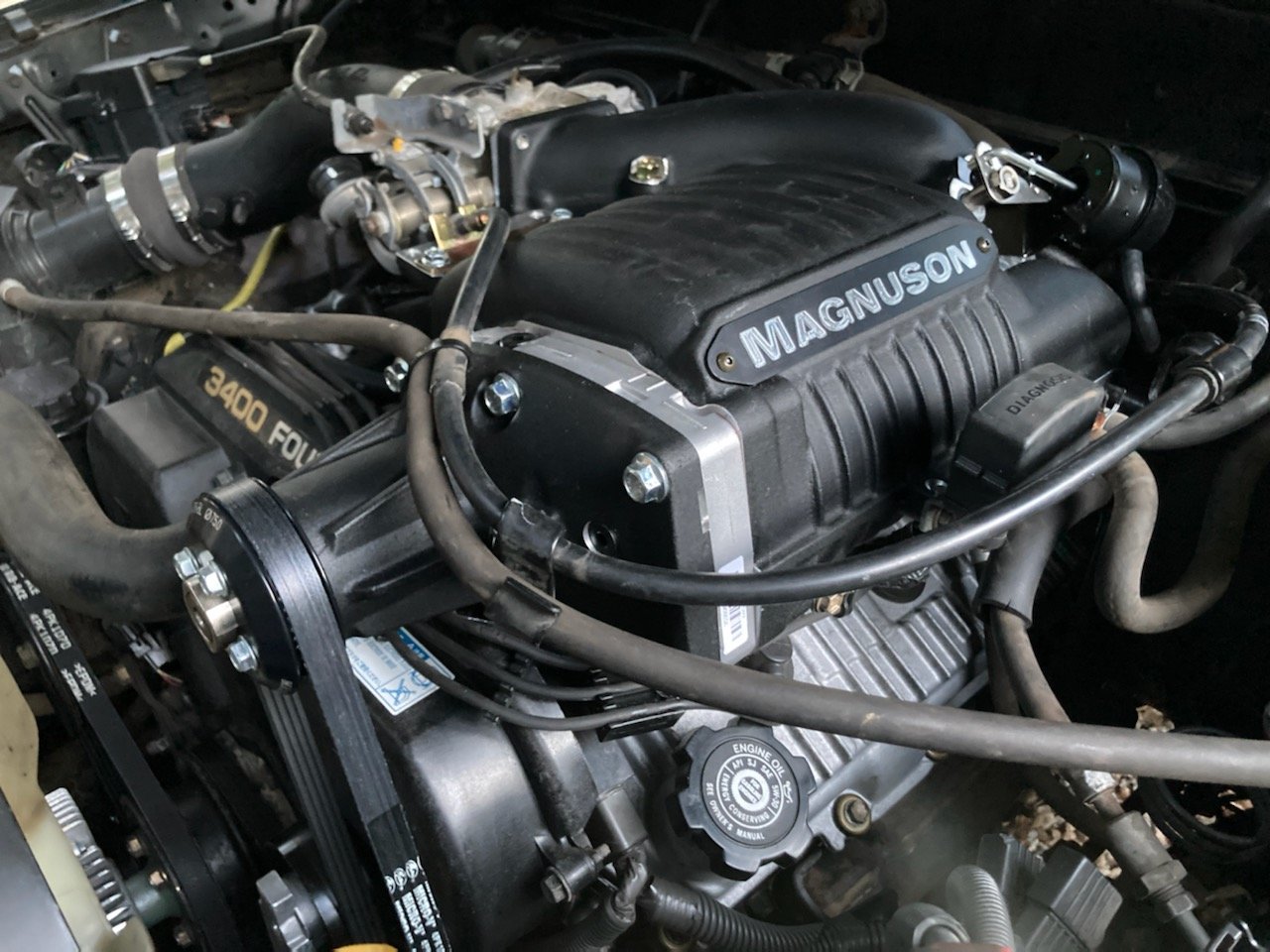

    Well, I finally found some time to install the new supercharger. I had already installed the larger fuel pump and new fuel filter. I went ahead and replaced the valve cover gaskets, fuel injectors, and spark plugs too while I was in there. All went pretty well except for a few small problems:
    * The lower threaded hole on my motor where the dynamic tensioner bolt mounts had some severe rusting/damage on the entry threads. I don't trust this bolt connection so I may need to drill out and install a 9/16-12 x 10 mm x 1.25 SS threaded insert...I'm really not crazy about doing this work but don't know a better solution.
    * The instructions weren't detailed enough to cover all my 1/8" vacuum hose connections, (especially when adding a 3:1 FMU), but I got it straighten-out with help from Gabe.
    * On my '98 w/auto, the transmission cable was almost too short to reach the throttle body connection following the 1320 installation. I had to move the cable bracket that protects it from the exhaust manifold heat to gain enough length. Magnuson didn't warn about this problem or a work-around in the instructions.
    * On me, but I failed to install the IAC one way valve, so I've got to go back and take care of this.
    * My FMU unit was spraying fuel on start-up at the bottom center port - easy fix as the fitting just needed to be tightened a little more. It was scary for a moment though as all I could think about was where in the hell did I put the fire extinguisher!
    Overall, I'm very pleased so far. I plan for a test drive soon.

    Like you I had the 1st gen supercharger with haltech 1.9 pulley and ported and ran fantastic BUT the 1320 is 1320cc per revolution and the old one is 980cc per revolution =30 percent larger, 4 lobes instead of 3 lobes, 160 degree twist compared to 60 degree twist, bearing rated at 20k instead of 15k. It's better in every way.
    Turbo is the best but no true plug and play good setups available. Supercharger is an afternoon job.
    You will gain 40-50hp TQ depending on your elevation and mods. Snpspeed.com can do a special order for the 56mm pulley and shave the snout I believe.
    If you're selling the older supercharger its not that big of a cost.
    3 year warranty and all new technology over a 20 year old design that's much more efficient
