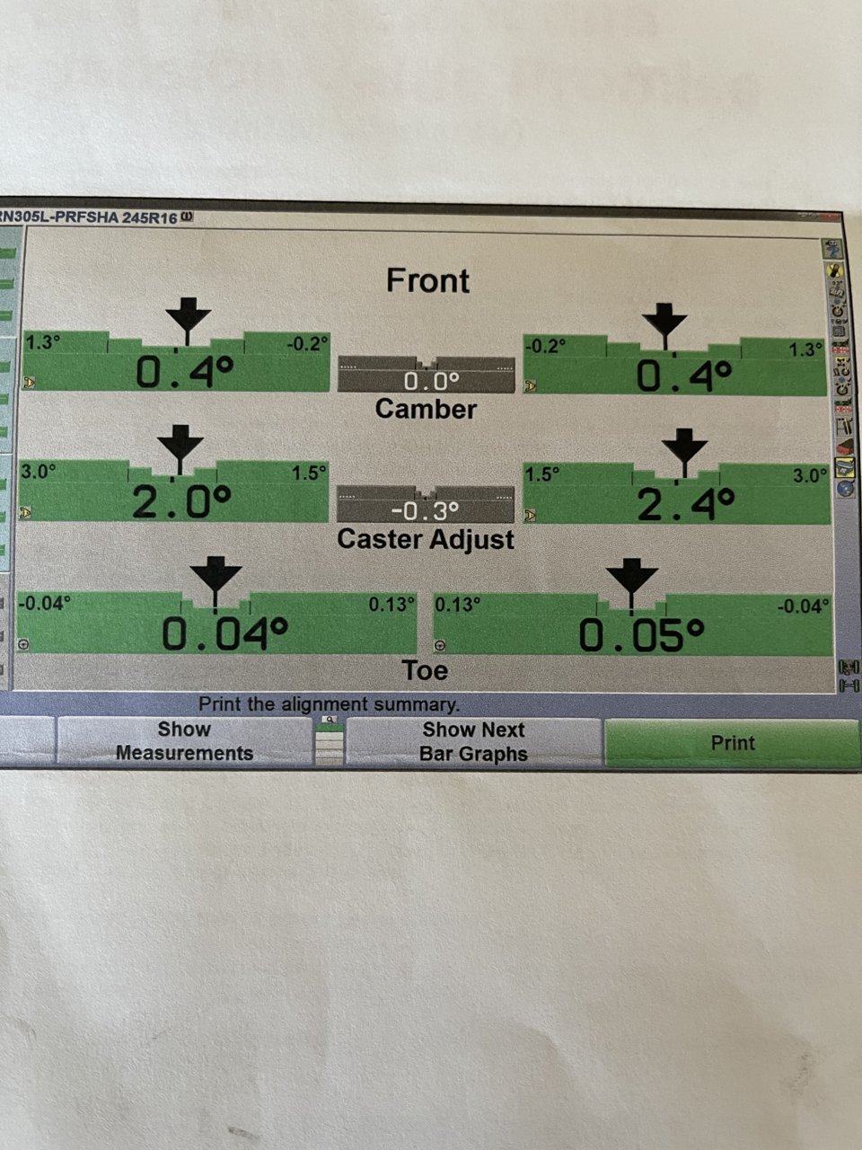

    Here is the spec sheet from the most recent alignment.

    Get the numbers to match right and left at that 2.4 or close to it, same with toe.

    Need more camber.
    If equal you may have some drift on a well crowned road, so a 'little' variation for that won't hurt, but you can get a lot more out of the OE UCAs.
    Ballasting (weight of the driver) is something for autocross or road course vehicles. And they can't 'guess', you have to weight the seat to make the suspension move as if loaded. Plus it's camber and toe that you car about in those performance situations, thus the ballast.
    The only time to use a big box shop for alignments is if you are confident in some manner that the tech doing the work 1) knows what he is doing 2) cares enough to to it right 3) and the shop has their equipment calibrated on a regular basis.
    Of course those items are true in a smaller shop too. But the odd are higher you'll find them there.
    There is nothing magic about a 4x4 shop doing alignments on Tacoma's, as they have simple suspensions.
    Find a shop that does sports cars for enthusiasts, or your local auto-x crowd uses and give them a try.
    Side note. So many want to be 'level' and even side to side, etc etc. Yet when a performance car is corner weighted while adjusting ride hts etc you may wind up with 4 different measurements. So the set up matters more than the look.
