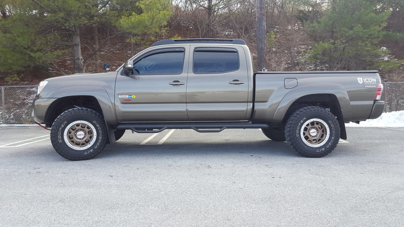

    Covered in stickers and chrome stick-ons for extra horse torques and foot powers. Icon sticker gets me tons of travel, dozens of milimeters.
    3" lift with stock upper control arms sucks all of your down travel up. Replacing the upper control arm to a uniball like a light racing, total chaos, Icon tube/billet, etc. gives you "an extra inch" of down travel which helps keep that 3" high ride a bit smoother.
