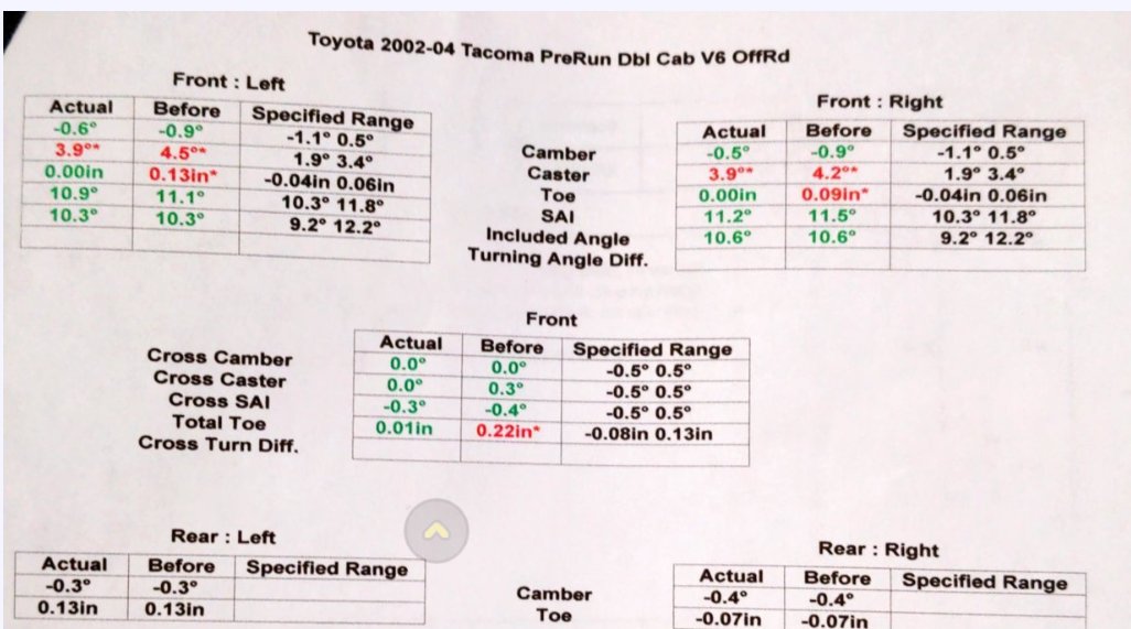

    Post up your latest printout. Lets see those numbers!
    Sometimes, that is exactly what is called for - find a new shop. :thumbsup:

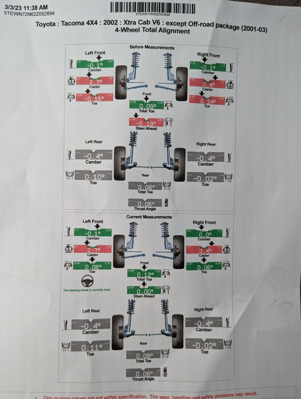

    Derp, yeah, I guess that's important useful info.
    Here is the spec sheet from the new shop. It still pulls to the right just barely but that's probably mostly because around here all the roads are crowned really bad. If I drive on the left side, it pulls equally to the left. Maybe having even more caster on both sides would help with that.
    Now that I'm looking at this new sheet, how did the first shop get it done so badly? It's not even close to being in spec.

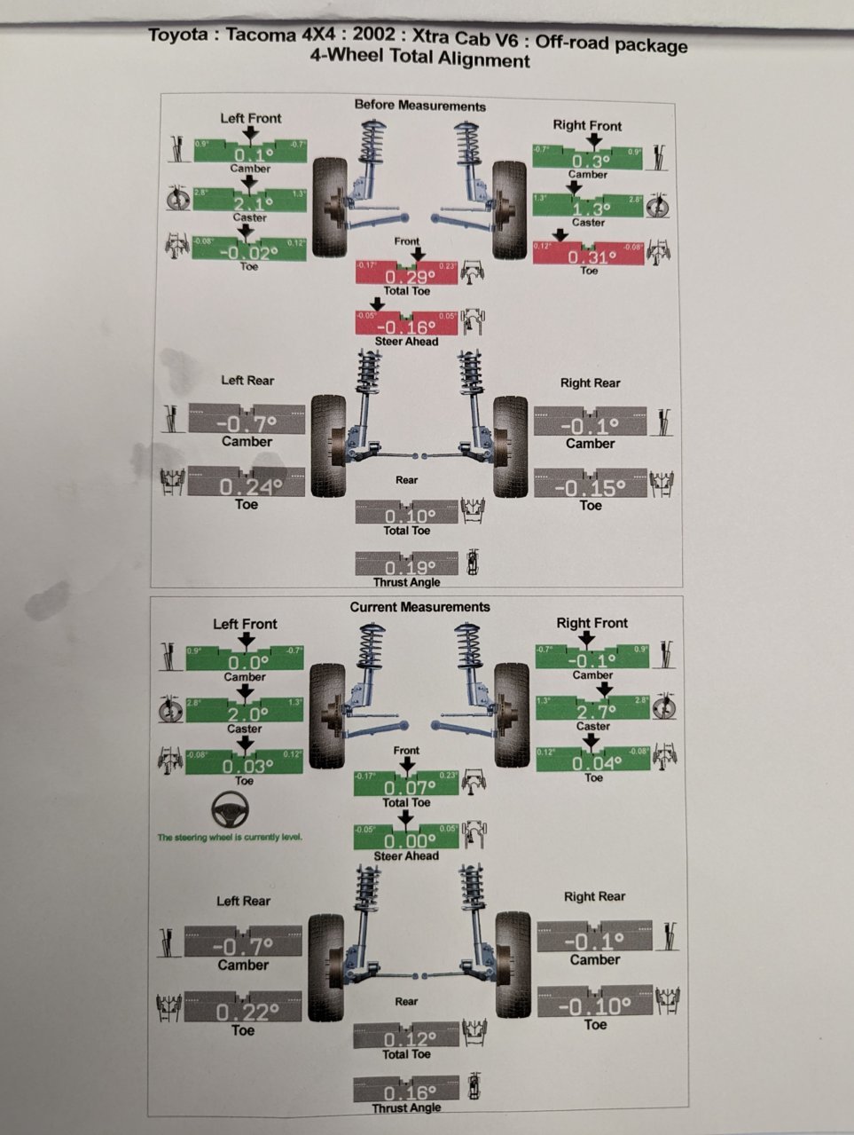

    Did you ask them to keep your caster in that range? I have no experience with JBA UCAs, do the JBAs limit the amount of caster? With the SPCs you had +1 degree of caster built into the UCAs and of course adjustable even further.
    881s, SPCs at default setting and 255/85/16s here - This is where I'm at. Stable AF and solid tracking - no drift.
    Bottom line, glad you worked it out and finally have it where you want to be. :thumbsup:

    Yeah, no I get that. I'm just wondering why they couldn't get your caster up higher.
    Prior to my most recent alignment, I had it at 4.5 | 4.5. When I went back in after the 4WD conversion, because I didn't mark my upper ball joints, it was off. My alignment tech was able to get to 3.9 | 3.9. We'll see where it sits once the 882s go on with the winch.

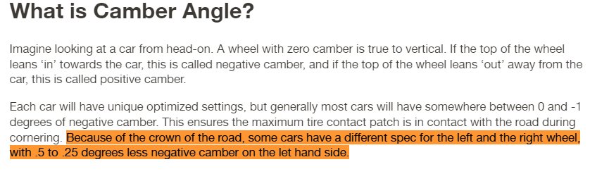

    A good alignment tech (seems so hard to find these days) should be inspecting everything and test driving as well. They should've picked up on the steering wheel not being centered and corrected it.
    Damn man, I so hope this resolves your problem. I don't blame you one bit for the frustration or the bourbon lol.
    Going to throw this out there since there will always be someone who comes across alignment threads and wonders what role caster and the rest of the numbers play -
    What is Caster?
    https://autoquarterly.com/wheel-alignment-what-is-caster/
    What is Camber?
    https://autoquarterly.com/what-is-camber/
    Toe-In and Toe-Out, and Shake It All About
    https://autoquarterly.com/all-about-wheel-alignment/

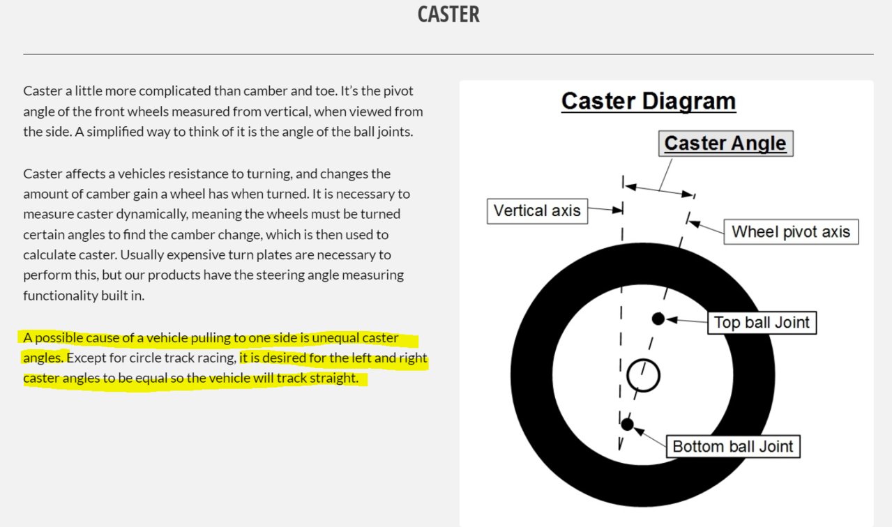

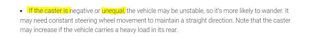

    Where they have you with caster, it's still bugging me (mentioned in my earlier posts).
    Caster should be as close as possible to the same on both sides. If not, its going to pull/tend to want to track to the lesser side.
    If it starts pulling again, maybe have them re-work your caster closer to the same. If they start talking about road crown, ask them to work the camber.
    Not trying to put a damper on your good feeling after picking up the truck. Just wanted to point out the uneven caster IN CASE you run into it pulling again. You've been banging your head against the wall enough with this thing. Hoping it is fine but if its not, look at the difference in caster.

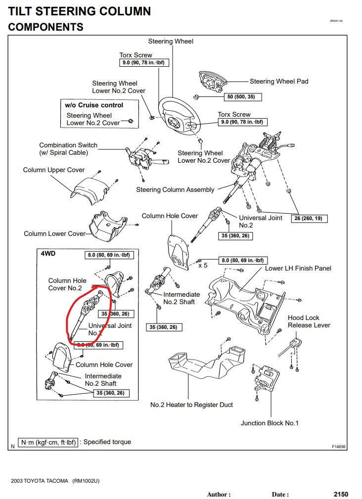

    New update. Just heard back from the third shop. They think the play is coming from the Steering Shaft Universal Joint #2. They spent an entire day checking everything. They disconnected the steering shaft from the rack until this was the only joint connected to the steering wheel (not counting the tilt). They said this is absolutely where the play is coming from. From my experience this is exactly what is causing the strange steering feeling. I'm gonna order this part and dig into it this weekend. I'll try to update back when I get it fixed.

    If you're not in a rush, $176 @ partsouq.
    https://partsouq.com/en/search/all?q=4521060121
    EDIT: My bad, wrong part. That is the upper portion. Not #2.
    #2 should be -
    https://partsouq.com/en/search/all?q=4586034020
    There is also -
    https://www.toyotapartsdeal.com/oem/toyota~yoke~sub~assy~steering~sliding~45290-35040.html
