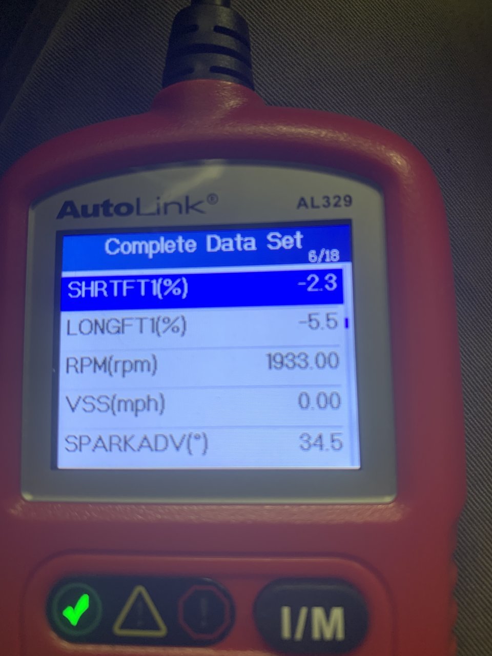

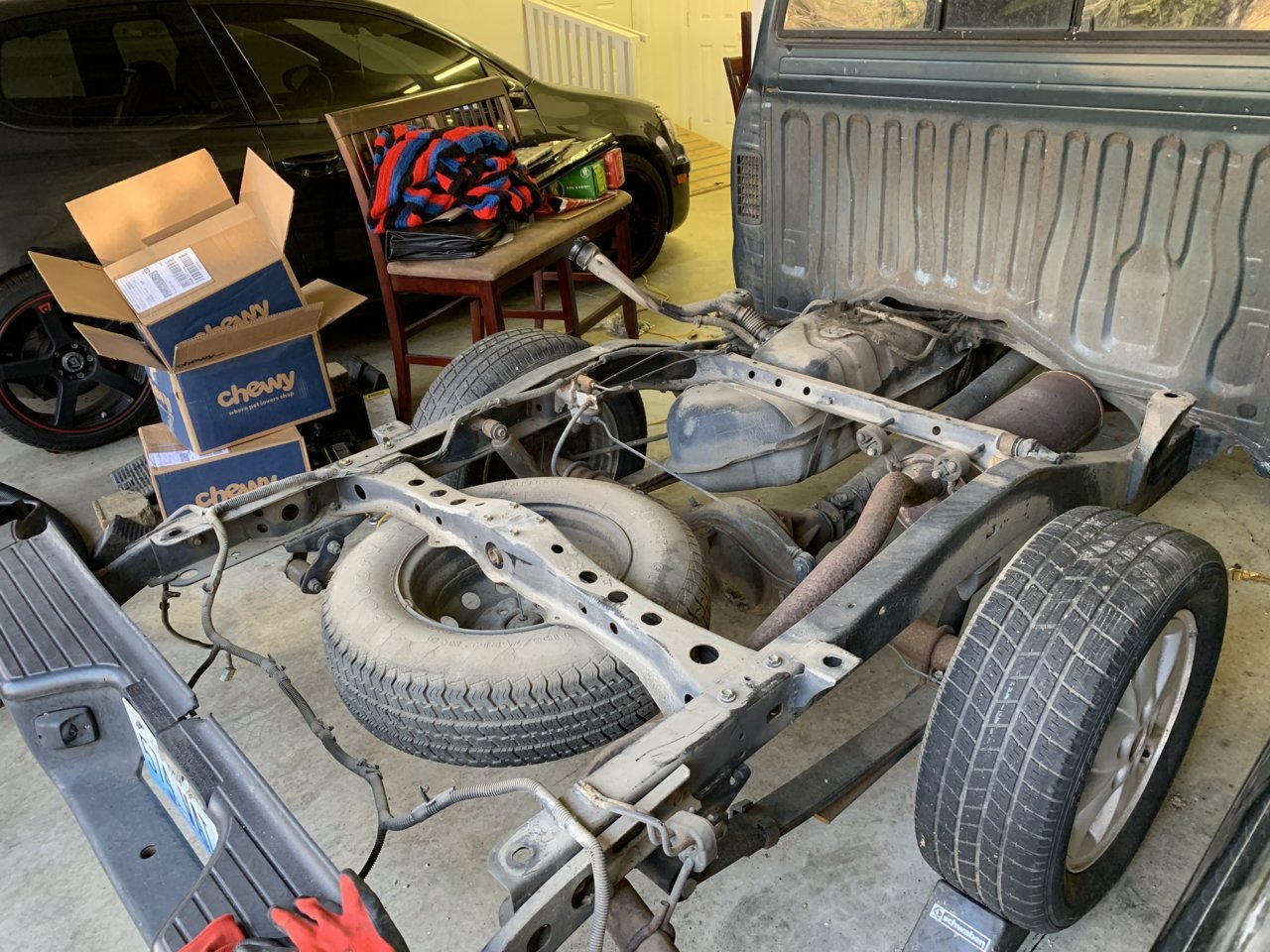

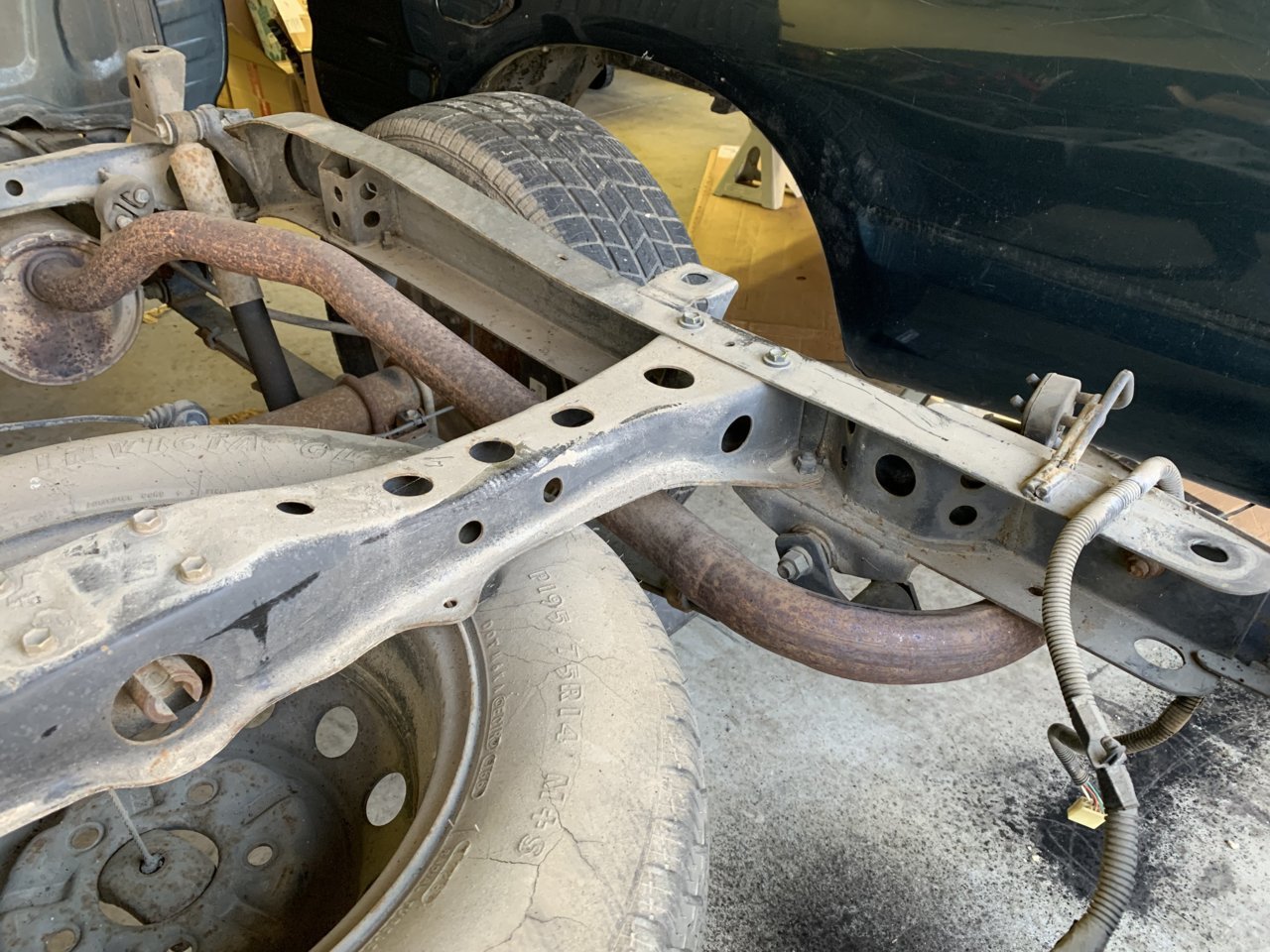

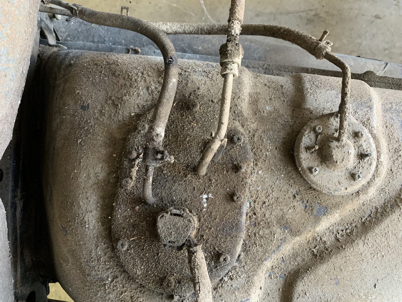

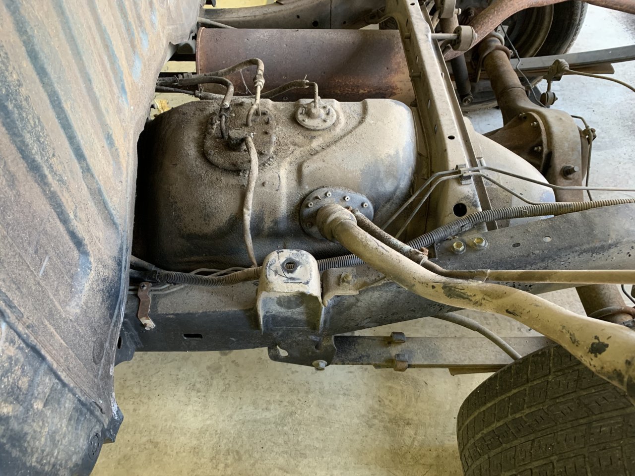

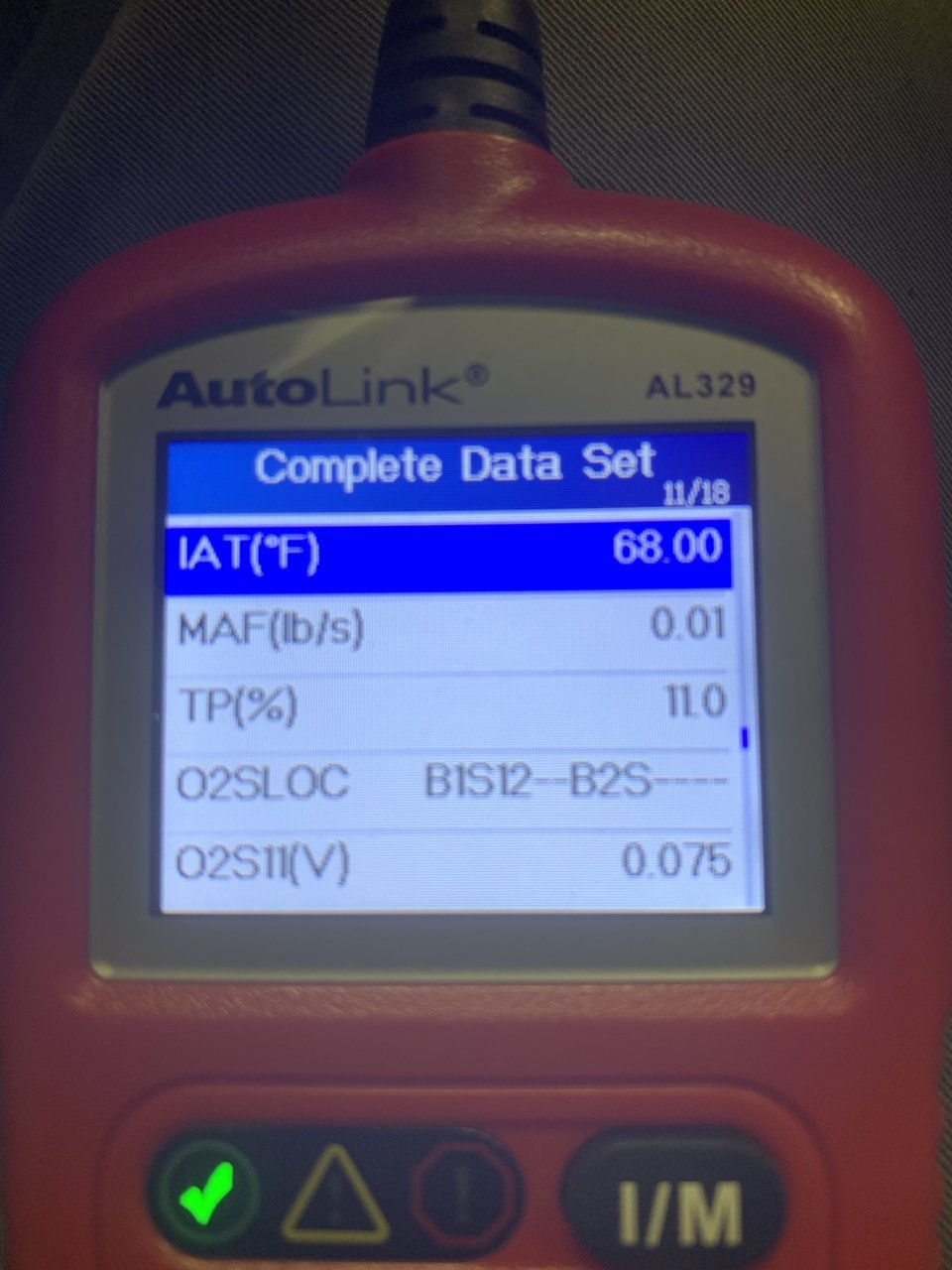

    Well I've made some decent progress and recent discoveries I'll go over just to keep things updated. First off, I got all my new parts installed, fuel pump(which was actually the entire assembly with the pump/sending unit/strainer), fuel filter, EGR valve, EGR solenoid, and MAF sensor. Got everything put back together after spending a few days cleaning all the intake/exhaust ports and intake manifold etc. No noticeable change in the hesitation or stuttering while on the throttle :eek:.
    Today I met a guy here locally in my area that is known as the Tacoma guy! He is an awesome guy and says he's built like 400 different Toyotas over the years, so he's got quite the collection of old parts. He was nice enough to let me borrow some old parts he had lying around to try swapping them out and see if that would fix my problem. He let me borrow a ECM, distributor, and MAF sensor. Currently I have only tested the MAF and that had no affect. He needed me to take a picture of my ECM so he could check his cache and see if he had the right part. While I was in there digging out the ECM I thought...I've got this can of electronic cleaner, let me spray off these connectors to the ECM and see what happens.
    So I did just that and resprayed my OBD2 port and let them dry out a while, then attempted to reconnect my scanner and see what happens. Well wouldn't you know it! My scanner connected, but still said there was no codes found! I then attempted to go into the live data and start the truck so I could post the live data results for you all, and before I could even get it started...the scanner lost connection :annoyed:. This has me wondering now if there isn't some sort of electrical issue I'm missing? Anyway just thought I'd update those interested and see if y'all had any other thoughts or suggestions. I'm starting to lean towards the ignition coil/distributor, but my distributor looks shiny brand new.

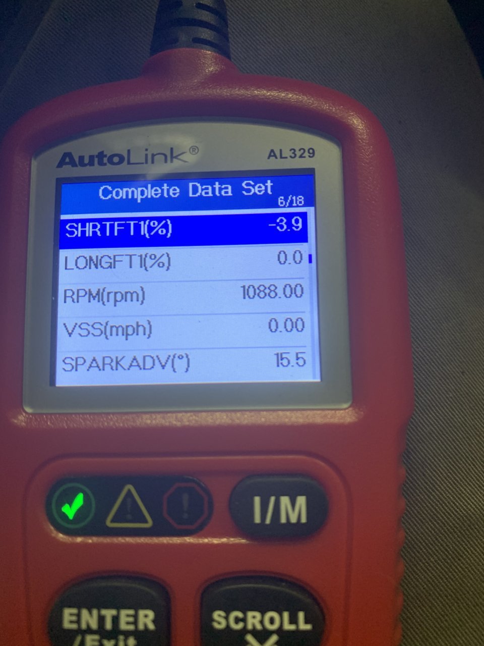

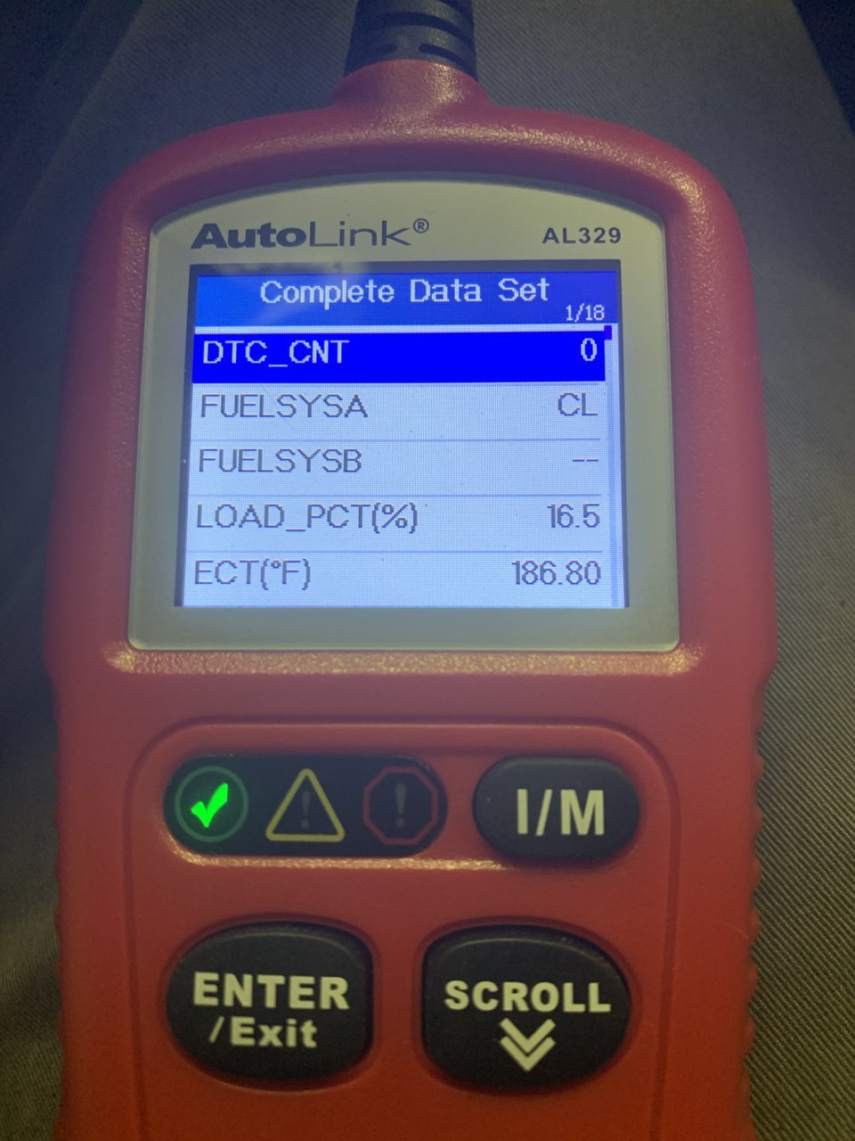

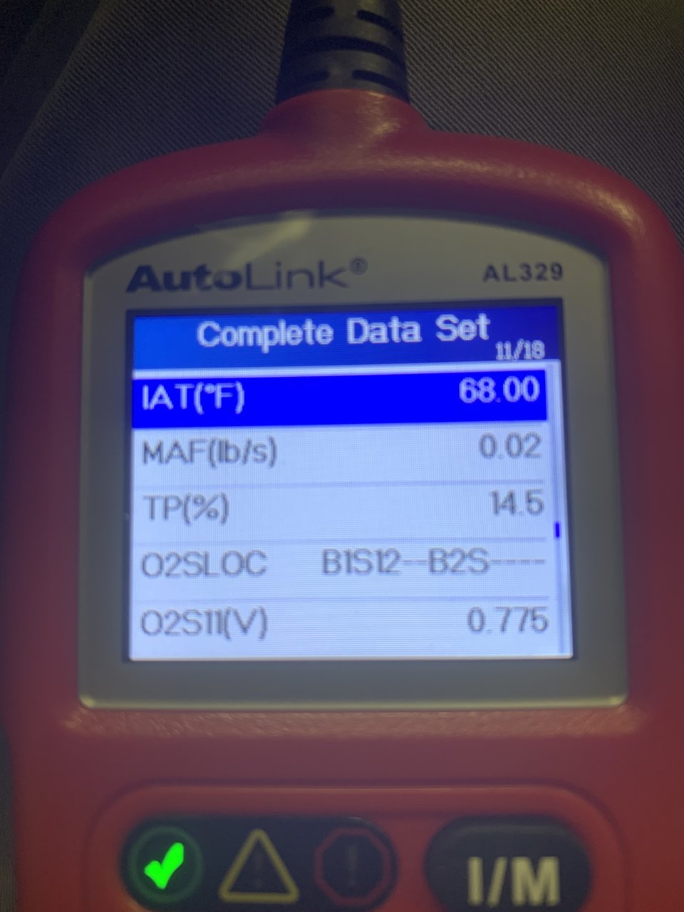

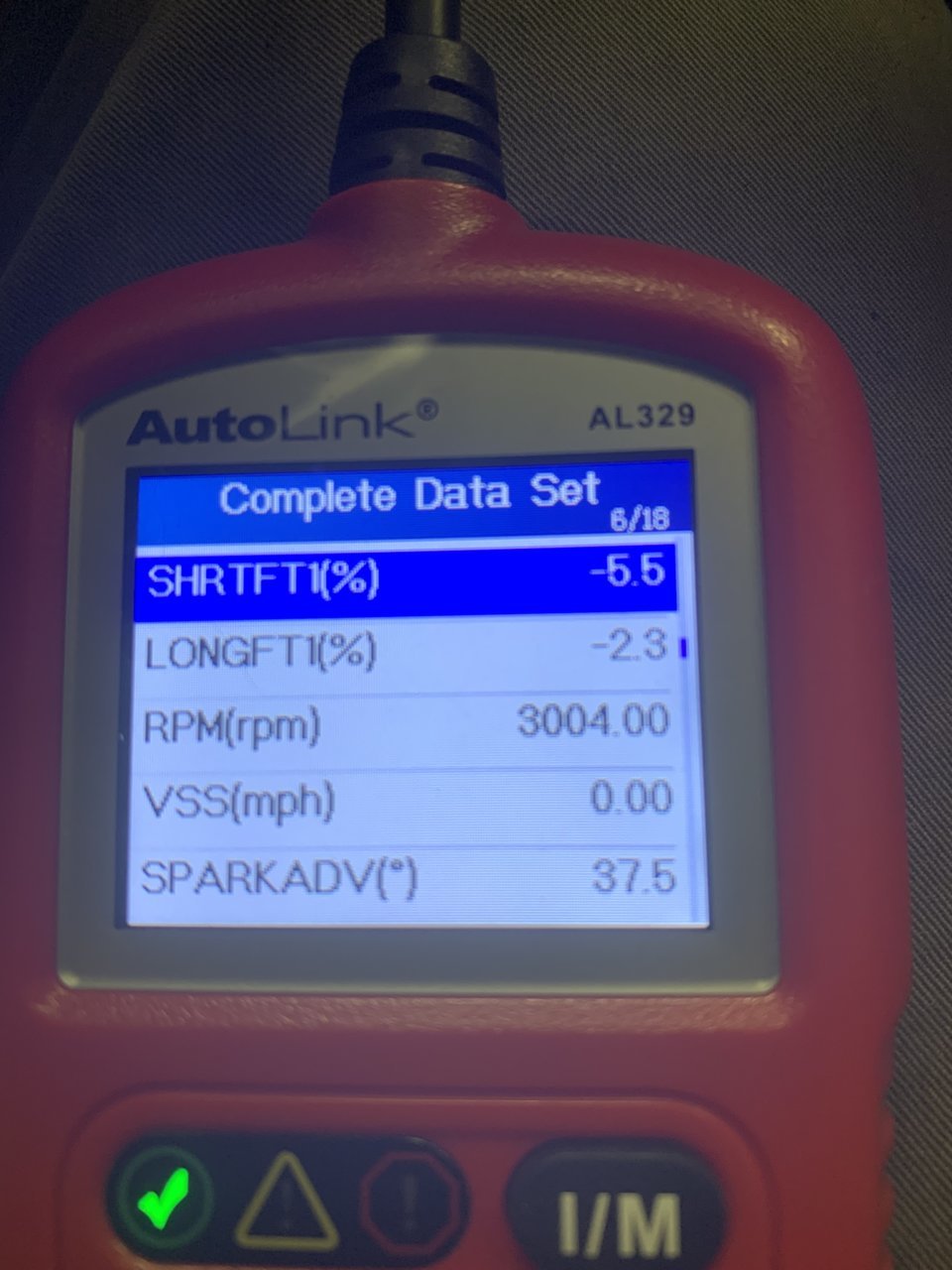

    FINALLY! Just got done swapping out my ECM for the one I got from Tacoma guy! Everything seems to be running great! No more check engine light and my OBD2 port is working again. So I went ahead and got some pics of the live data just so you can analyze it and tell me if everything seems ok.

    Wow that's awesome brother! The no check engine light was tell tale but new ecm was worse case. Glad you got it figured out!
    The numbers look good to me except for maybe that MAF but it's possible the scan tool is rounding up or the vehicle needs to warm up more. Hate it when obd scanners use lbs/sec (or lbs/min) instead of gms/sec.
    After she warms up what's the idle look like?

    It was up to normal operating temp when I took the live data. I may be able to change the units on the scanner to metric, not sure if that will read out in gms/sec like you said but I'll give it a shot! I'm so happy I've finally got this little Taco running right again. Thanks to everyone how gave advice and suggestions along the way, its much appreciated!

    For a MAF system they say gms/sec readings should mostly be close to the size of the engine in liters +/- and at operating temp at idle. Converted you'd expect 0.0053 lbs/sec. But the scan tool may not be expecting that many decimals for that PID so it might be rounding up to .01 as you're seeing. As long as your fuel trims stay good I wouldn't worry about it.

    Just changed the units to metric and the MAF was reading around 4.5 g/s. I will definitely be taking the ECM apart to see what I can see. Might even try to repair it or have it refurbished to have a back up on hand.
    Also noticed while I was just checking live data that my idle seems to be a little above normal, around 1k or so. I never really noticed it because there is no tachometer on my dash. If that's all I have to worry about now though is a little high idle, I'm good! :bananadance:

    So if I'm interpreting what you're saying correctly and my MAF is reading 4.5 g/s at idle, then it's getting to much air and running the A/F ratio lean? Any cause for concern with this?

    The MAF procedure I mentioned isn't full proof. In fact in my experience the initial numbers (even after warm up) will be double the litre size of the engine and only after a long idling time of about 15 minutes will it go down to within .5 gm/sec +/- the engine displacement *on an optimal running vehicle*. You also want to make sure AC is off. At least it's not unmetered air - the MAF is detecting it - so your high rpm could be due to a slightly worn throttle body or something else. I would do a search here for elevated RPM as there's lots of info that you might find useful.
