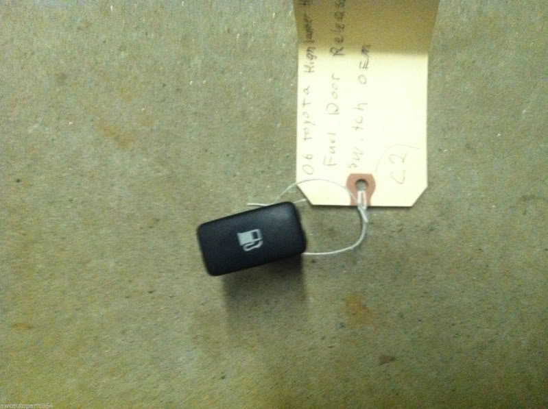

    Even with a hookup at the dealership the switch 46 bucks. If anyone wants to buy a new one retail is 76
  10. Feb 28, 2014 at 12:44 PM
    #70
    adio
    adio Well-Known Member
    Sep 11, 2008
    #9165
    2,637
    HI
    2015 INFERNO TRD PRO
    eBay would be your best bet.
    #70
  11. Feb 28, 2014 at 12:57 PM
    #71
    csjumper2003
    csjumper2003 Jumper's Leds Vendor
    Apr 8, 2011
    #54596
    5,399
    Savannah, GA
    2014 SSM Trd Off Road 4x4 Auto
    They had one but was for a 00-05 and looked smaller.
    Im gonna try and hit some junk yards when it drys out a little

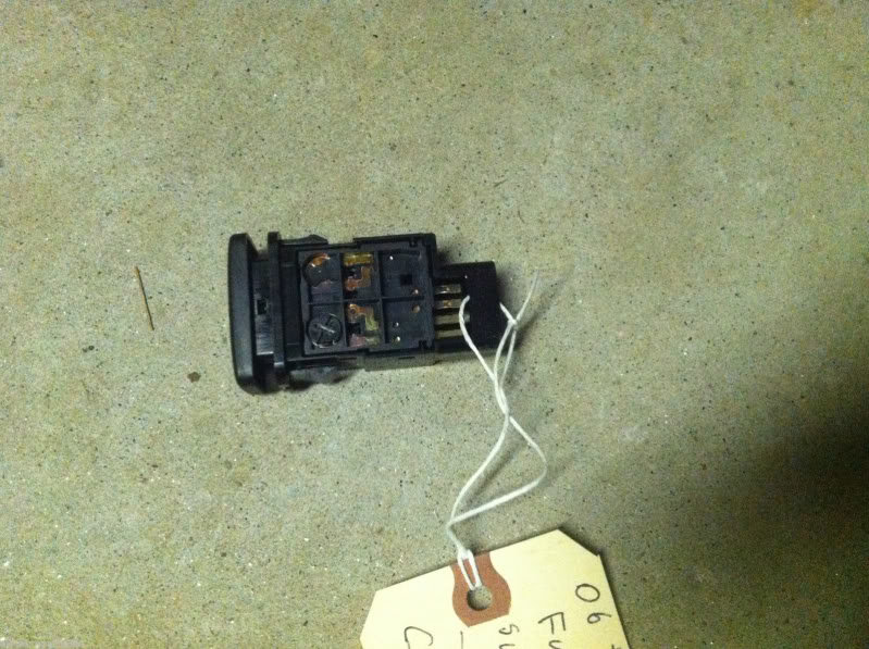

    Off topic, but I did manage to fit this from a Sienna into one of my blanks. Looks like the same design and shape.

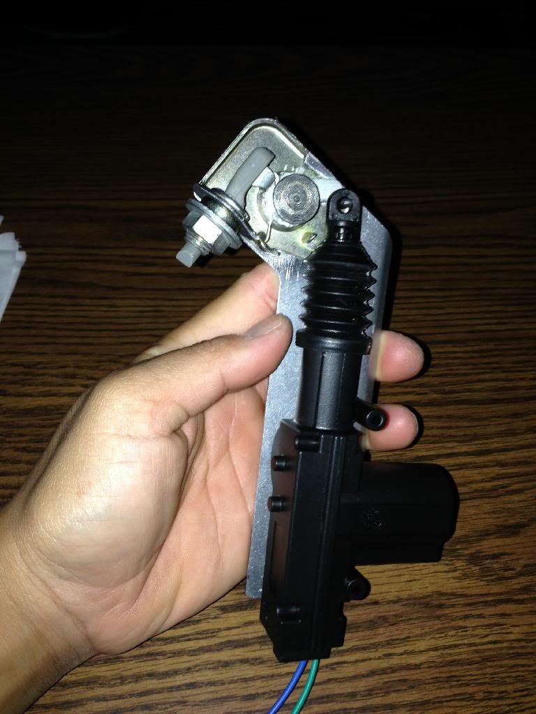

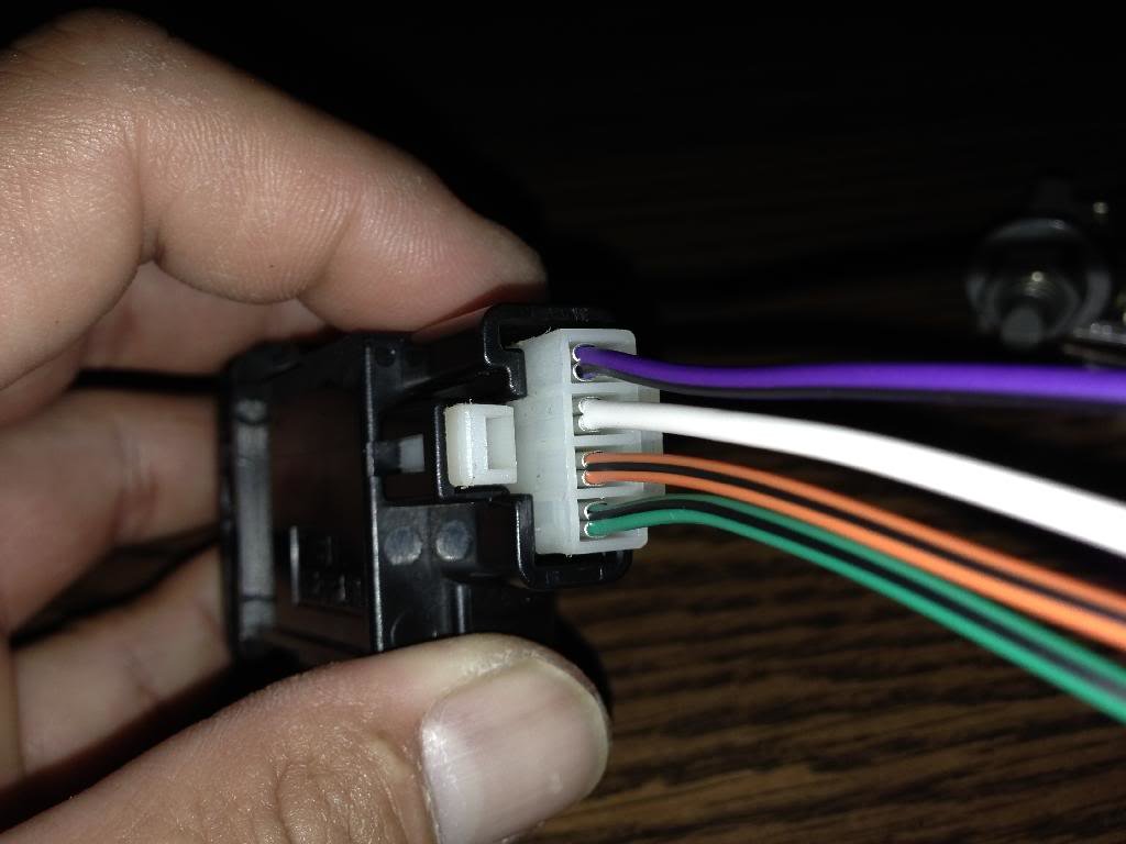

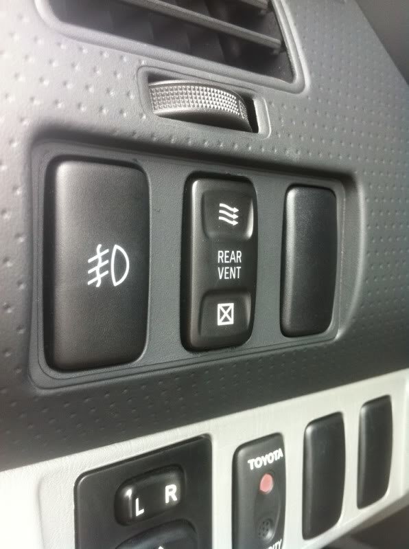

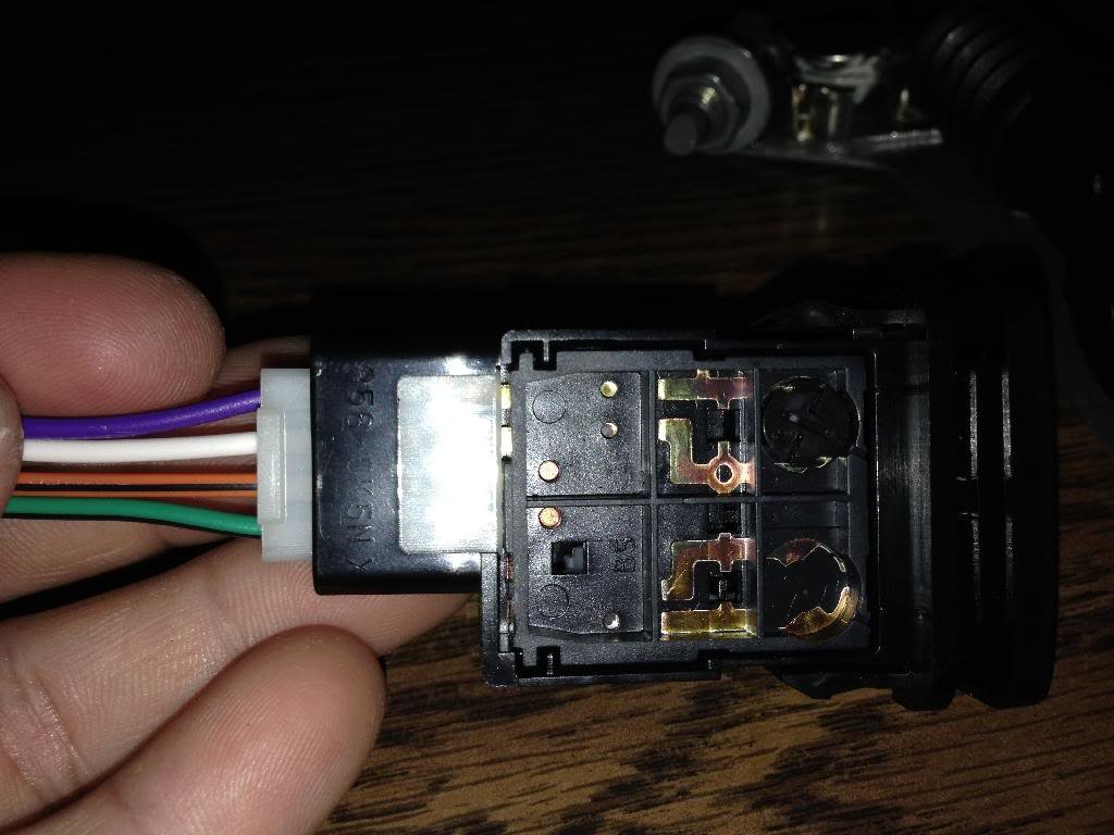

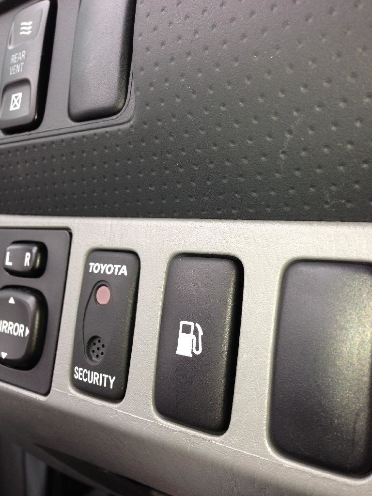

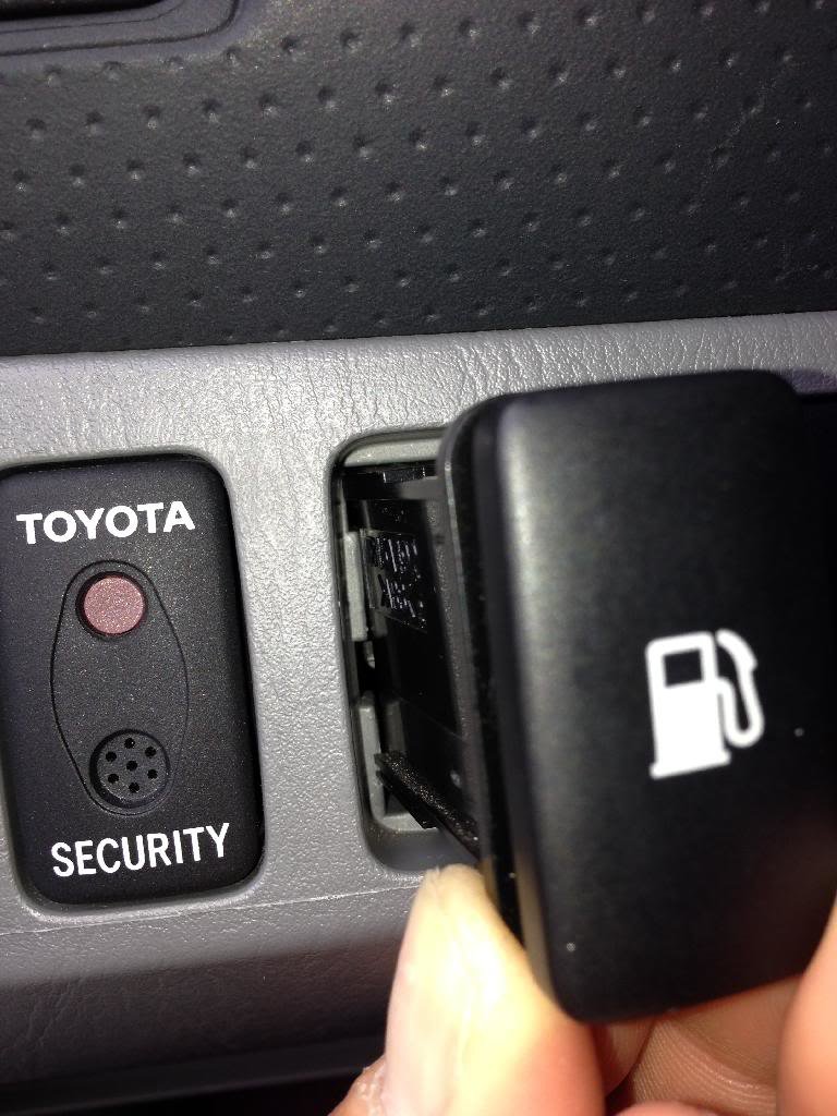

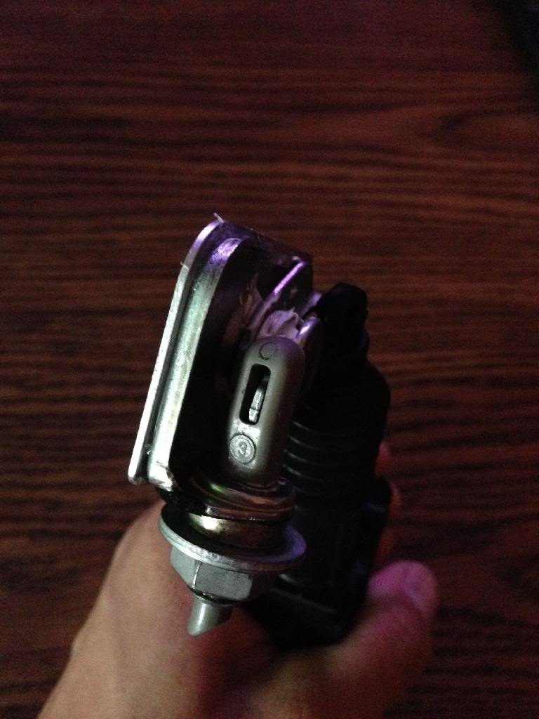

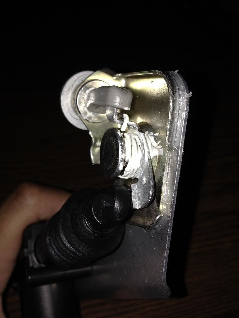

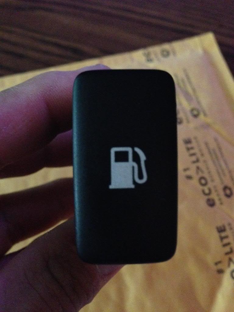

    Got the kit today, and also the Higlander fuel door release switch that I bought from eBay. Didn't install it yet because I'm still waiting on one part. Got a little excited so I did some pre-prep before I get to install it.
    Kit is simple. Nothing fancy. Wire loom, butt connectors, latch, zip ties and the actuator.
    FB42DFE7-061D-411D-BFFE-458D9E27EE68_zps_1400b7c3478b65e1e8cb56cba721a0436c11eb7f.jpg
    Actuator.
    13D16530-468B-4BCF-8676-748C63DC9616_zps_1f408dd6f663369db0db3584803b36ce057e7bc6.jpg
    Greased up all moving parts with white lithium grease.
    CEC3E615-2B2B-4886-B8EE-0802AAD2140A_zps_8bcf4f2a8728a0da95145e2f65bcc2db833f3620.jpg
    CD71435C-A785-4F97-9D8E-BEDFF75CD0CC_zps_69d513fb56f8f43f401ecc91c07a552dc37be2da.jpg

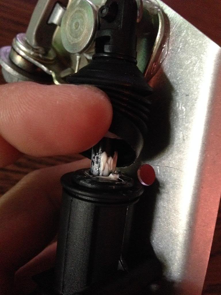

    Even the actuator cylinder.
    00EEC15B-0E3E-45C3-B3D5-94B704B5E7C2_zps_9722ec83a50a4196232836ee74e8af0ad0d0c375.jpg

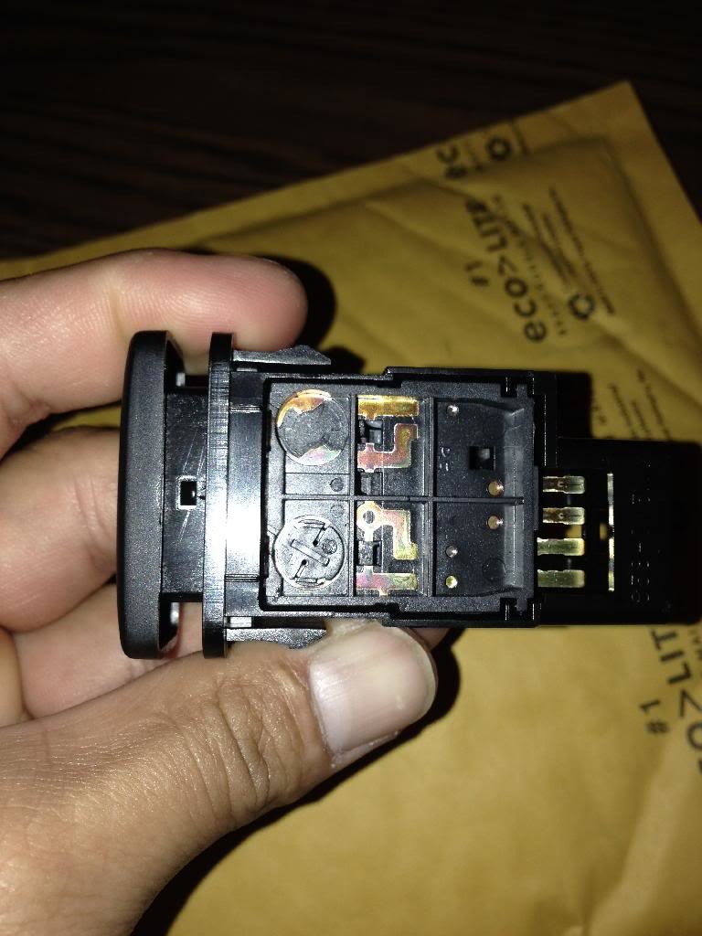

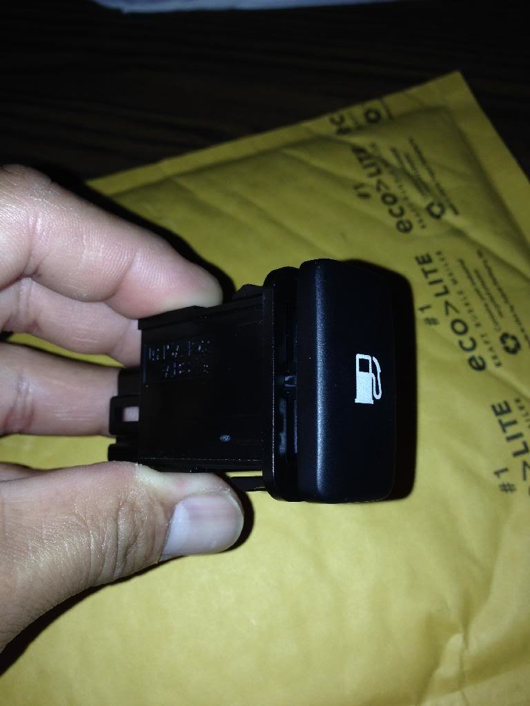

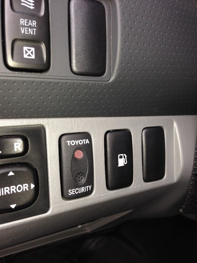

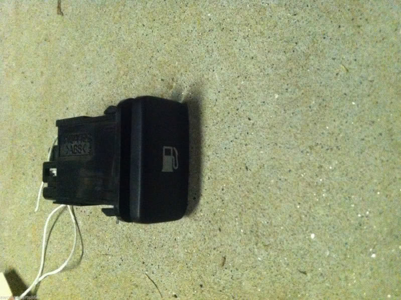

    Went a different route with the switch as I like to keep it as OEM and stock as possible. Went with a Highlander fuel/gas door release switch. I can confirm that this switch fits 100% on the blank slots on the left of the steering wheel with just one modification to the switch, see below.
    E0769D2E-85B7-4292-B129-DF16299B0ABB_zps_6108df84fb5fdaa40b9db78f4bc8d5dc879a6948.jpg
    5677E861-536B-4642-ABF4-09897C95E93B_zps_4e6cd54a3246595c18686187764288444543d224.jpg
    3A7FF8AF-AB2E-479D-B3D4-90075C38FAE1_zps_55ae6ecb4ab2716ef4589bdc379e22c7ea9a1b19.jpg

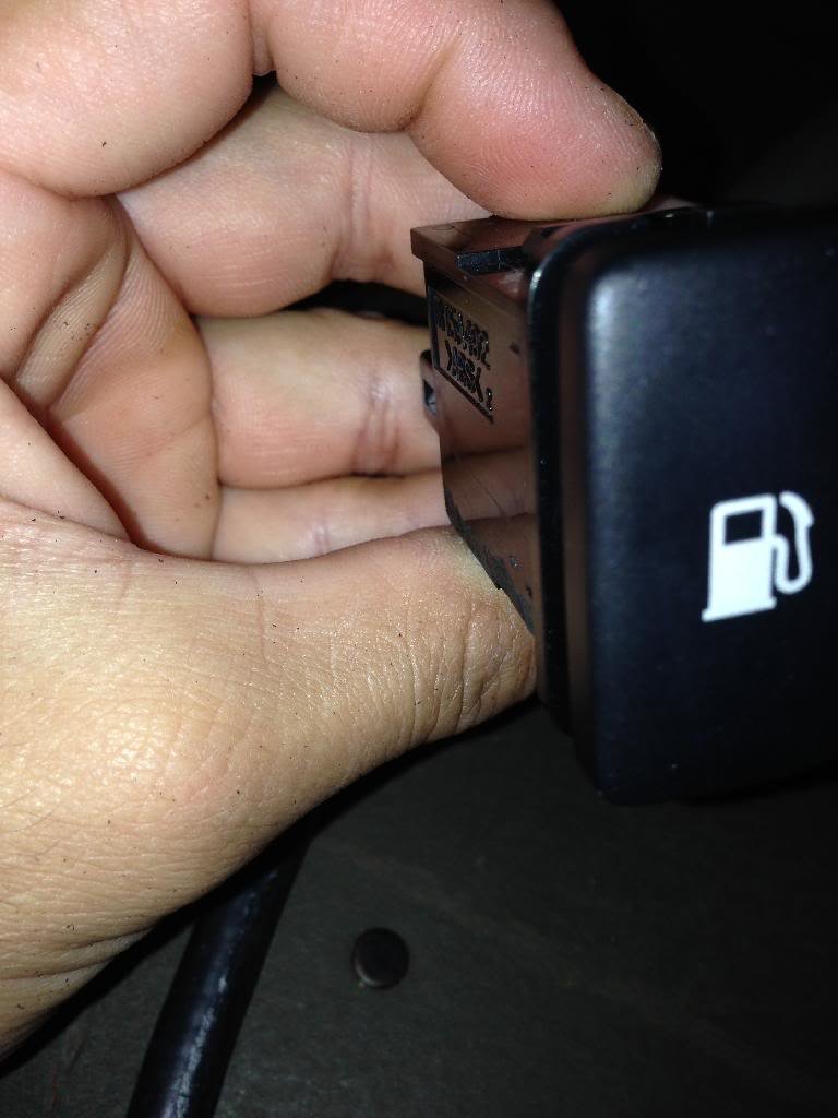

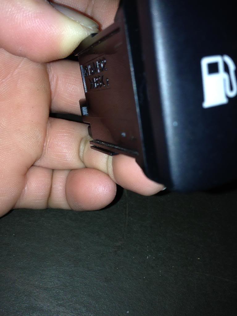

    Switch will slide in easily if the bottom left of the slot was notched up. You can see that the lip from the switch would hit that bottom left part of the slot.
    DDE5323F-CA86-44E8-A802-6AC41479A6C1_zps_a9149010af33baacc6348b163bac06ccc9bb96c6.jpg
    That bottom part must be sanded down.
    882D4002-54ED-4D34-B27C-78538B8132F2_zps_b4e0404b982bcd8ead7f1d92b1cab5afc643867a.jpg
    Nothing a Dremel and sanding drum can't do.
    B8B7AD95-63A2-46B3-B096-2E1BD1F0FB36_zps_ef74466bfb168dbd5182d1e920cc47f5354bba33.jpg
    And Bam!! perfect fit. A switch that never been seen in a Tacoma before haha
    AC9F0D2F-BCED-4A3D-B8FB-FB85ACE0DC18_zps_2a20c144d021a578ffb6aae709fdb2a0b7433eb0.jpg
    4712AF08-1474-4C4D-A74C-D92B3385B6CE_zps_06c70f44b88e27ba764b8f07dea23f3d3f599e98.jpg

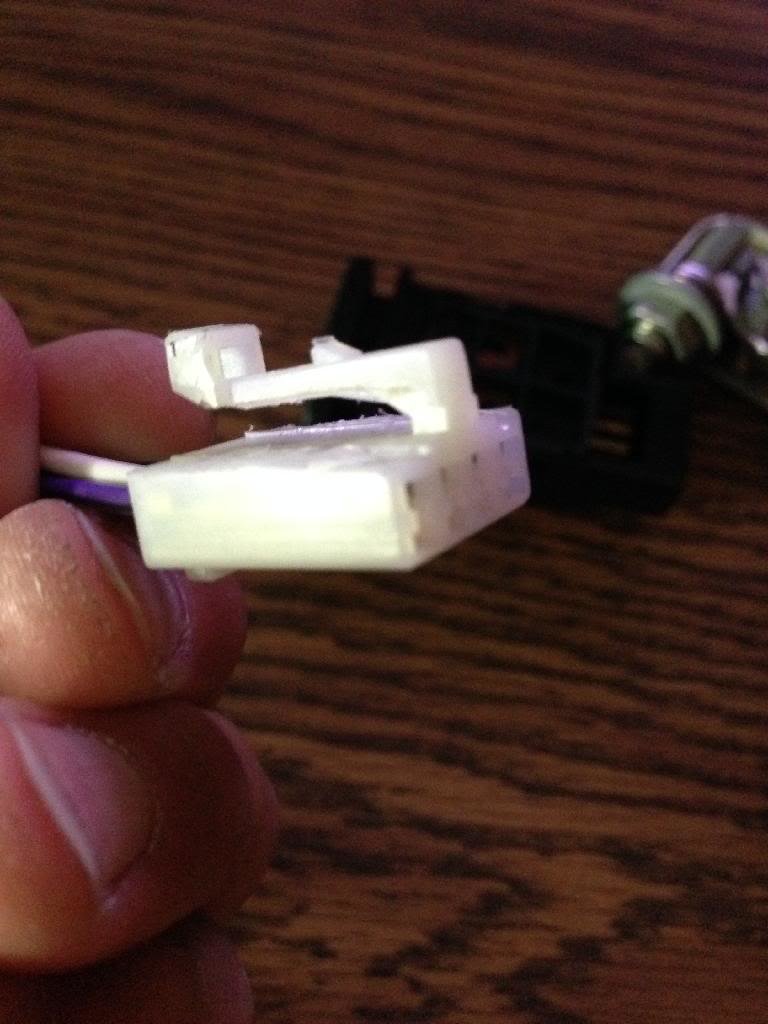

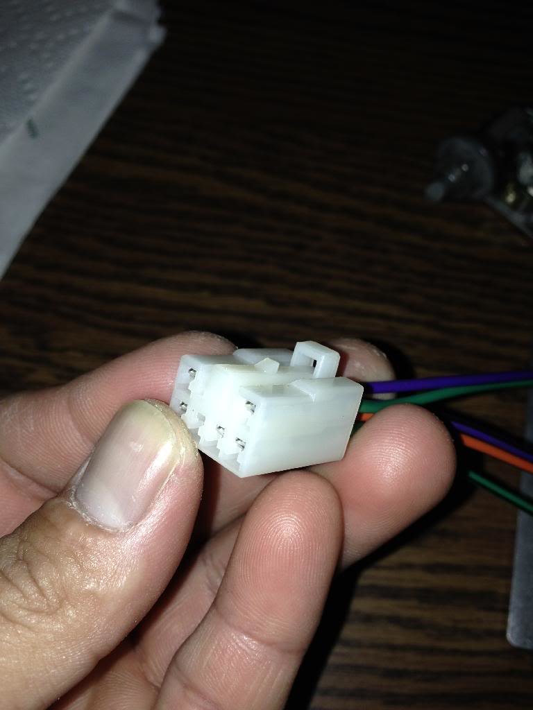

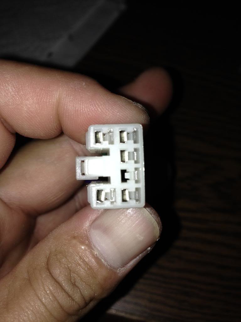

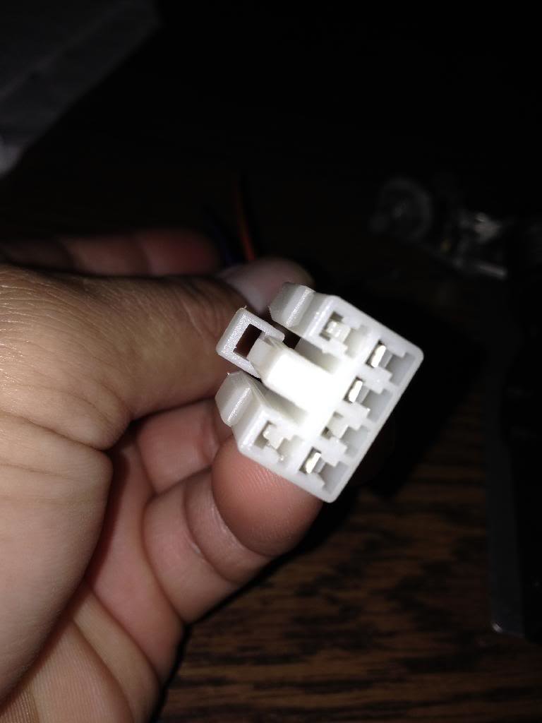

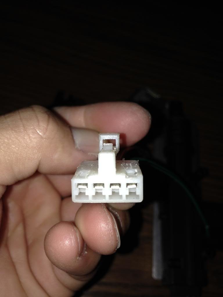

    The switch didn't come with a plug. So I had this laying around. I think it's for wiring up aftermarket radios. Modified it.
    8D7B3DA9-572F-43B8-B0AD-33350573FFB3_zps_be94b38bb8485f2963d65954adf1ac57d70e6aa3.jpg
    DD2467B7-34D5-4FEC-8D05-35FFBE6C6018_zps_49656c73ffe20e73a9ca1c287346d67e107c9744.jpg
    Cut off the left and right side part of that locking tab with a Dremel cutting disk.
    BA58228E-454E-4D81-B0E4-3B8746E85D7E_zps_5eef1a35e370ac5c1be722c9dfa98e1600dab822.jpg
    DC7E9A7D-AE05-4293-B4F7-35B7041A5D8F_zps_298e7686b58184c97cc071f0d4b1a48a93da8e47.jpg
    FC0A18A0-94CB-4710-BBE9-CEF7C3D268EB_zps_f4e4a075422d502b5fca7bea690322ee621d8074.jpg
    Bam!! Perfect fit. Home Made plug.
    0FC9A979-7B80-4B6A-B28C-1C4CB2E4928D_zps_2cb1b1410d16811908368a67ddff273b5db22dfa.jpg
    CBD451BD-7059-461D-8FC0-6E531BAA9D98_zps_edfa1427a977e9b7e8735bed5512cbbc6a190a78.jpg

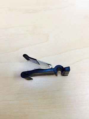

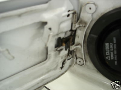

    (This is the one part that I'm waiting on till i get to install it). Went another route instead of using a spring to push the fuel/gas door out like what the OP used. This is a fuel/gas door spring/clip(not really sure what the technical name for it is). I'm not 100% quite sure if it'll work for the Tacoma gas door. But I won't know that till I get this part.
    Got this from eBay. It's for another Toyota vehicle.
    d4c267ff8ec6ab84a8d8e371a1b9a889_zps8c32_49f42bbeb2f21e75c6b93a66a27a48b79f87f254.jpg
    b9b54c2b68d3b02339141e6ce3b59180_zps4f40_b91723c373ebcb198d5a280c386056e85071e547.jpg
    It's supposed to be installed like this if it was made for that specific vehicles.
    9f4610a74224ebec5a6015cd421a3e1b_zps0606_4b06aa535c86da85719e39e0d02360bfe7c4af18.jpg

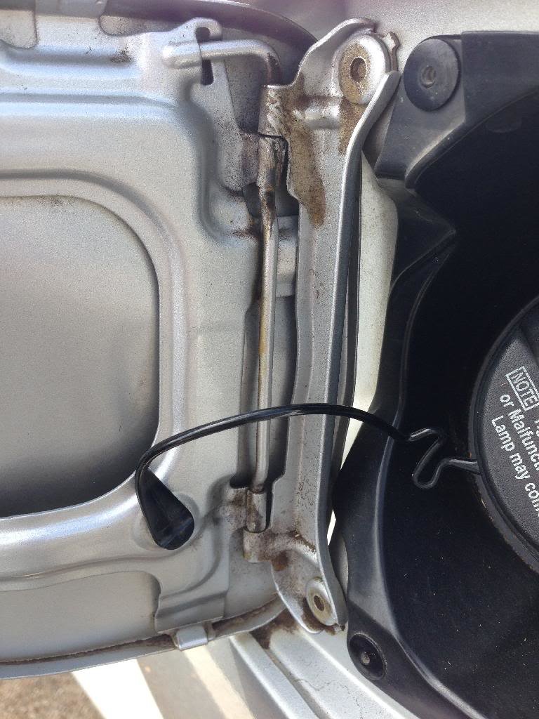

    This is how our Tacoma fuel/gas door looks like. Looks like it might work, but I won't know that till I get it.
    C0C68CD3-EEF5-49E6-938F-622D63F59EFF_zps_485e74e095c1b9216cd4f0cf4845a17f198ba6c6.jpg
    Sorry for the overkill on pics haha. But it does make it easier to illustrate for this mod. I'll keep you guys updated ones I get it installed.

    Good find on the button. It looks like a great fit in the blank space. I'm interested in the door spring. Kinda looks like a small version of my attemp with the bent banding strap I tried. Hope that work so I can switch to that to clean up the look and make it a little more OEMish.
