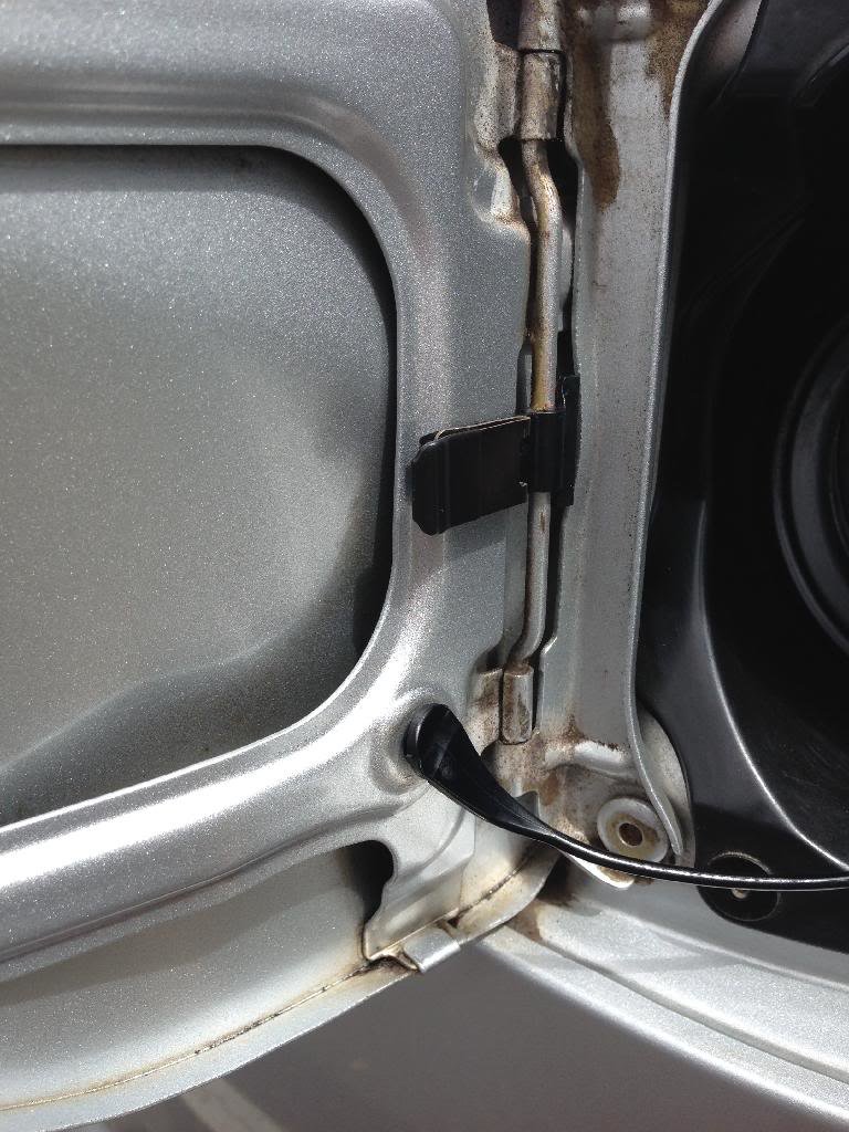

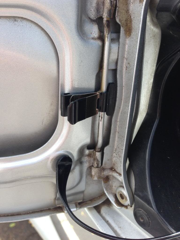

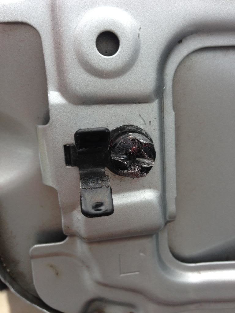

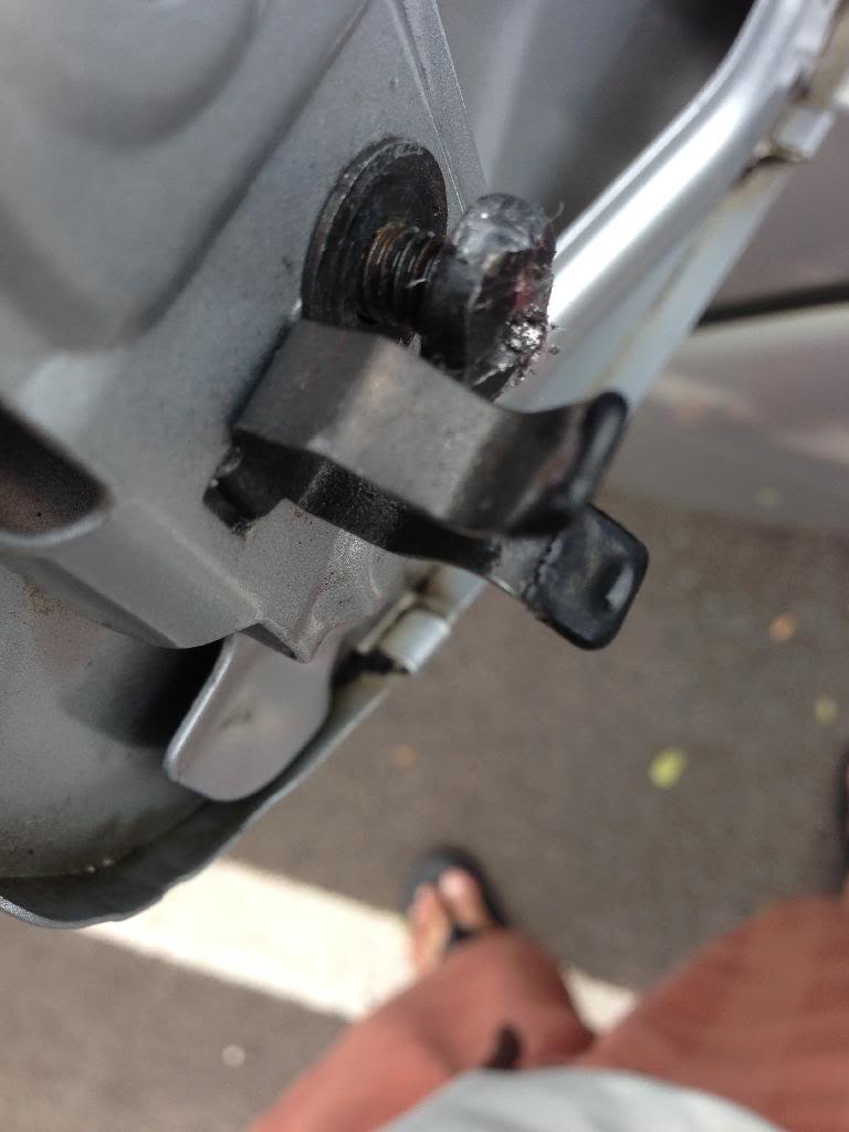

    Installed the lock actuator, ran the wiring, installed the switch, everything works. Went to replace the factory door clip, the f**ck*n screw wouldn't budge, not even an inch. WD40 the shizz out of it, still nothing. Got persistent and kept trying and what you do know stripped the shi* out of the screw. Damn it!!
    OP how easy was it to remove yours? Got any advise. If I could remove the screw I'll just replace it with another.
    Went from this...
    36CC201E-F1F5-4AB0-83D8-BEF12E4C7EEF_zps_3af6591f5457a4cdfec96f815af7e36a12290bdf.jpg
    To this. Tried everything, vice grip and pliers.
    D828520B-722C-4433-A52C-181DFA9375E1_zps_efe48188619bdec156e6af1ed315b3d55262b7ea.jpg
    Kinda PO'd that this small sh** wouldn't even budge.
    As for the fuel/door spring/clip from another Toyota vehicle. It's a no go. Spring/clip is ok in size, but the door doesn't have any open notch that the hook can hook too. I'll probably end up modifying it to try make it work for our door.

    I don't think I've ever had a screw put up that much of a fight. Mine was tight but gave up easily once it let go. It unscrewed freely enough to undo with my fingers. Is it possible the salt air added some corrosion to the threads to act like lock-tight? Maybe you could dremel a slot into the head and use a big flat screwdriver. PB Blaster has worked pretty good for me in the past. Might be worth a shot.

    Just a tip for next time: try to tighten the screw (or any other threaded fitting) first, if it wont loosen easily.
    This trick has worked for me for years...

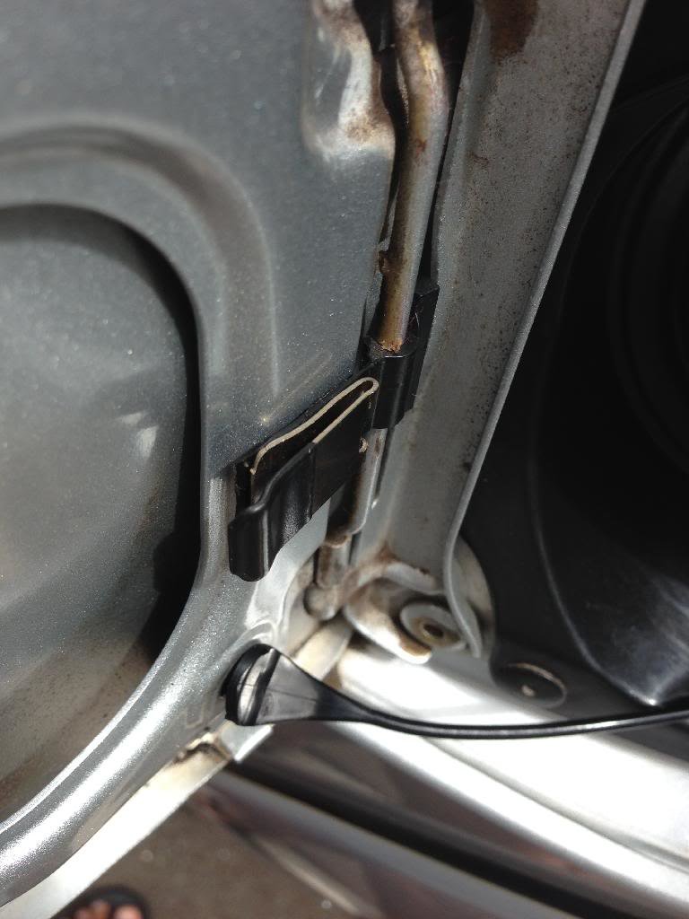

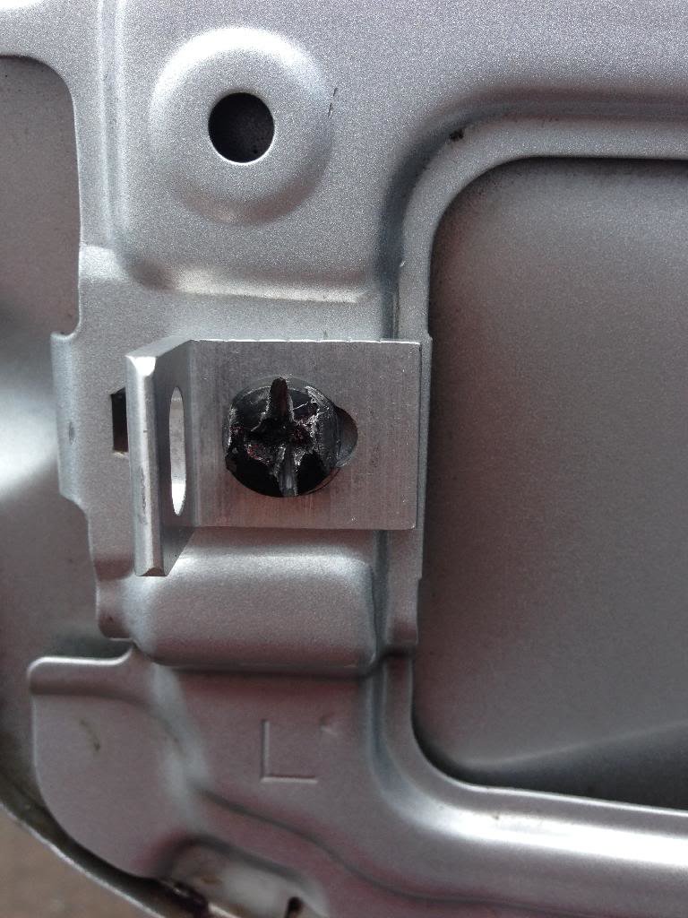

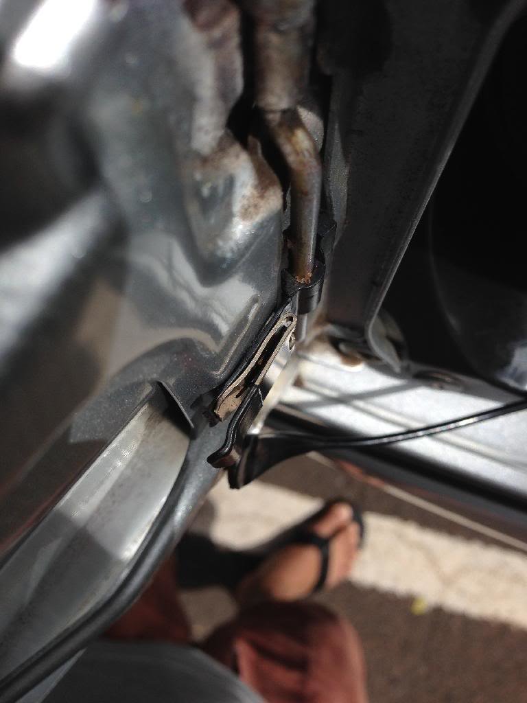

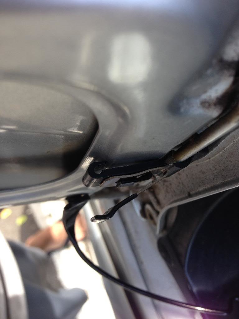

    Took the OP's advise. Used a dremel cutting disk, cut a slot on the screw. Damn thing finally budge. Installed the latch. Everything works.
    7D394208-96B5-4733-A6E8-F40554388917_zps_fab9b1271bf661eac943d48b582a772847cc578b.jpg
    FC94F2DF-DA71-4AD2-898A-AF0A5A8BB2EA_zps_d8eb32cdaa55120f6931cbe48d470b22b167ed79.jpg
    Modified the spring/clip for the door. Cut the end, and sanded down the bottom. Without sanding down the bottom, the door seems to bulge just a little.
    A20611A9-35B7-4E57-9BE5-C7144C4893AC_zps_17fe2d5449f13866df25a45e87642b4bfbd3f231.jpg
    0F5CF6B3-3A80-4979-8A2D-40CC481187D5_zps_2b738d41e97fc7f804ae992740ce859b04a8cc8d.jpg
    DEEAADC6-E5EE-47F9-B932-B5C549CB4447_zps_26f2262db855b9f4419ffbb192f17777c0e888c1.jpg
    Installed the latch. I'll eventually replace that damn stripped out screw, but will do for now.
    D0CCB92F-4826-4546-844F-17714098B35B_zps_2d4d5238cbf4bf9944a9d94709696c09c26567c0.jpg
    Overall, I like it.
