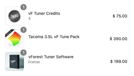

    Down the rabbit hole I go... I think this is the right list for ECU and TCU? Credits for TCU ID as a separate unit. Ordered the Tactrix cable separately already. I have a trip coming up in 16 days - definitely wanting this in before a longer drive so I can put it through its paces.

    You dont need to buy the credits. vF comes with 4 credits to unlock an ECU. You only need to buy credits if you wish to unlock additional ones.
    Edit: oh you said TCU. I dont think TCU has been added in vF yet. Personally I’d start out with what’s in the base ECU file before worrying about modifying anything in the TCU
    wrightme43[OP] and tonered like this.
