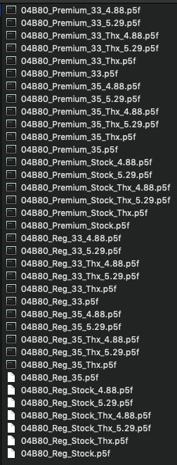

    Ok, I got through all the registration steps (oof that is a pain, but worth it for an awesome product!).
    These are the tunes listed in my zip file that I received from Rafael Bautista (and Mathew Wilson) of VFTune:
    I am trying to decipher which file I should apply. I run premium fuel (91+ octane) and have the stock gearing and stock tire size. That leaves me with either:
    04B80_Premium_Stock_Thx.p5f
    or
    04B80_Premium_Stock.p5f
    What does the Thx label mean?
    Thanks in advance - can't wait to try this out today!

    THX is enhanced throttle. Try each version to see what suits you best.
    Here is how @OVTune described it:

    I’d start with this file 04B80_Premium_Stock.p5f

    No worries. THX doesn't come up in a search. Enhanced does.
    ECT should be like stock on the current tunes that you have. GL was held out for the Final release.
