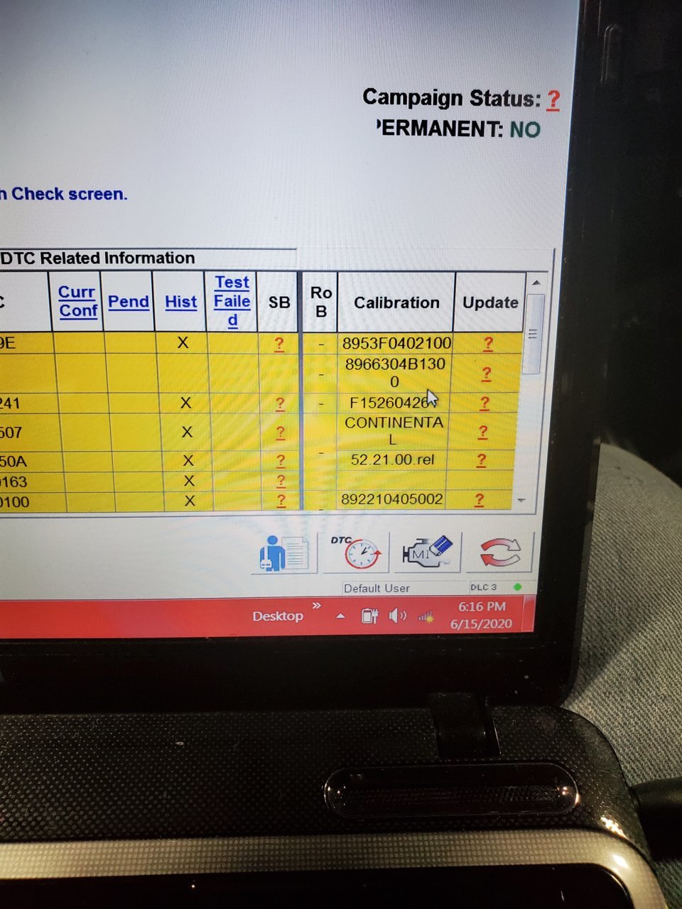

    Updated ecu to 4b1300 using techstream download from tonered and instructions from Ruggybuggy.
    Not very hard at all. Kind of a pain in the butt, but not impossible.
    Waiting to get my registration validation from VF tune to flash in my tunes. They are just incredibly busy. I hope they make a fortune for all the work they have done.
    Georgeee28 and tonered like this.

    New ecu calibration. 8966304b1300.
    This will matter when I/you download my/your20200615_181615.jpg tunes.

    Ok if you haven't done the TSB to update ecu calibration to 4b1300 it would be a good idea to do that even if you never buy OV VF tune. The tactrix openport II and Tonered's signature will help.
    It feels much better in 1st to 2cnd to 3rd. No noticeable changes after that so far. Seems to be more matched in the power as you go thru the gears.
    Thanks again to the people that found and shared the information!!!
    AKGSD, Georgeee28 and tonered like this.
