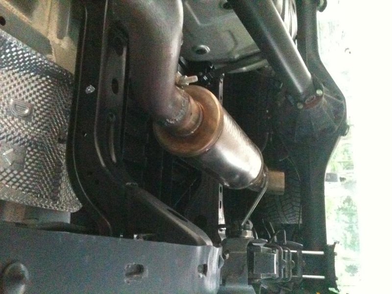

    The Magnaflow was about a foot short on each of the two factory attach points. I thought they sent me a short bed unit. Looked it up online and all three trucks (access cab, DBSB, and DBLB) have the same part number. There was a note that I saw for the first time that said not for use with X-Runner or TRD models. (???) Figured it was mine at that point unless I wanted to incur some re-stocking fee. What I ended up doing was using the factory pipe from the cat back to the muffler. I cut it off the factory muffler and then welded it onto the Magnaflow. The turndown tip hanger points with the Magnaflow matched perfectly then.
