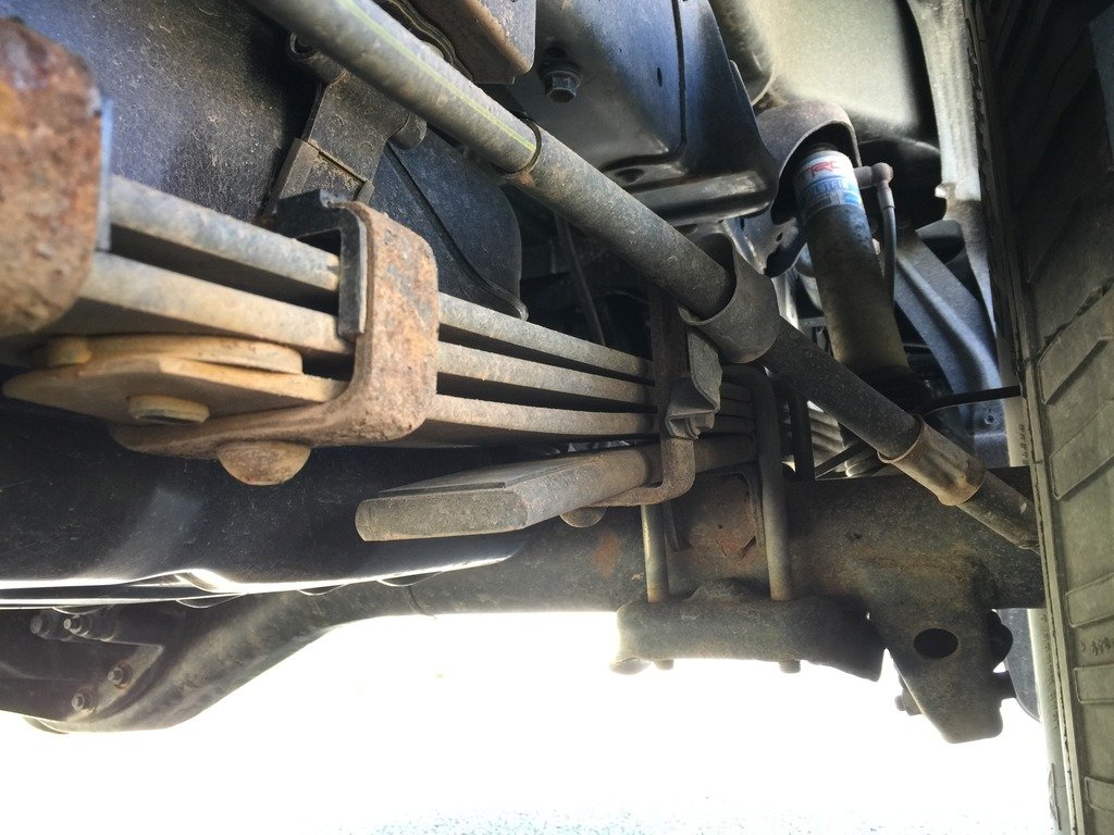

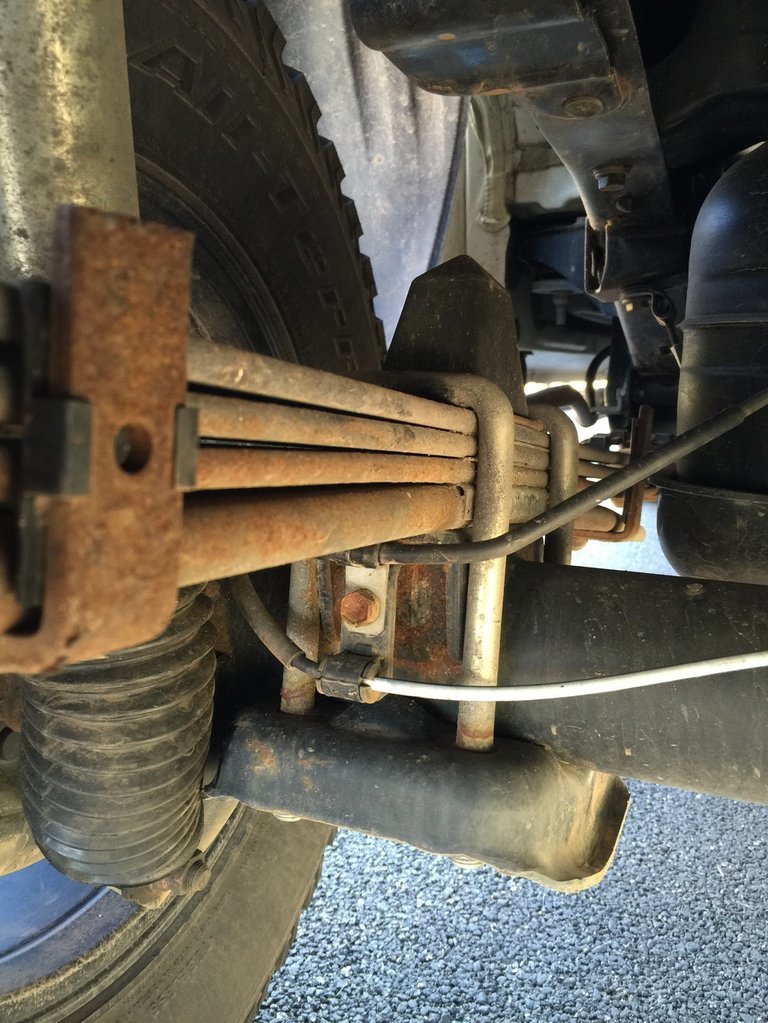

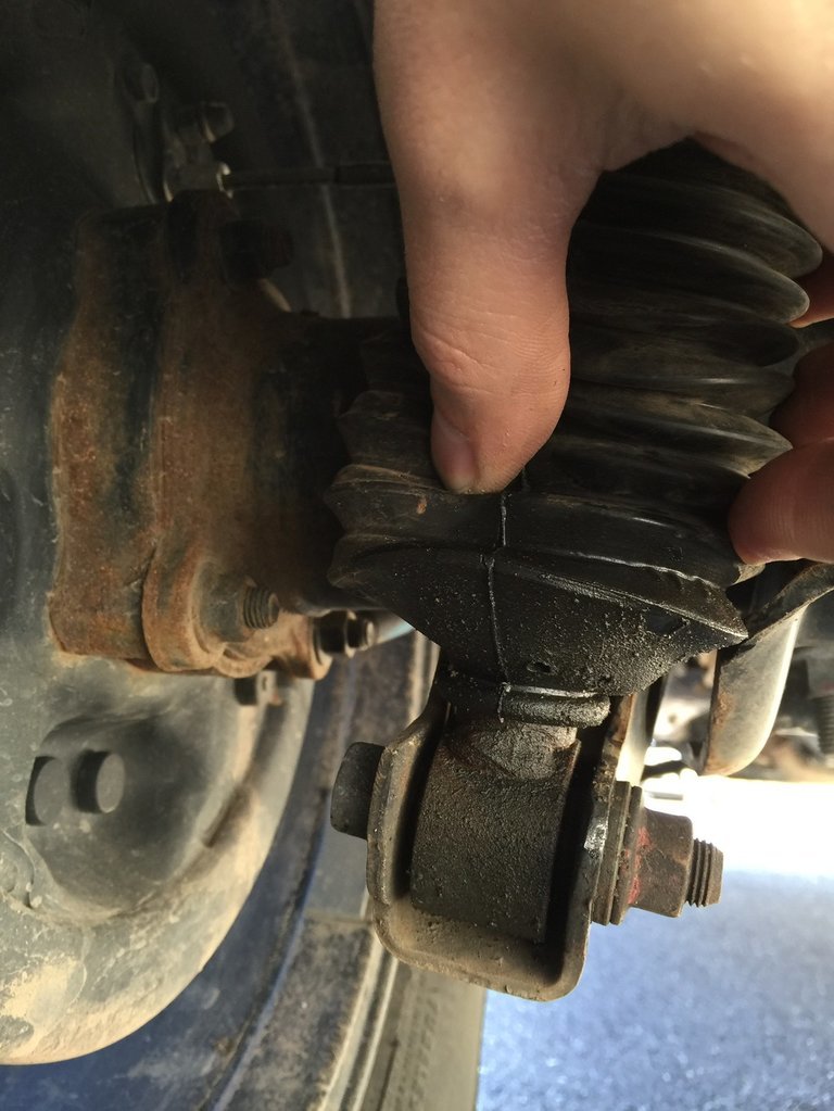

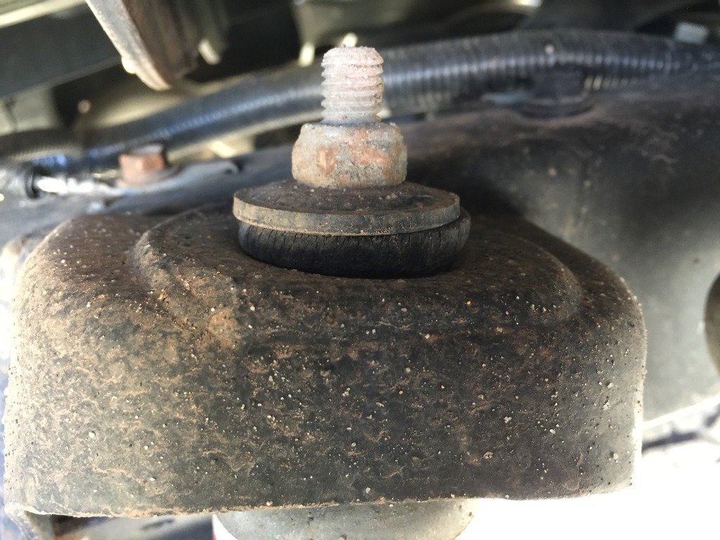

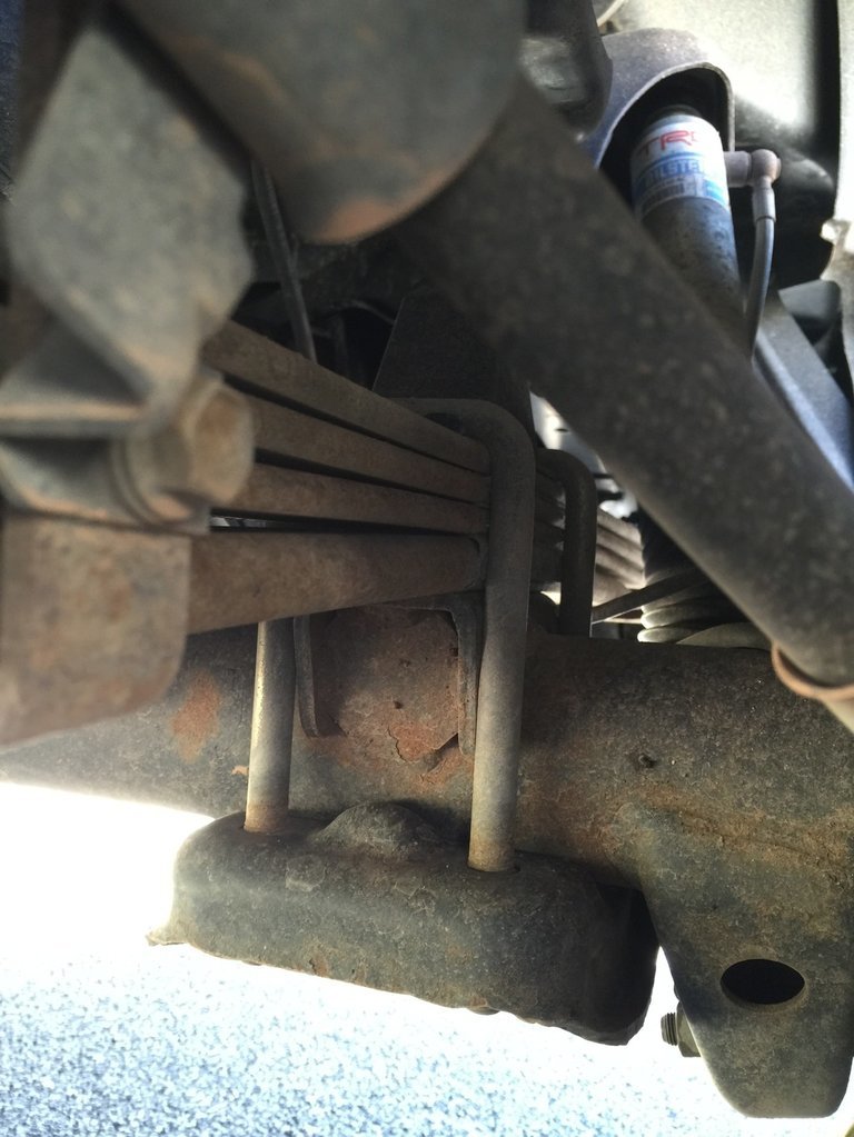

  6. Apr 26, 2015 at 3:29 PM
    #26
    MilesToEmpty
    MilesToEmpty [OP] Well-Known Member
    May 30, 2013
    #105224
    345
    Charles
    Frederick Co, MD
    '13 Baja TX
    Wheelers Progressive AAL, Firestone RideRite airbags.
    Well I crawled under my truck today since the weather was nice and noticed a few things. My leaf springs are sitting strange. They're almost warped looking. The passenger side one has more of a warp then the drivers side. Then looking at the shocks, the passenger side one looked fine, the boot of the drivers side had grease/oil on it like its leaking? Also the shock mount bushing looks dry rotted... Truck has 24800 on it now.
