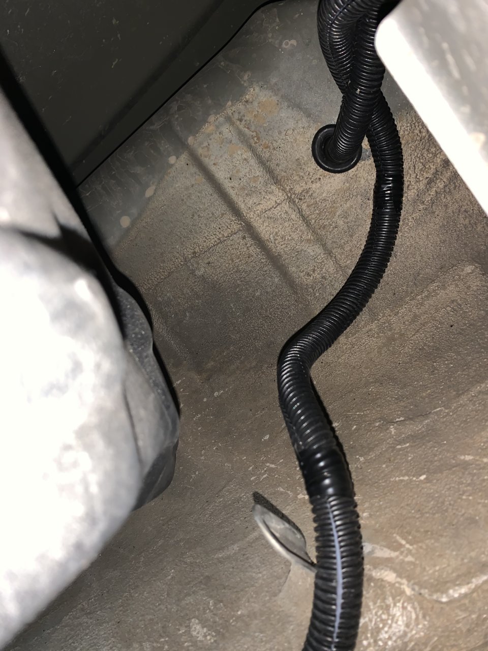

    @frenchee - for your truck you could do similar to what I did on my 1st gen. I ran a duplex 10AWG cable I got from West Marine from the battery then down along the frame and popped up at the front of the bed and poked through a hole in the front wall that was there from the BedSlide that was anchored there. You could easily add a hole here on the front wall OR just poke through one of the two large circular grommets on the bed floor and send the wire into the bed from there.
    I put an inline fuse holder about 4 inches from the + battery terminal that had a 10AMP fuse in it since I was only running a Dometic CFX50 and a few LED lights.
    The nice part about that duplex wiring from West Marine is that it has an outer sheath on it so I didn't bother putting anything else on the outside like that corrugated plastic wire loom that just collects dirt and grime.

    @JasonLee
    Just googled that duplex cable. I like that. Has a sheath and encapsulates two wires so you have a ground and positive all bundled.
    Is it pretty flexible, or rigid?
    I was trouble shooting some fridge voltage yesterday and realized I dont have the fridge fused. Well it's fused AT the fridge (fridge protection), but not close to the battery where the leads are.
    I have a battery meter, a blue seas fuse box blaaaablaaaa that I need to install. Been putting it on back burner. You got any pics of ur old install?

    The duplex is semi-flexible. It probably would take a tight bend, but you have to convince it.
    I left it extra long when I had it in the 1st gen and when I removed and re-installed into my 2nd gen, I had more than enough length to run it along the frame on the drivers side all the way to the rear cubby and poke into the bed there to connect the LED lighting and ARB socket for the fridge.

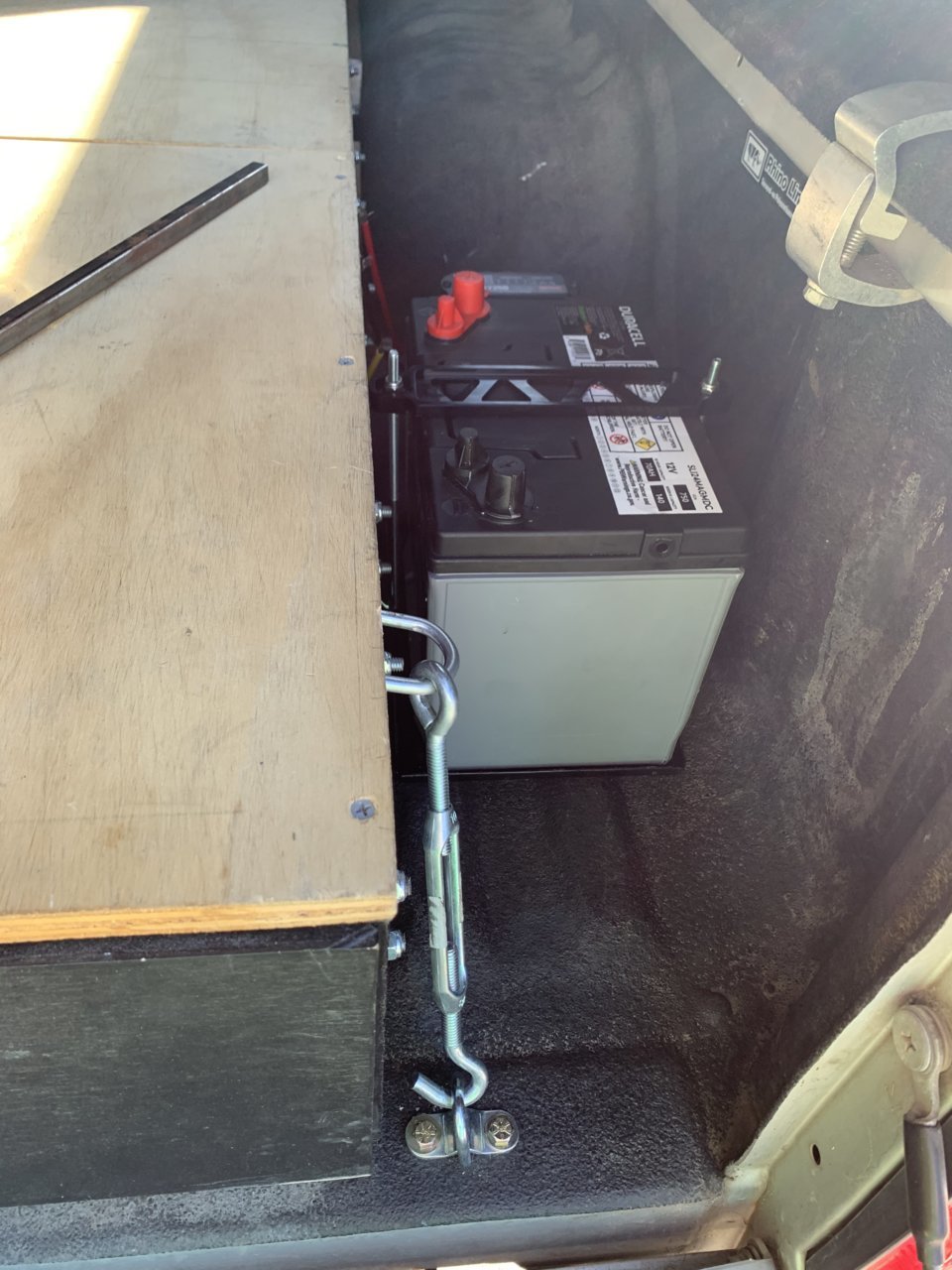

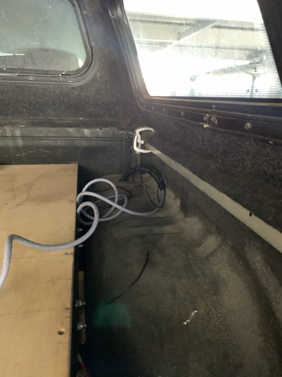

    This is similar to what I did. I have done it twice now with improvements each time, first on a GMC half ton crew I had for a short time.
    I have a lift in my shop and will be building a jig/rack to be able to very easily lift the SP off my Tundra, which I've wanted to do for a long time with my current rack/RTT but haven't. I'll rarely if ever move the top when I do need it off, to use my truck for something truckish, I'll want it off quickly. For this reason I'm going with a Anderson Power Pole setup but I also have another idea. I've been meaning to hit a salvage yard and find a big, multi wire (multi size and multi wire) connector from a salvaged car or truck. There are plenty of junctions on modern cars that have 10 guage down to very small gauge that I could repurpose for one huge do-it-all plug that is OEM quality, waterproof and durable.
    My current AGM battery is in the bed of the truck but I'll be moving it to a rack under the truck to free up space and lower the COG so I'll need a plug to all of the stuff in the top. I'm planning for lights and power (some switched from the dash), a back up camera, solar and also kicking around the idea of a Maxxair vent in the center of the roof. I don't think many of you want to get that elaborate but living in the muggy south air flow is paramount. These quiet, efficient and reversible fans are the shiznit. I've had them in everything I've camped in for many years except a RTT of course.
