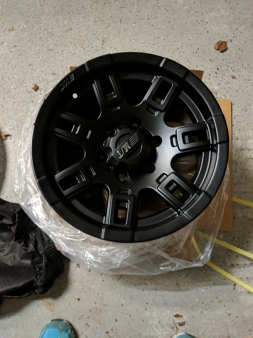

    Got the wheels today and they look good. Props to Jegs for shockingly fast shipping and lower final price than Wally world or Amazon.
    I woul like to get some TRD center caps. Anyone know if they fit? As far as I can tell, they are the same dimensions but the Mickey Thompson's attach with 3 set screws.

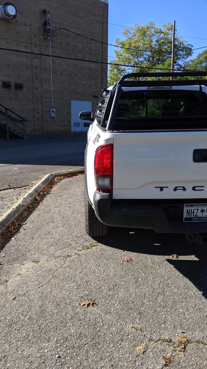

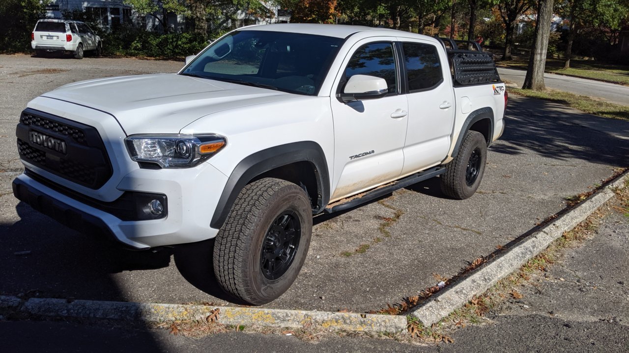

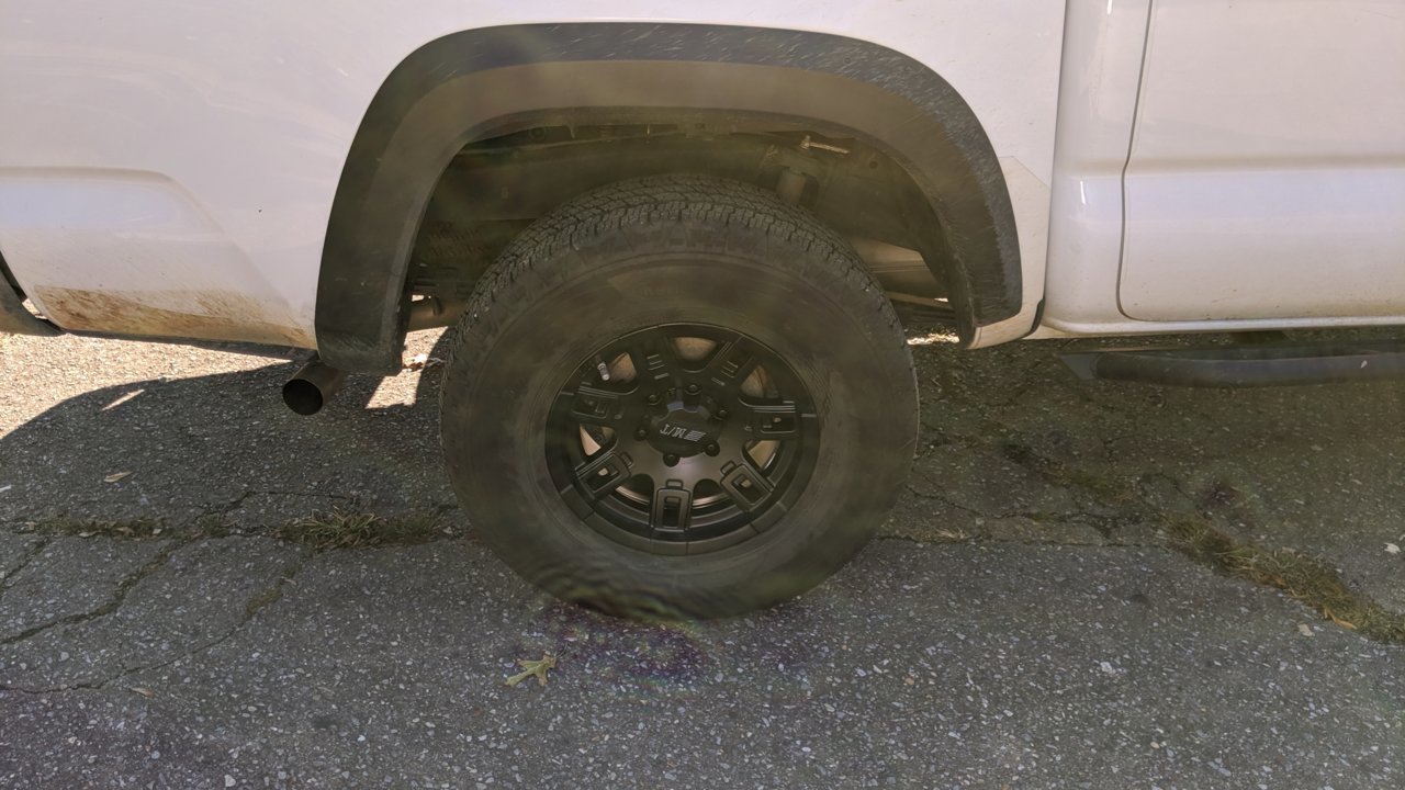

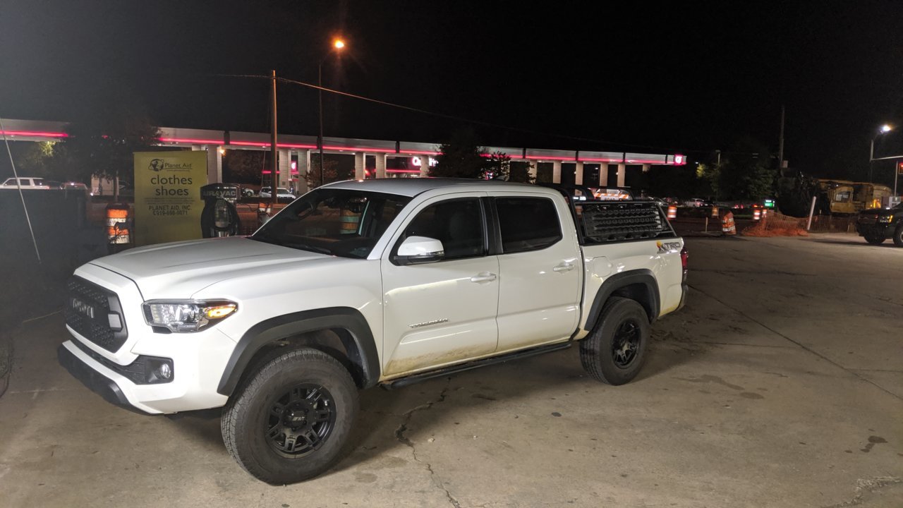

    IMG_20191101_194441.jpg IMG_20191103_140603.jpg IMG_20191103_140625.jpg IMG_20191103_140536.jpg
    Put the wheel right out on the edge of the fender.
