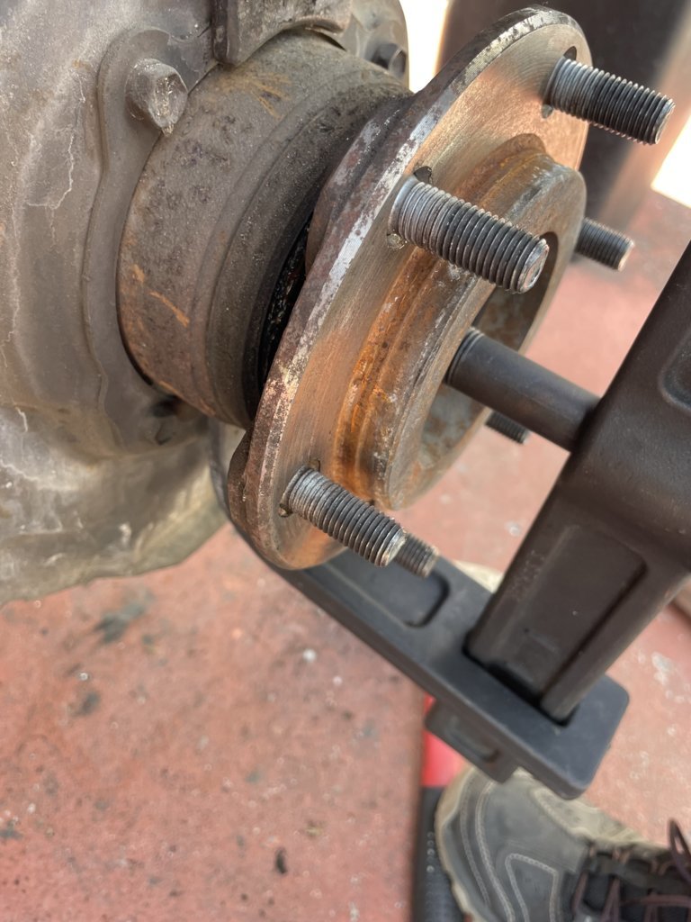

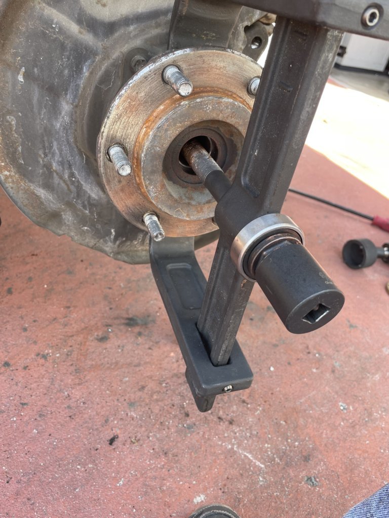

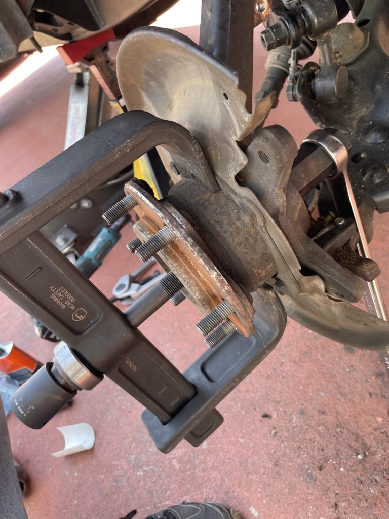

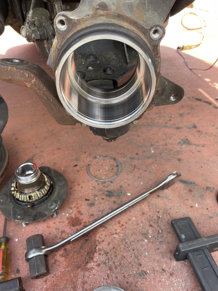

    Long story short...
    I just did this today with the knuckle on the truck. I disconnected the tie rod to articulate the knuckle.
    I used a Hub Grappler, Astro wheel bearing kit and a Makita impact driver.
    It took the Hub Grappler to remove both the hub and bearing. The wheel bearing tool kit was used to install both.
    The Malkita removed and installed the hub on torque setting 2 but removing and installing the bearing took setting 3 (max). I heard the pop when the hub was being removed except it wasn't loud.

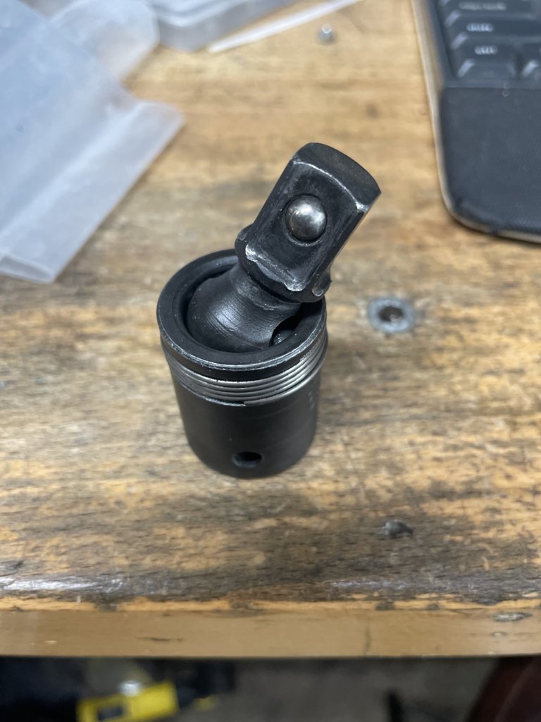

    This swivel impact drive adapter was needed as the knuckle only swings so far.
