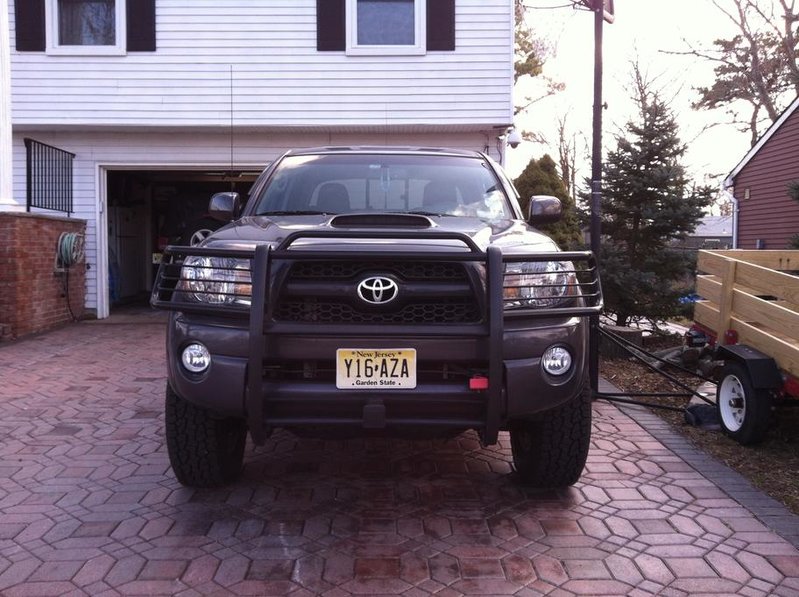

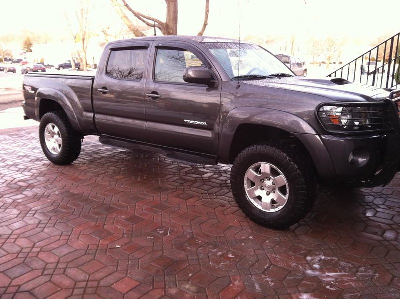

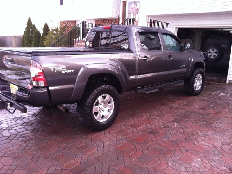

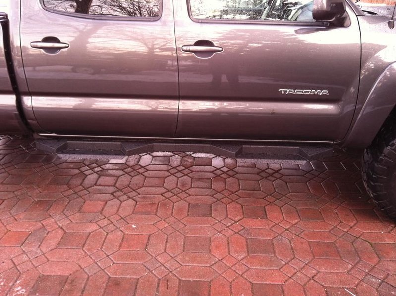

    As I posted before I removed the lift spacers and added billies w/ eibach coils and toytec 1/2" top plates.I put on FJ wheels I picked up for $300 (all 5 with TPM's) and 285/70/17 BFD km-2's.I also got the body armor side steps. I think they look cool........They were heavier than I thought they would be.
    What do you guys and gals think of my turd.
    Next is the Body armor rear bumper and winch bumper from Tactical armor group.
    Where does it end? HAHAHA!!!

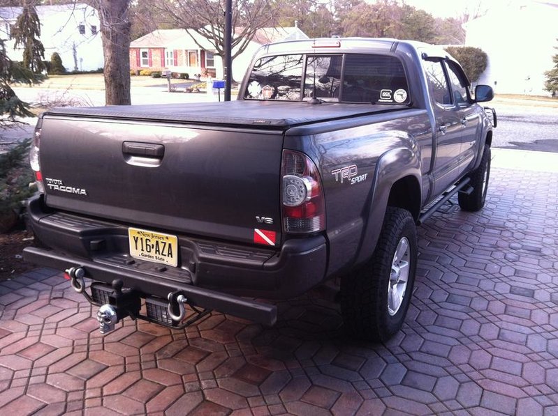

    Nice looking truck. What's on the back of the bumper?

    Some stuff...
    Love that Body Armor side-step!

    Thats just a piece ofsteel box tubing. Where i work people think bumpers are used for parking. Goheadbump me now lol

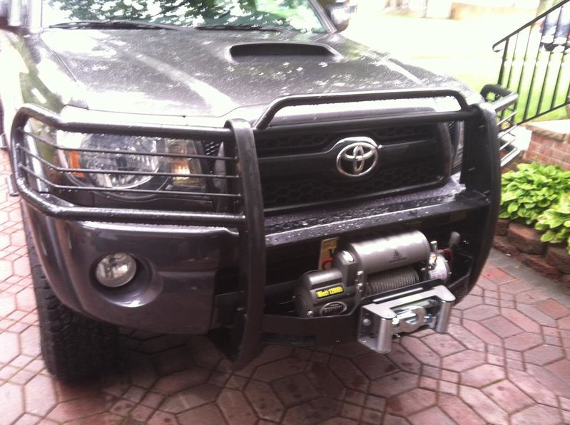

    Where did you get the front brush guard? I like it, nice looking truck
  6. Feb 1, 2014 at 2:51 PM
    Fire Taco Fighter
    Fire Taco Fighter [OP] Well-Known Member
    Jul 24, 2011
    #60451
    352
    trd
    ebay I think it was $250

    there are the old steps I took off....I made those last year.
    If anyone wants them you can have them I am in central NJ

    before and after winch pics.
    After getting the brushguard I ordered the Westin winch tray and mounted the brushguard to the winch tray.

    Looks good. Any rubbing issues w/ the 285s?
  11. Feb 2, 2014 at 4:43 AM
    Fire Taco Fighter
    Jul 24, 2011
    #60451
    352
    trd
    At this time YES lol hits the front bucket thing on the front of wheel well. Today I am going to try the tires w/out the 1.25" spacers and see what happens. I don't want to do any trimming just yet, I want to see if I like the bigger tires. The bfg km2's are a bit loud but then again they don't have much tread left...I only fot them as a test tire.
  12. Feb 2, 2014 at 8:26 AM
    Fire Taco Fighter
    Jul 24, 2011
    #60451
    352
    trd
    Ok I took off the 1.25" spacers and at full lock left or right forward or reverse ZERO hitting and zero trimming was done. I am happy.
