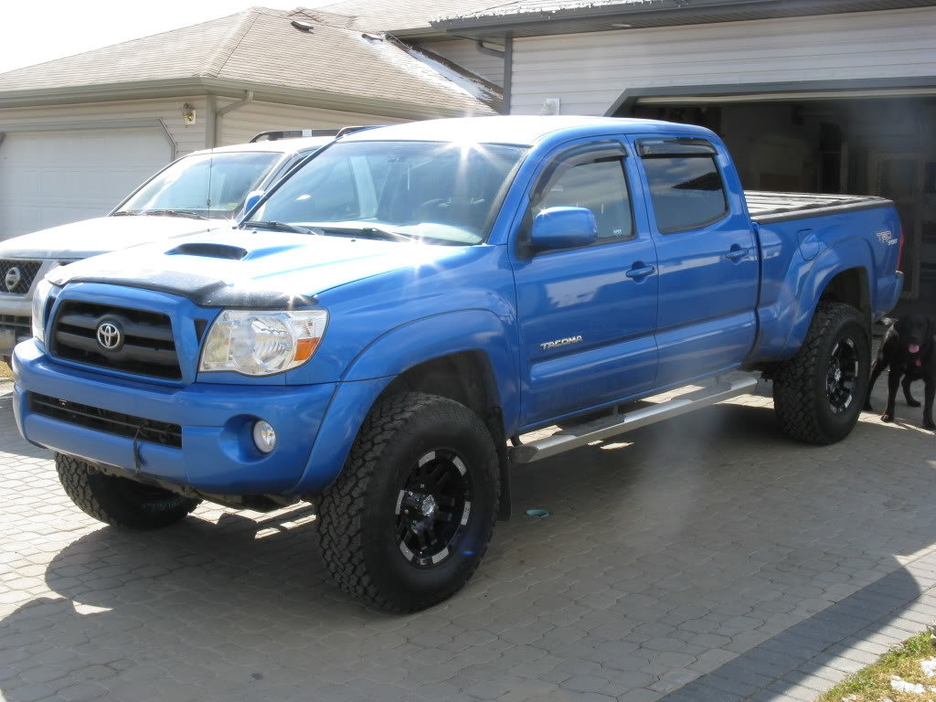

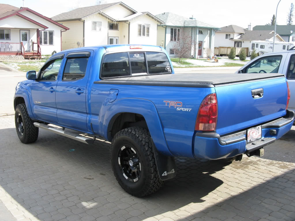

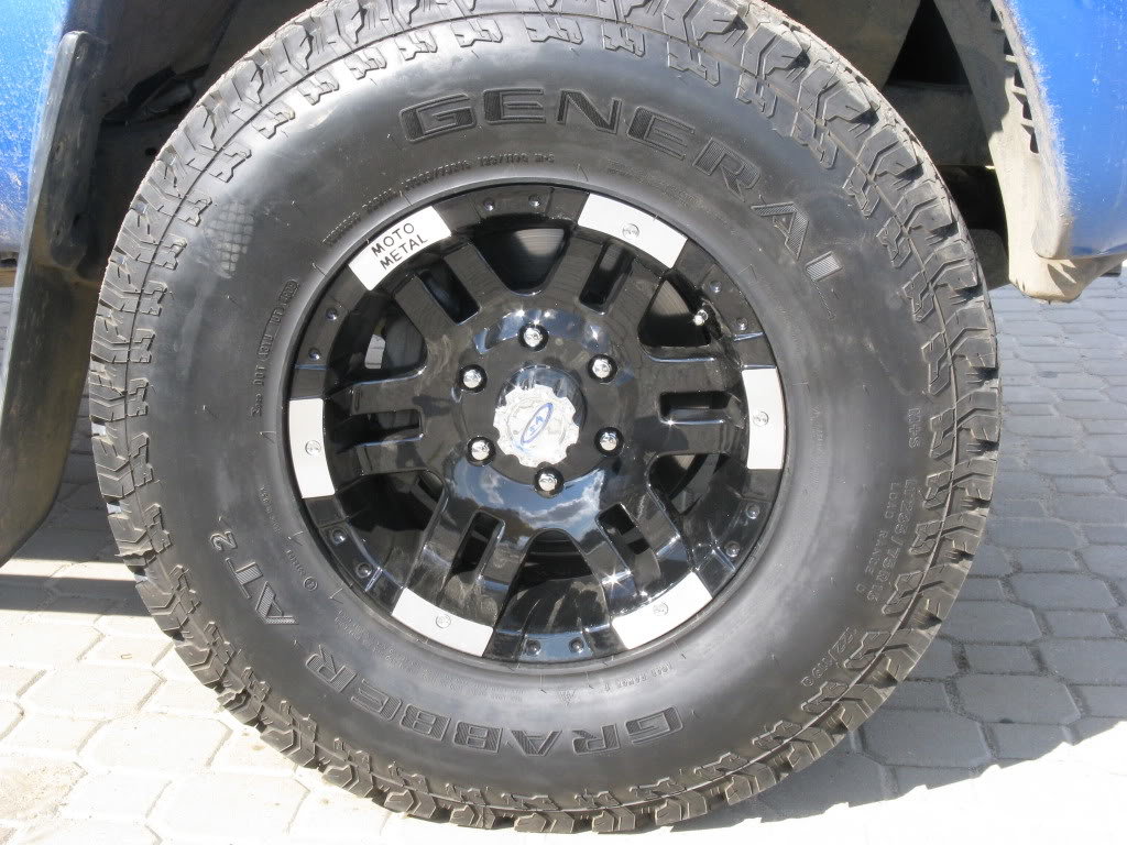

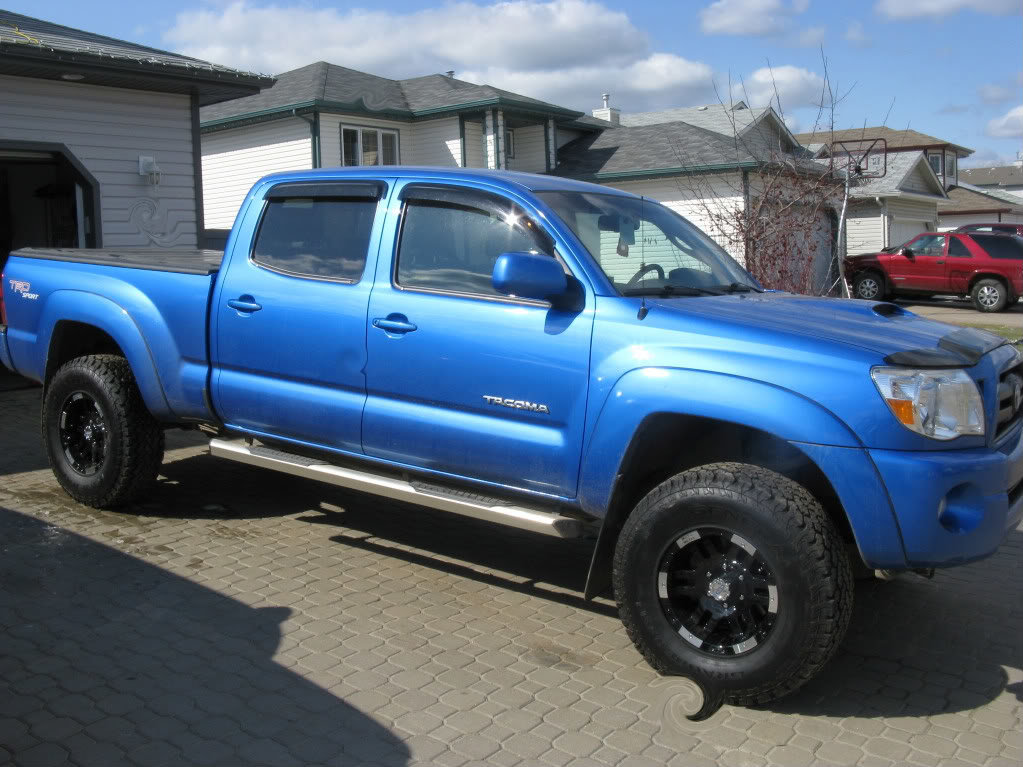

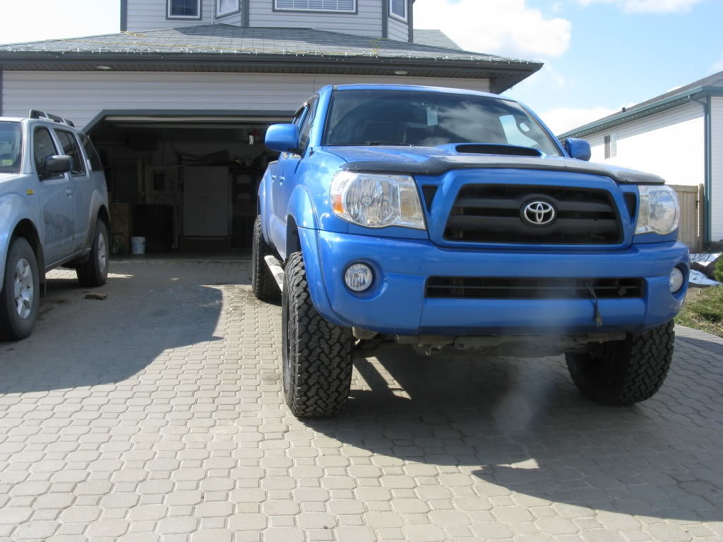

    So I finally got my new rims and tires. My truck has a 3" Revtek spacer lift and came with the 265/65/17 stock. I went with a Moto Metal 951 Black 16x8, 4.5" BS, 0mm offset wrapped in 285/75/16. I absolutely love the new set up! Has just the right amount of rubber sticking out IMHO.
    A few poser pics!

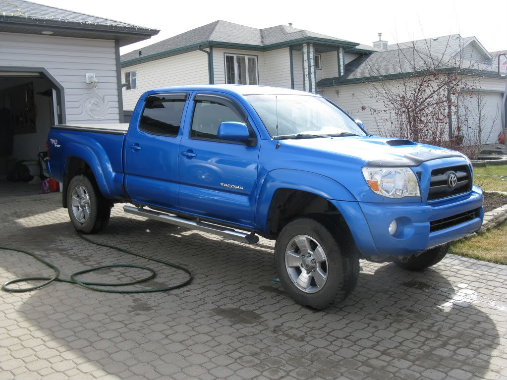

    Before:
    After:

    Nice! With that lift, the stocks were way too tucked in. Now, it looks perfect! Woot!

    Well the tires in that pic were not quite stock. They are my snow tires (Michelin x-ice 245/70/17) but the stocks looked the same. I aggree, I love the way the truck looks now. :)

    Nice!! I had the same set up but didn't like it, we could have been twin :D....btw just curious how did you find a 0mm offset on these motometal because I could have sworn that they don't even exist...

    Yeah they exist all right. The 16 x 8 comes in a zero offset and the 17 x 9 has a -12.

    the part I didn't like was our stock wheel stud was way too damn short for these wheels, and my gorilla lug nuts was barely screwed on so it's a PITA that I have to keep checking the wheel at rest area whenever we traveling far distance with my truck :mad:
