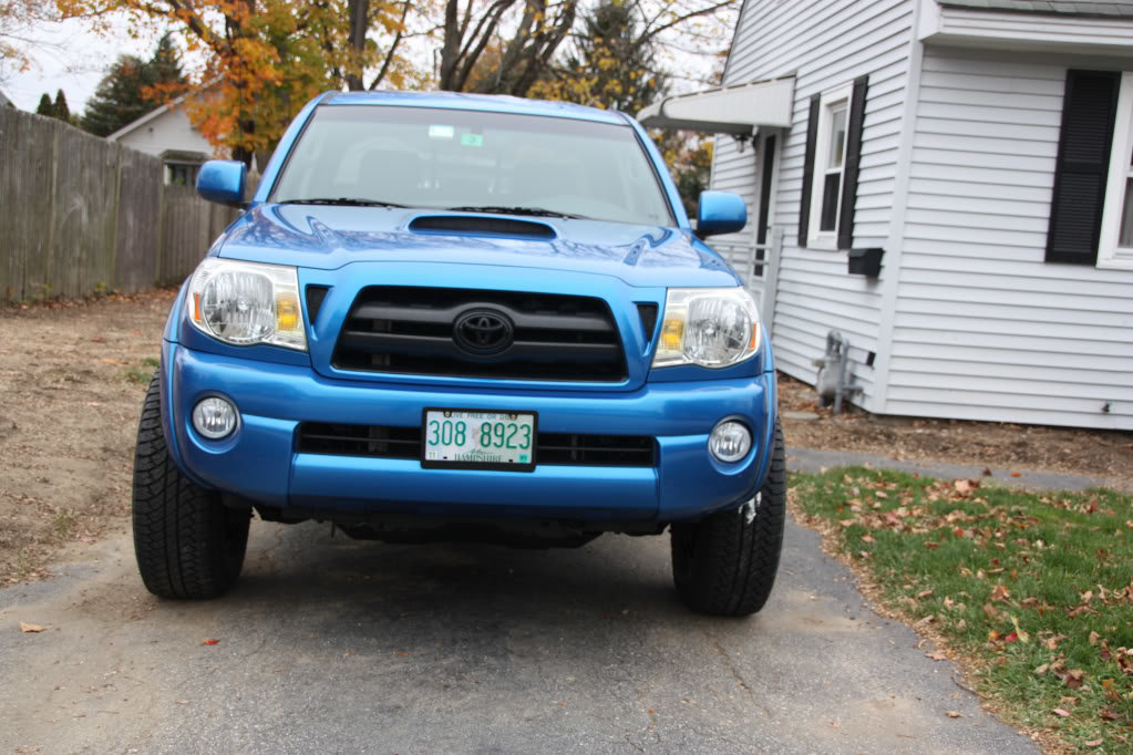

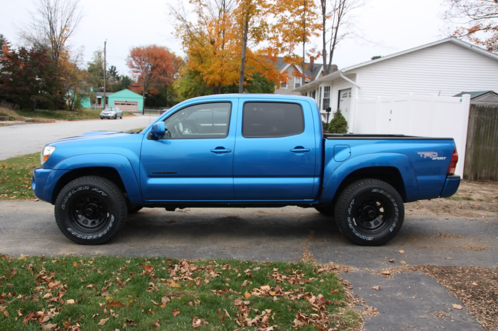

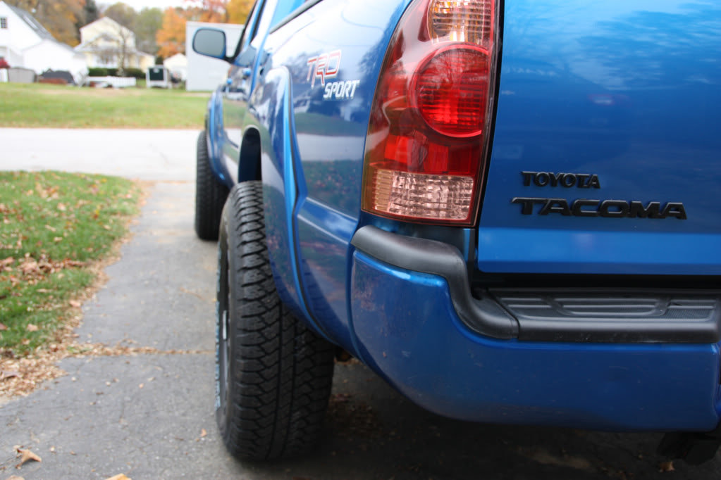

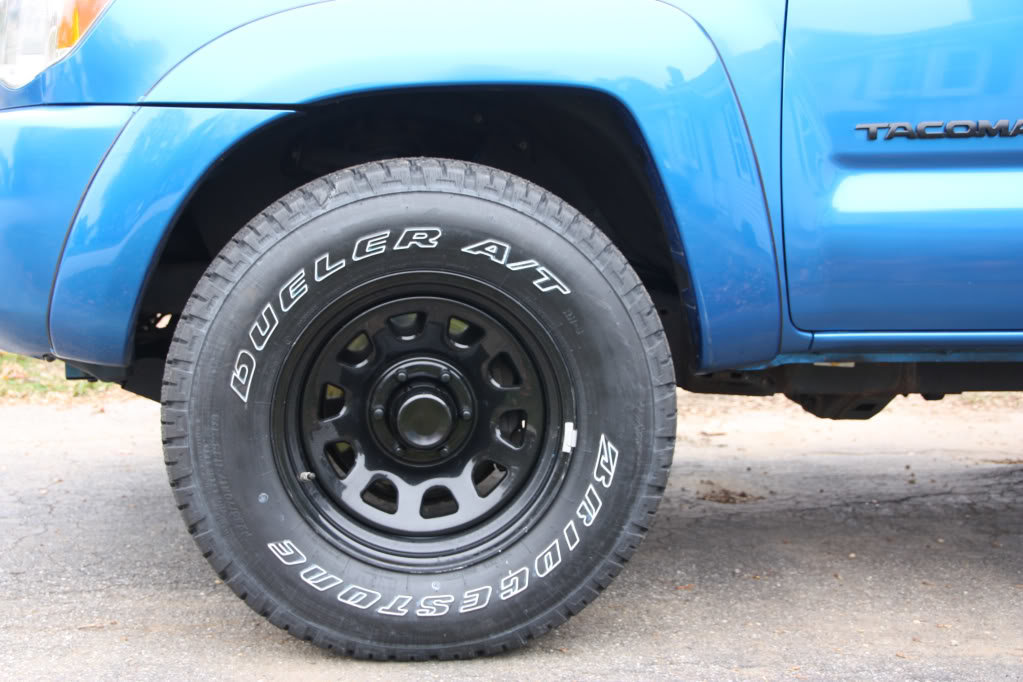

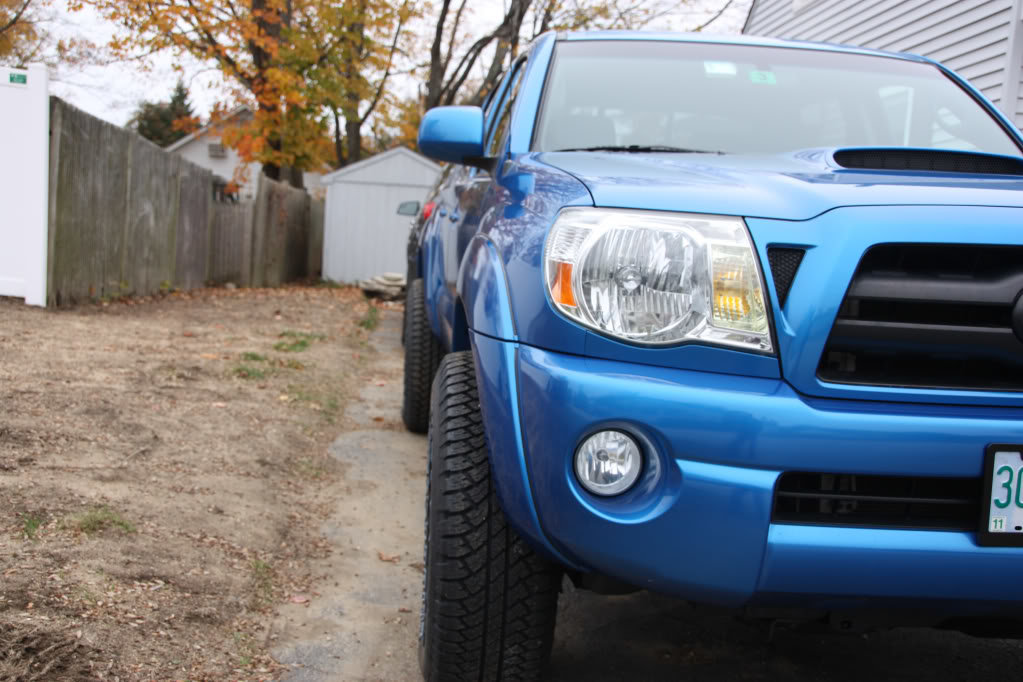

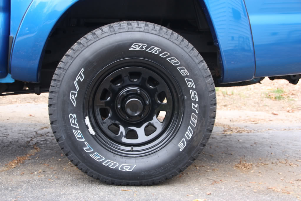

    Pro Comp Series 52 17x8 Steel Rock Crawlers, with some 265/70 17 Bridgestone Duelers ATs.
    I need to do some slight fender trimming now.

    Thanks, didn't want to go too aggressive, I have 1.25" spacers and the 265s rub, need to trim the genders as it is.

    Looks great! Im looking to do a similar set up.. ive already got the spider trax but why did you go with a 17" did you need them to clear the brakes? Even with the spacers?

    I was originally not going to get new tires so I got the 17s, after the fact decided to get new rubber. If I could do it all again I would have gotten steelies from wheelers offroad and gone with 16" wheels.
    Was an uneducated decision that cost me little money and time to trim the fenders, but I am 100% pleased with my setup.

    Just curious but whats the back spacing on those?

    4.25"

    did you test fit the wheels before you installed the spacers to check on caliper-clearance?

    Yes I did, seem to rub slightly on the calipers, so I went the safe route and hit the spacers.
