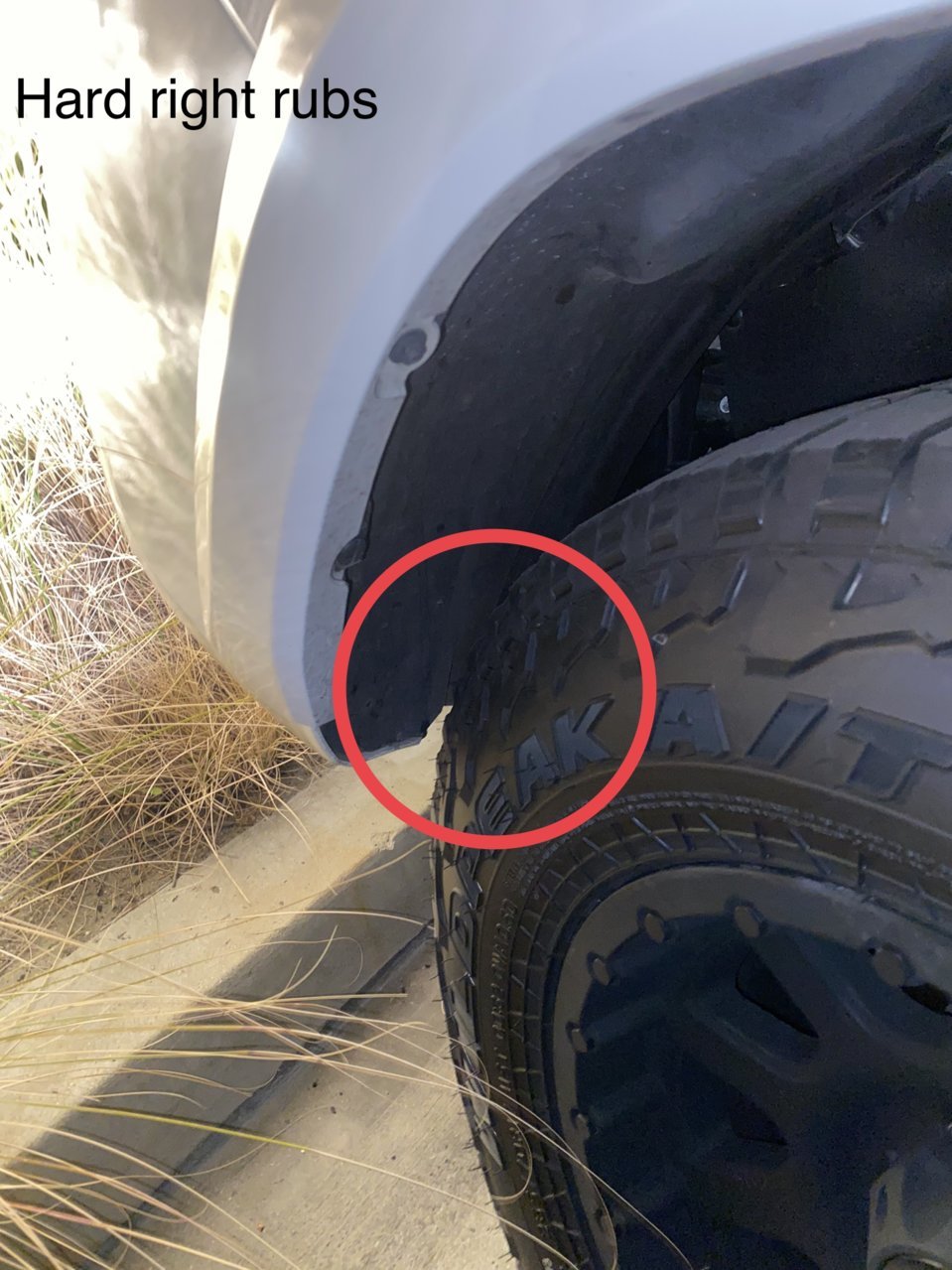

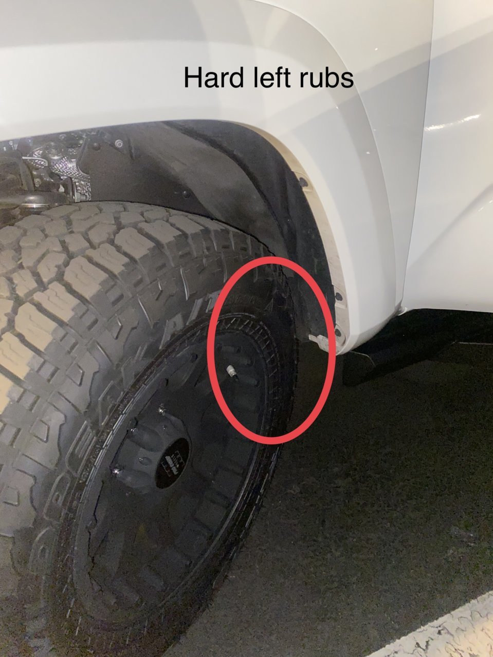

  6. Apr 5, 2021 at 8:37 PM
    #26
    ShabbaRankedSR5v6
    ShabbaRankedSR5v6 [OP] Member
    Mar 24, 2021
    #360471
    11
    2020 Tacoma SR5 V6 4x2
    Here’s example of a hard left and hard right.

  8. Apr 5, 2021 at 11:09 PM
    #28
    PinStripes
    PinStripes Well-Known Member
    Oct 2, 2019
    #306884
    325
    Oregon
    2018 Cement OR DCLB
    Off to a great start. Maybe relax a touch.
    So, go drive through a mud puddle and get it all nice and dirty (or use sidewalk chalk). Do a short drive and make it rub then look for the clean spots. Use a Dremel to remove hard plastic. Use a heatgun to reshape softer plastic liners. Lose mudflaps. Use YouTube for step by step videos. Use Google to find 5 versions of this thread.
