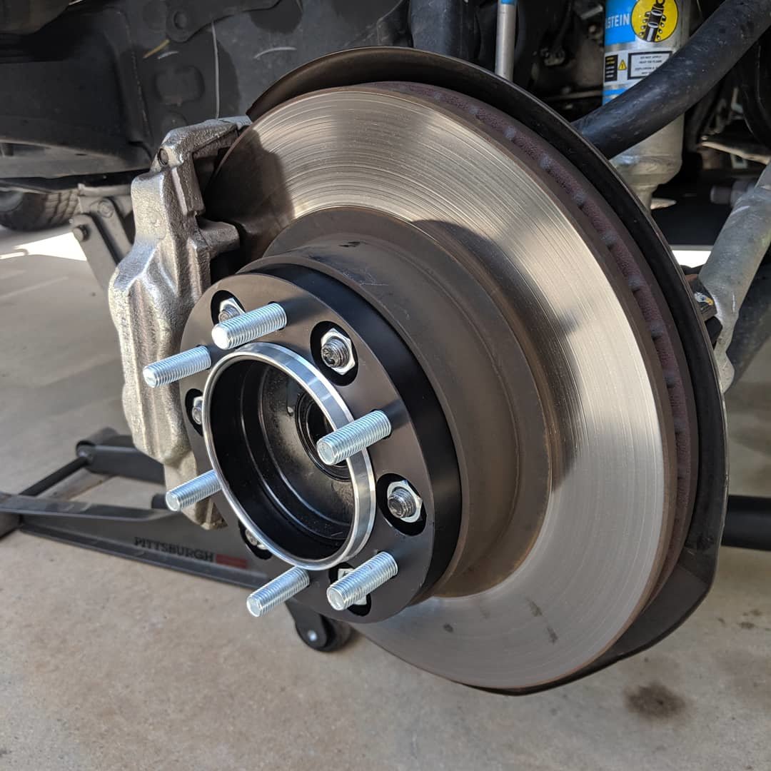

    You might know this already, but with the 0.75" spacers, make sure those wheels have recesses where the OEM studs can protrude into, otherwise they wont go on well most likely

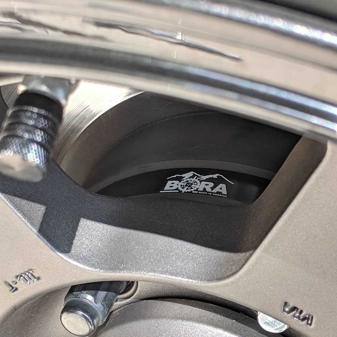

    Totally. Somehow I totally lucked out, the pockets between the lug holes on the wheels are hogged out with plenty of clearance!

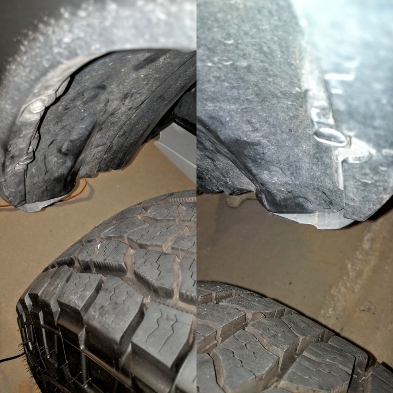

    The aggressive stance has kind of grown on me so I started doing some minor fender trimming should I want to keep the 1.25" spacers. The rear clears fine at full lock and travel, it was catching the front fenders. So I melted/reshaped inner fenders and trimmed a few mm off if the bumper

    I got the new 0.75" spacers on. The tires are now pulled in vs. the 1.25" spacers which I'm happy about.

    Do the top of the factory studs sit below the 0.75" spacer? Or do they stick out above the spacer?

    Is that a hub ring on that Bora spacer?

    Looks like a hubcentric ring, yes. I believe it comes with the wheels and not with the spacers.
    Most of these aftermarket wheels have 108 mm or 110 mm center bore.

    They stick above the spacer. The wheel would need to have pockets to clear the studs past the spacer.

    Yup, 106mm ID to 110mm OD hub spacer. Slips on the wheel spacer since it's machined to 106mm just like the regular hub.
