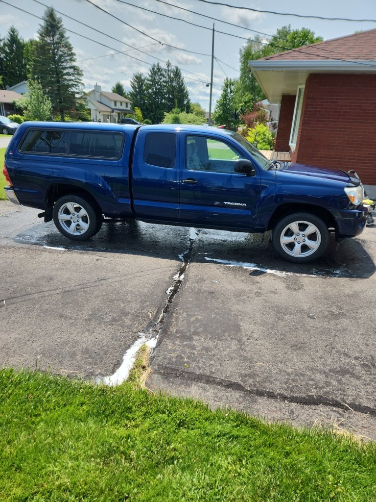

    Has anyone needed to balance there driveshaft after replacing steel stock wheels with heavier alloys. I have an 05 5 lug I just installed xrunner rims on and have a vibration coming from rear of truck when driving 80km or more. Wheels have been balanced twice

    Is wheel bent?
    Did everything run smooth with previous tires & wheels?
    Every now and then with a new set of treads, one will require extra weight to balance. I mainly run that one on the rear.
    Might Check u-joints and carrier bearing.
