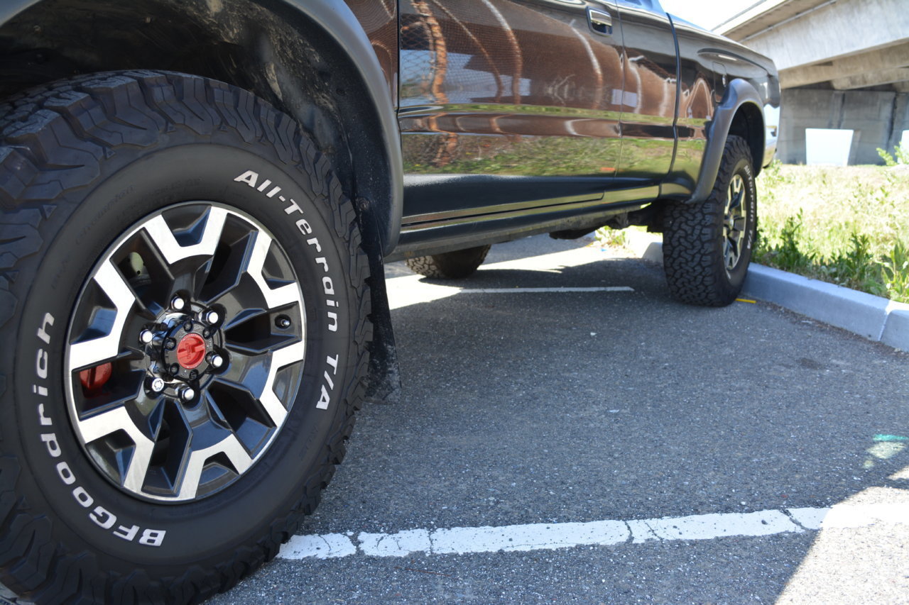

    Yes the covered pictures are prior to my 4WD swap. I used to be a 2WD PreRunner.
    You can’t put the covers back on with the manual hubs. Maybe with wheels spacers but I don’t see the point. I should add with my tire size, adding spacers make the running even worse. I run no spacers and have very minimal running of the upper control arms at full lock.

    Depending on the tire size you might rub the upper control arms. I currently have rubbing at full lock, but that may be on account of the fact that I have bigger tires than stock size. Spacers make the rubbing worse.

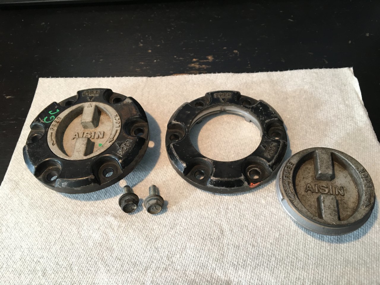

    I saw some used on ebay for a reasonable price. It's an old truck, definitely don't need brand new rims.
    I have the locking hubs already, what about just a swap for new switches or painting them so they look new? Having newer rims would look odd with the existing corroded locks. I think what you're describing was from your swap from 2WD to 4WD.
    Here is a picture where you can see the existing setup, not sure if that helps. Current tires are the P265/70R16.

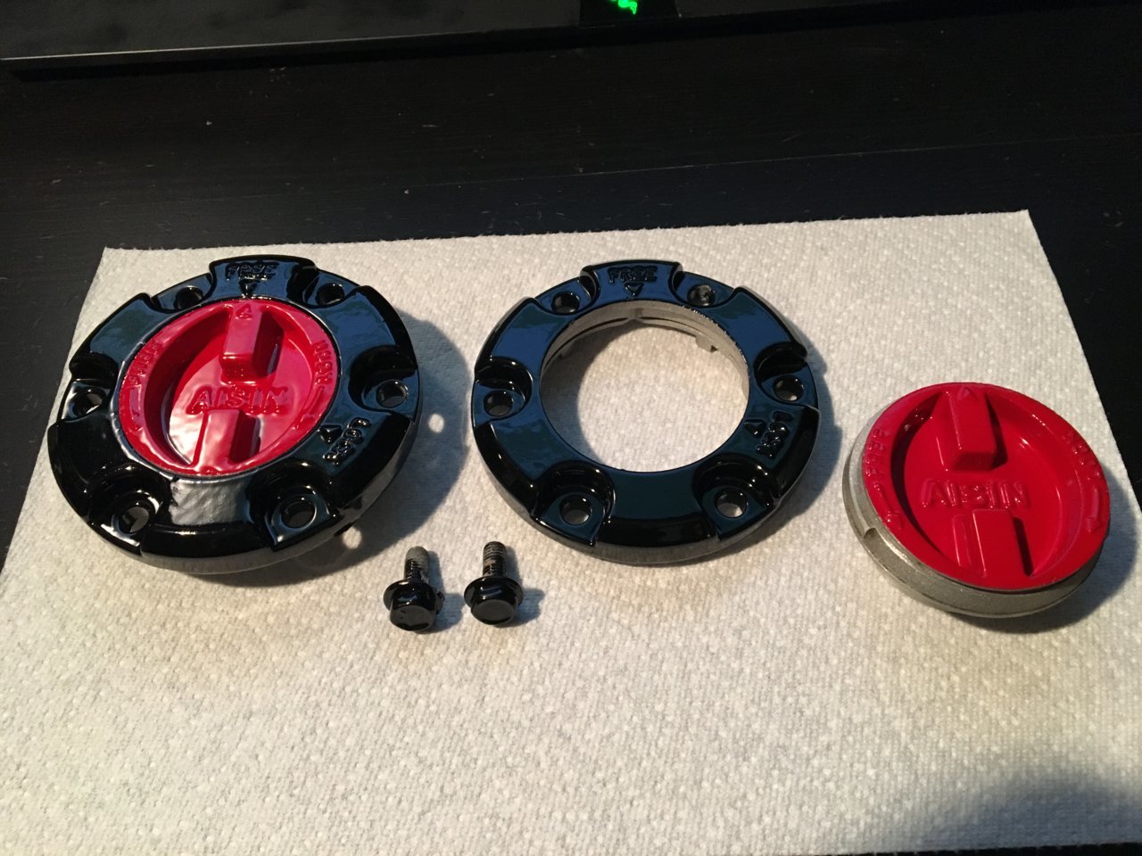

    the hub is pretty simple to disassemble and paint.

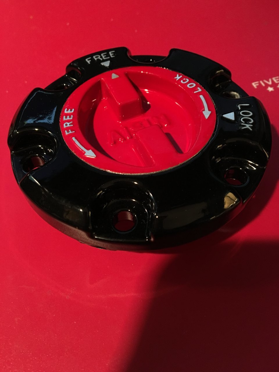

    Bring it to a powder coating shop. They sandblast it and make it look brand new. I paid about $100 for this and it’s very well worth it, I’d say it makes the look of the truck.
    Unlike paint, glossy powder coat does not “absorb” dirt and grime as much as paint.

    Whoa that looks sweet! Good suggestion. Looks like it's just a couple of bolts. How did you get the lettering white?
    The painted version looks nice too but I see the advantage of spending the extra cash to have it powder coated.

    The lettering isn’t painted, that’s the bare aluminum you’re seeing. I masked everything off and sanded the lettering with 400 Grit sandpaper.
