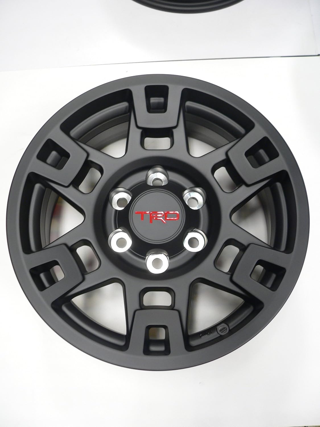

    Hello,
    I have an SR with these little steel wheels below. I just bought a set of the black TRD wheels also shown below. Do I need to change out my lug nuts? I'm not worried about the color just the fitment.
    If I have to change them out, can someone point me in the direction of which ones I need to get?
    Thank you in advance,
    Faingo

    OP, if these are 16” there never going to fit so just box them up and send them to me. I will take good care of them for you.

    Lug nuts for steel should not be used on aluminum, The aluminum ones need a much wider lip on them to hold on the them

    The steel lugs have an acorn shape. Alloys need flat.
