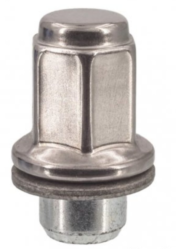

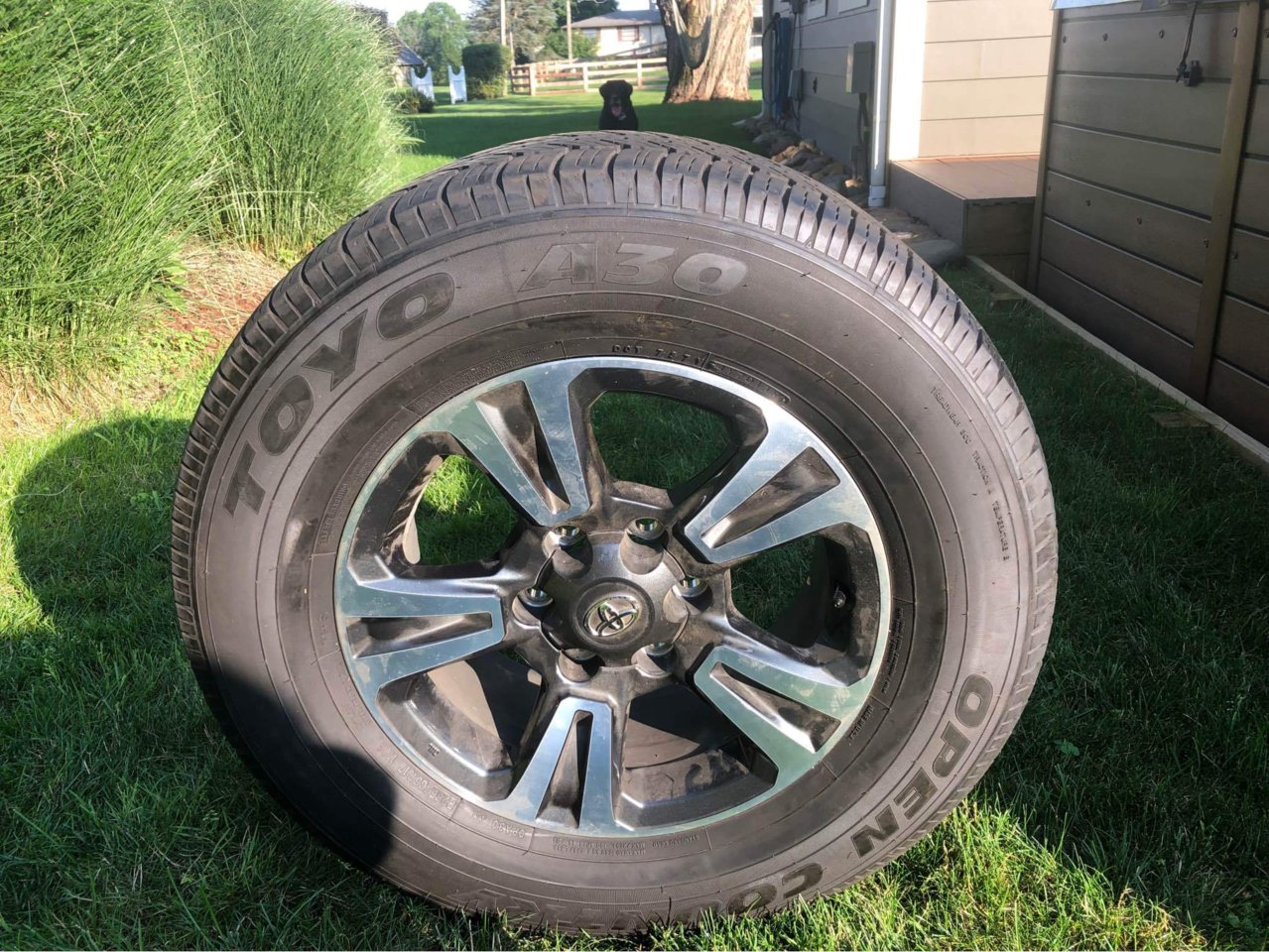

    upload_2021-7-25_15-59-7.jpgupload_2021-7-25_15-59-7.jpg upload_2021-7-25_15-59-7.jpg 20210725_160050.jpg 20210725_160050.jpg
    So, I have a 2021 SR and looking to add these wheels and tires. Will these lug nuts work?
    They came off my 2019 Tundra limited
    Sorry for all the pictures.
    Thanks.

    Yes, they'll work. There are 2 versions....long and short. They have the same thread engagement....so the length is strictly for looks. Some wheels have deeper lug wells than others. If ever in doubt...get the short ones.
    Also note....the end of the lug nut is tapered to accommodate your steel spare wheel.
