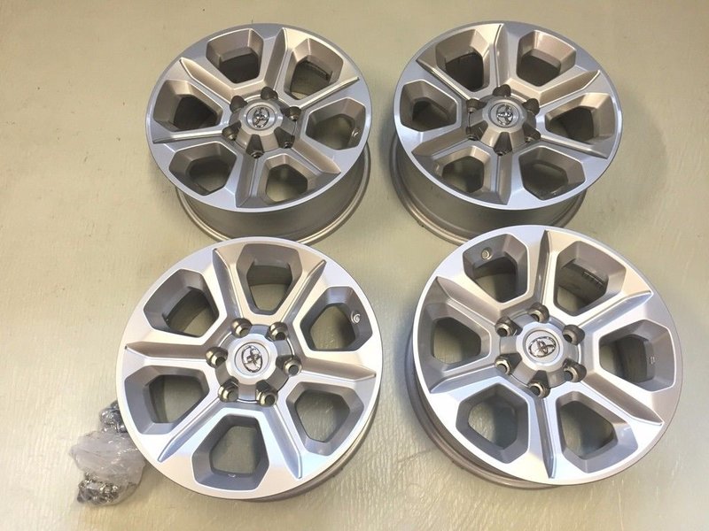

    Will these fit a 2002 Tacoma ?

    yep...
    with stock size tires. anything over and you will need spacers or to make room

    Thanks!
    I went ahead and bought them and will use the stock size tire....

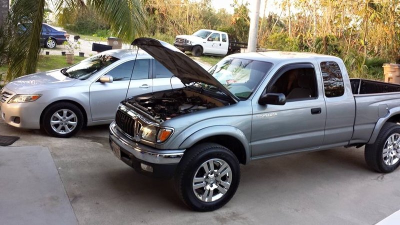

    New Wheels Older Truck...Direct Bolt On

    those 18s look good

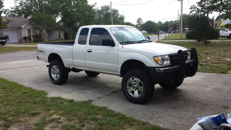

    Needed the 1.25 Spidertrax (hub centric) for these.

    so what year truck did those rims come from? and whats the size difference? did you need to "or should" change the speedo gear

    those are the Limited 18" wheels. stock size is 265/60-18 and no spacers needed. If you bump a size in tire you may have rubbing issues on the control arm.

    And I'm mostly positive toyota 6 lugs are all 6 x 5.5 (except maybe the cars).
    X2. The wider tires on mine hit the UCA. Got lug centric ones first..nope, had the shakes so I got the hub centric.
