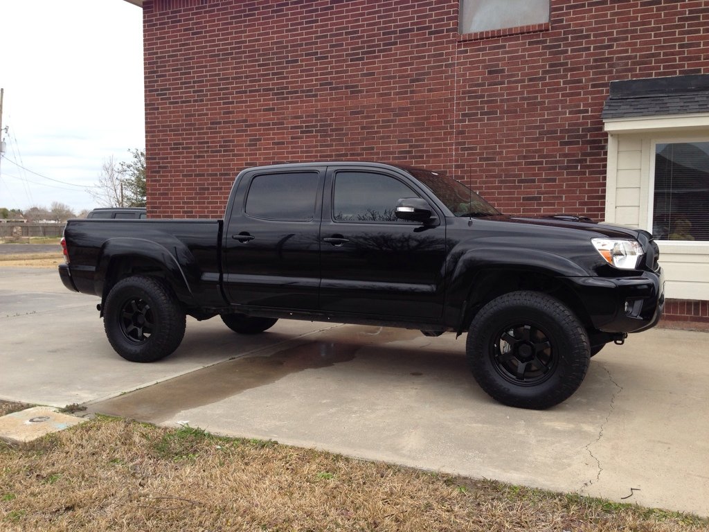

    Dunno the bore but I'm pretty sure pattern is 6x139
    Check out fn wheels. I had the ome 885 coils on a 2014 taco n used the "6 gun" offered by fn wheels. If you get a wheel with its specs you'll b good. I had very minimal trimming.

    Thanks jimbo331. I'm waiting on 885 coils as well. Did u use spacers with yours? Those wheels have a 4.5 bs & 0 os, did they increase ur stance or were ur wheels still tucked in the fender?

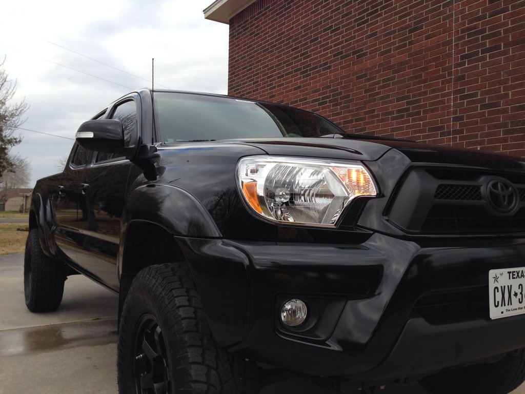

    373c281b884d5c5062364395f0baa76e_a5b0fa04e82dee88551ce29140f16e9d69c2c4e7.jpgba3f53d4ab47e6db2623831d28ae3caf_c32bf00c6fb9a919ce2d03503a475bf760f60a76.jpgthey tucked perfectly with those rims no spacers needed when u have 4.5 bs

    If u are going 17x9 I would get the 4.5 bs. My tires on that truck are 11.5 wide with that spec of rim and I had about .5-.75 inches from the tire to my uca. U use more backspace on a 17x9 and u are putting that tire even closer to ur uca

    Thanks it was old man emu 885s package from toytec. The wheels are "6 guns" or "6 shooters" from fn wheels 17x 9's and the tires were 285/70/17 toyo at 2's
