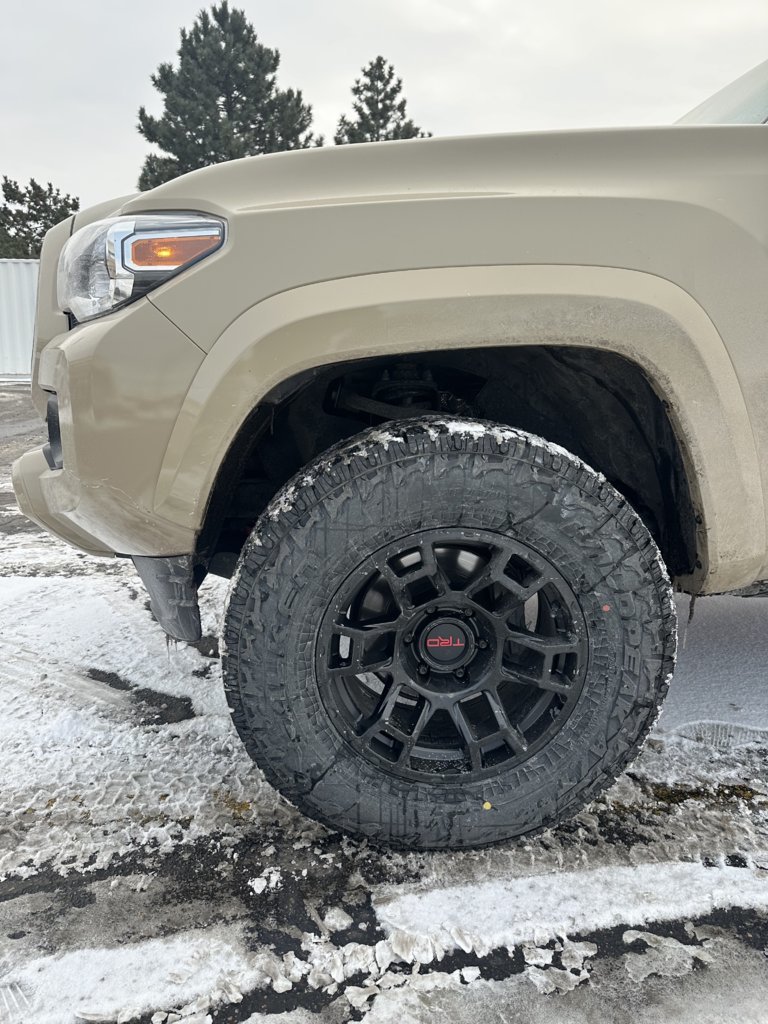

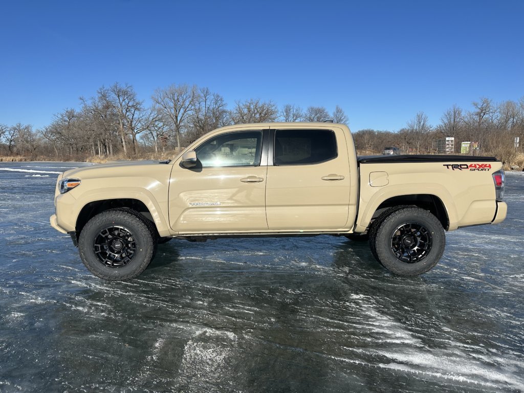

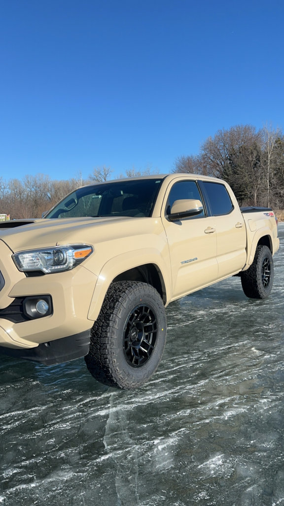

    Ended up going with the matte black Wheel Replicas Voxx Toyota Pro wheels from Discount Tire, Falken Wildpeak AT4s (265/70/17), and red TRD center caps (PT280-34200-02) from Sparks Parts. Crazy how just new wheels and tires can make such a big difference in the look of the truck.
    Planning to black out the Tacoma emblems and tailgate insert once it gets a little bit warmer.
