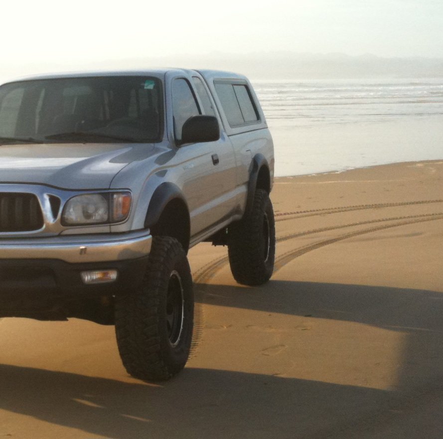

    Not sure what you're looking for in the photo, but I dug up this old one that kind of shows how the wheels fit.
    It would be easier for you to look up and read about offset vs backspacing rather than have me try to explain. They are pretty easy to understand, especially back spacing, but harder for me to explain haha.
    I ran 265 75 16's (roughly 32") on the factory 4.5" backspace wheels for a long time, and had almost no rubbing. The rubbing was so minor and rare it was unnoticeable. The 4" BS wheel would eliminate any frame rub with that size tire.

    Awesome thanks for the feedback and pic. Looks great I think I will be going with these wheels unless there's a cheaper place to get them
