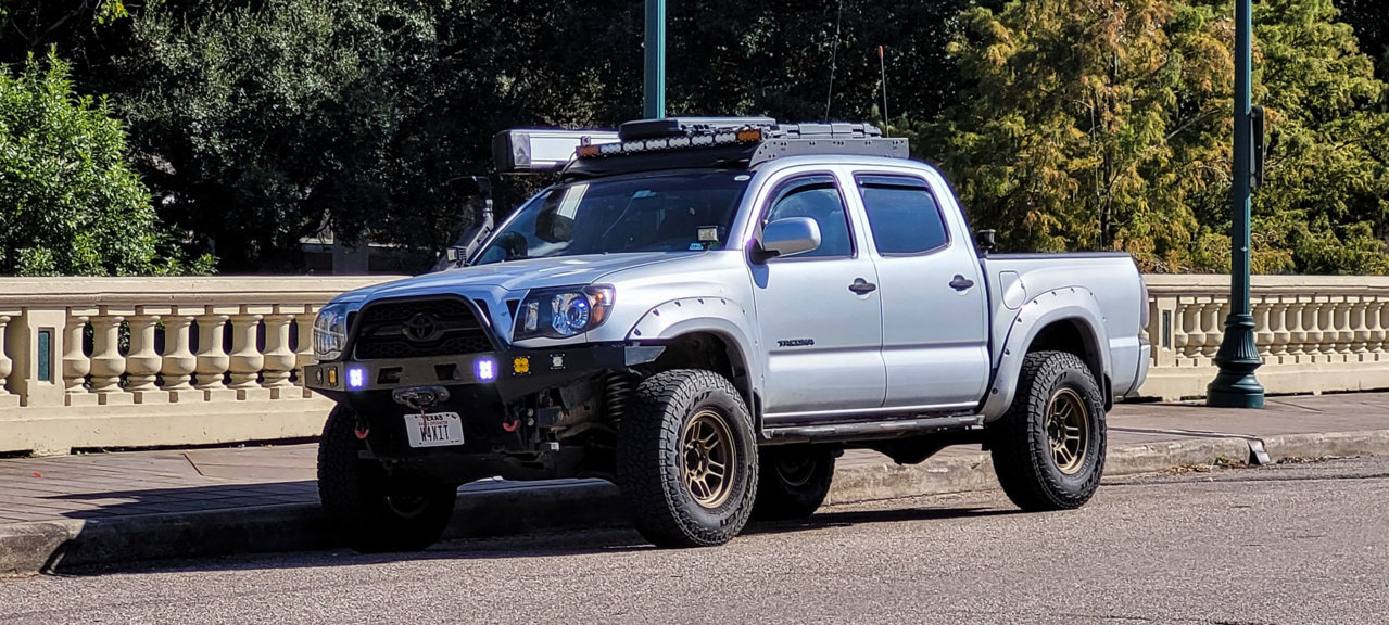

    Wheel specs are one thing and can be learned easily by alot resources on TW and Google.
    The one thing most people won't tell you is consideration of the wheel weight. Heavy wheels increase your rotational mass considerably and thus, the power required to put the wheels into motion.
    I would try and mitigate this by carefully researching your desired wheel and tire carefully.
    My 07 came with 16x7 wheels (32lbs) and 275/45 tires weighed in at 65lbs
    The new wheels (enkei rpt1 18lbs) and tires (Wildpeaks AT3W LT285/75R16 60lbs) weigh in at 78lbs
    So, a 13lb difference which negates to a less loss of power but is still there.
    For comparison, my friend with pro comp 17x8 and wildpeak lt315/75 weighs in at nearly 108lbs.
    Typically in the motorsport world, 100lbs if weight is somewhat equal to 10hp of power.
    So with simple math, my setup is 1.2x less efficient and my friend is 1.58x less efficient than the stock wheel setup.
    Just some food for thought.

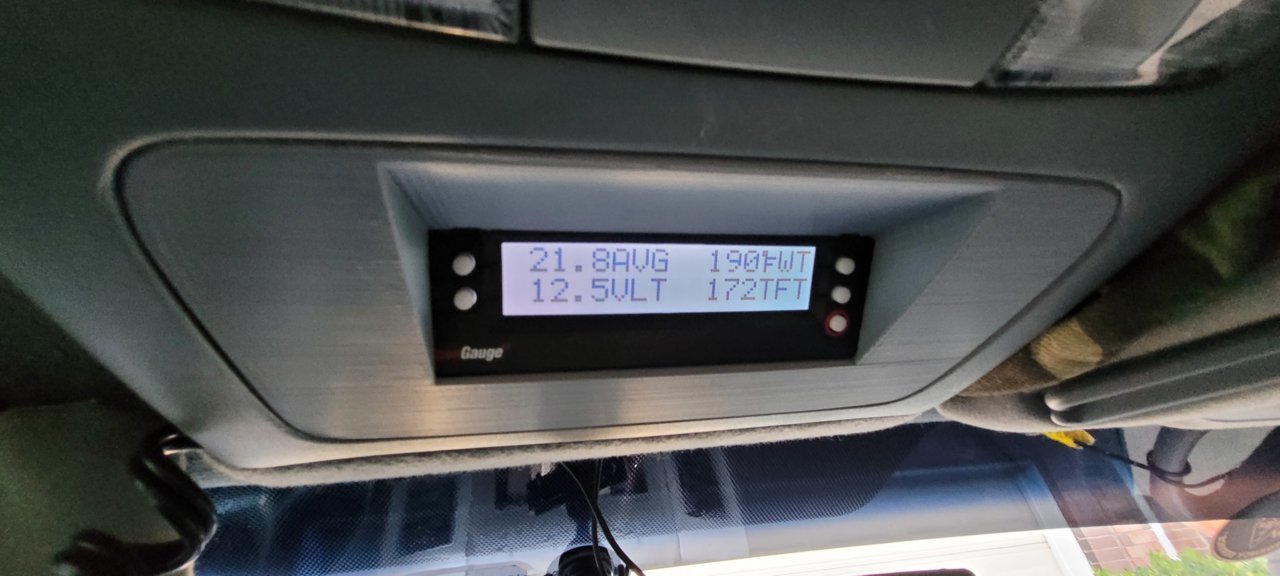

    Here's some pictures for your reference. Yeah my mpg is awesome, most members here think it's bs but hey 18 gallons fill up and 360-380 miles a tank seems ludicrous anyway.
