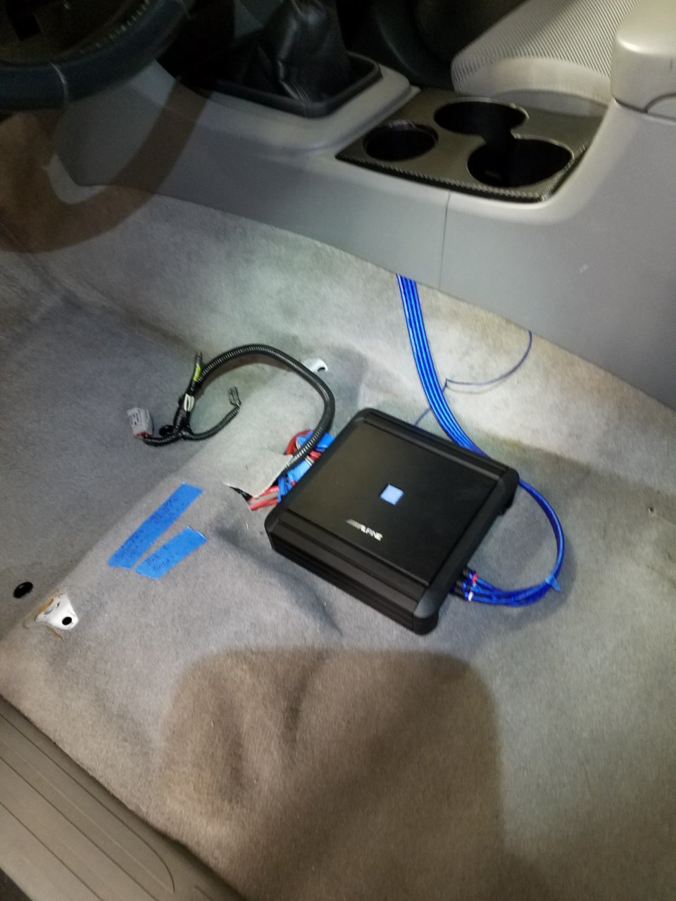

    Okay, so today while working on my taco, I decided to adjust the gain on my amplifier (Alpine MRV-F300) and re route some wires (RCA cables and signal wire to be exact). First, I adjusted the gain, and tested it out, everything at this point worked just fine. Next, I unplugged the RCA cables and the signal wire to reroute them under the carpet from the center counsel. After this, I plugged everything back into the correct place as it was before, and the rear right speaker stopped working...... I did everything correct to my knowledge, unplugged the battery etc etc... The only thing I unplugged were the two sets of wires listed above, nothing else was messed with. I tried swapping all the RCA cables around, and all the cables worked just fine. First I thought It was the amp, so I ran to cartoys and swapped it out with a new one. Got it all installed and it's the same issue. So, sorry for the long post but I am trying to be descriptive as possible. Any ideas?

    The only wires the
    The only wires the Rca cables are next to is the signal wire. Which they were by before I changed the routing. I just went under the carpet instead of over it. Here's a before picture

    I just went under the carpet from the center console with the 4 Rcas and the signal

    Is the amp bridgeable? Maybe you just hit a switch.

    I'll have to double check, but on my amp, channel 1 and 2 are together, as well as 3 and 4. So if I hit a switch, both speakers on that section wouldn't work. In this case, my entire right side would be silent.

    Because that's how bridging works, or at least that's how my ADS amp responds. Must have hit it while vacuuming. Switched it back and speaker came back all good.
