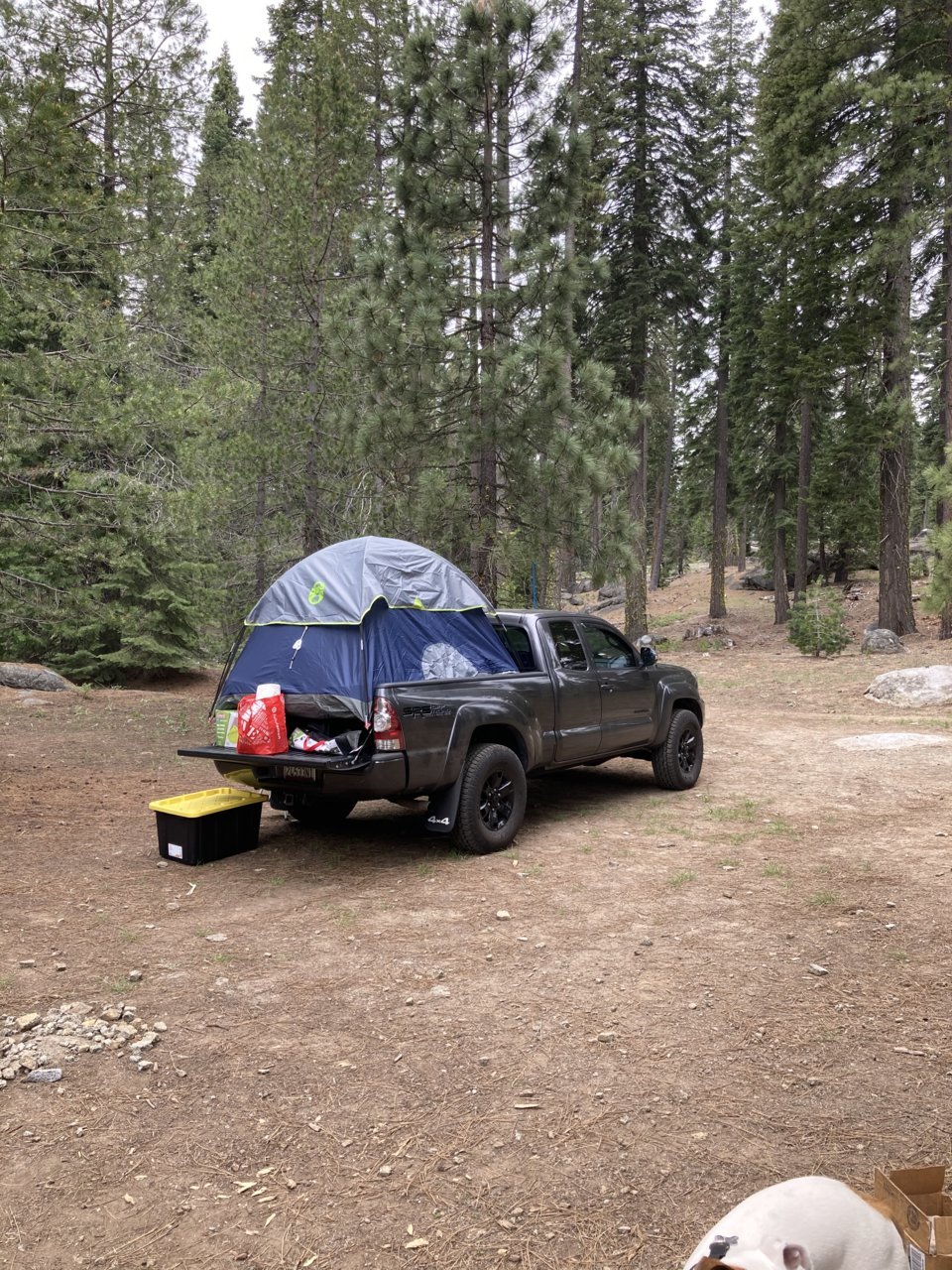

    gkomo
    gkomo Well-Known Member
    Nov 16, 2015
    #169821
    2,188
    San Diego, CA
    2014 MGM AC SR5 4x4
    Nice looking truck you have there. Very similar to mine... 2014 MGM AC 4x4 SR with 265/16/75's. I added the 5100's all around but kept everything else stock. I had the front shocks set at the .85" perch setting. It sits almost level (very slight rake still). Our truck usage seems about the same as well. Some light offroading but nothing hardcore. My plan eventually is similar to yours. I really want a minimal lift but with quality components. So i'll eventually do real aftermarket springs up front and some sort of small lift leaf pack in the rear. For now it's perfect though. I bought my 4x4 for snow, not rock crawling so a lift is not really what I need... but for aesthetics I would like something slight bigger than stock.
    Here's the most recent photo of my set up. Back is only weighed down with the bed/tent platform I built. So maybe only like 50-75lbs total back there:
    **don't mind the "SR5" bedside decals. I had them made before I realized mine was just a SR.
