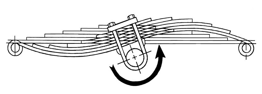

    Definitely do not want squat lol. Would blocks fix it or not?

    Blocks are bad. They would just wear your springs out faster.

    Thanks guys! Why would blocks wear the springs out faster? I havent noticed any problems with springs or blocks on my tahoe

    Blocks cause axle wrap. The picture is showing axle wrap. It really stress’s the leaf springs.

    A one inch block probably wouldn’t be that bad, but the taller the block the worse the axle wrap will get unless you got a traction bar or something.

    Some of the X runner guys run traction bars

    Don't use blocks. They are straight horse shit/ junk/ garbage/ worthless. If anything you'll probably be best served with an AAL from a good company. Dakars are an entire leaf pack from OME out of Australia.
