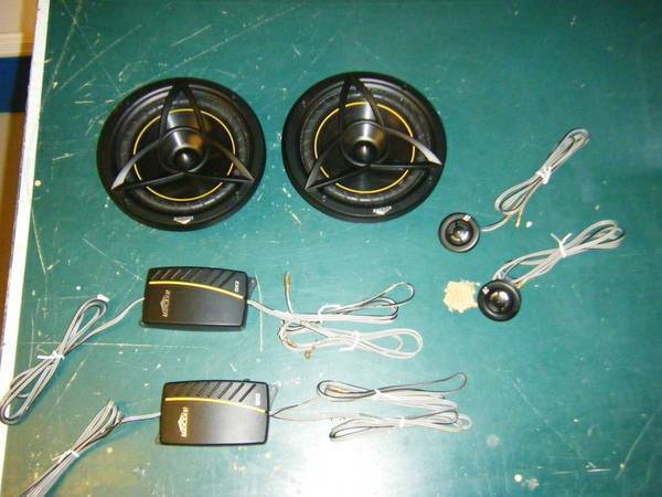

    alright, finally got a chance to take some pictures of the kicker setup.....
    here is a picture of the kit that i started with. it came with everything in the picture, plus some hardware and some different fittings to help mount the tweeters.

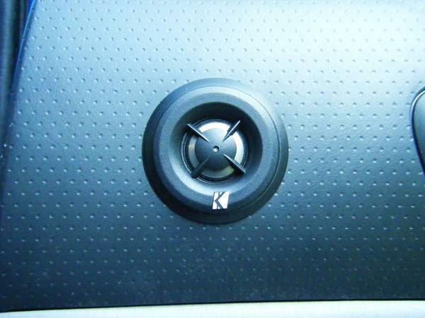

    here's a close-up of the tweeter. to make it look nice and mount flush, i used a little plastic trim pieve that it came with. (it is the outer ring around the tweeter)

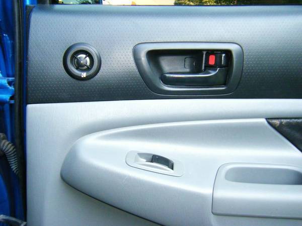

    for asthetics, i mounted it in a similar location on the door as the front tweeters are located. it actually turned out to be a great spot, because there is a lot of open space behind that part of the door since it curves out at that location

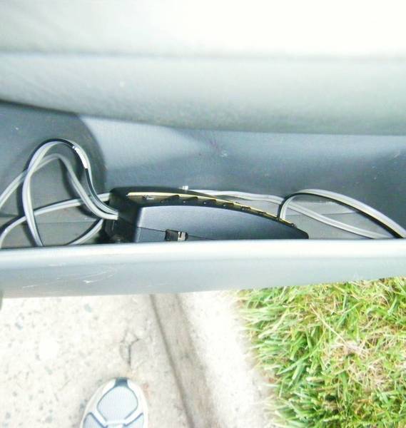

    I was planning on mounting the crossovers behind the door panels. but the Kicker crossovers have a 0db, +3db, and +6db setting, so i ended up making sure i had access to that switch in case i ever wanted to play around with it.

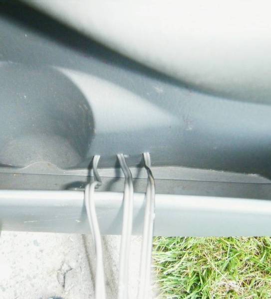

    here's how i ran the wires to it

    Hey that looks good. How do they sound?
    Thanks for the pics.

    they sound better than i could have asked for...i've always had my stereo ballance either at zero, or more to the front of the cab, but with the kickers in the back, i've actually set the ballance at "rear 4" (it can go to 15 in either direction). the bass is great, and you don't lose the highs becasue of the new tweeters.
