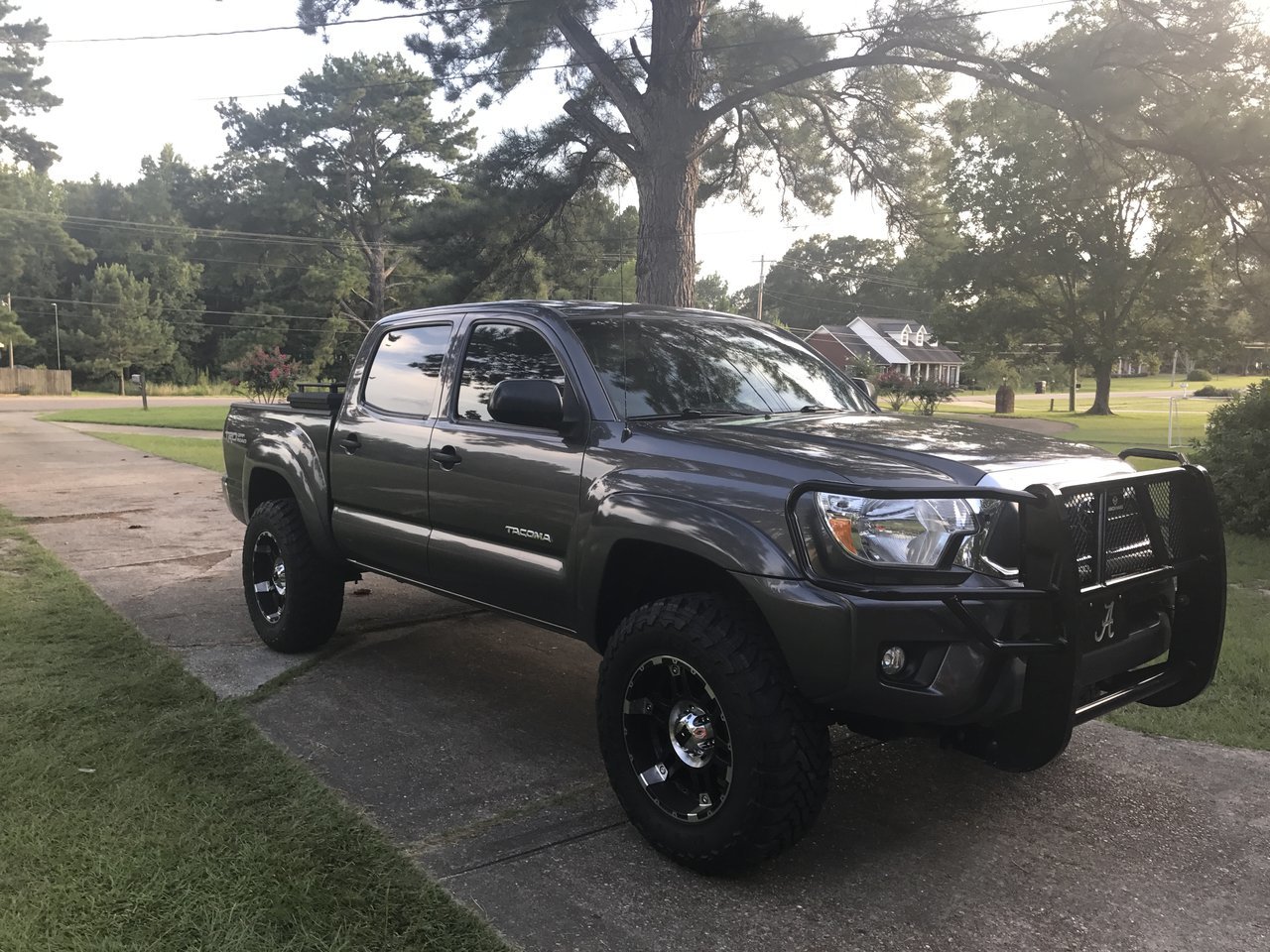

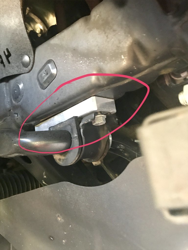

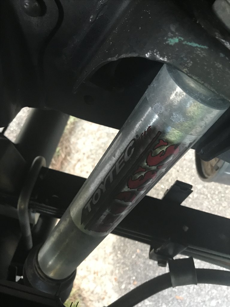

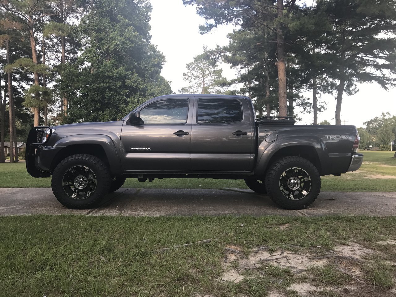

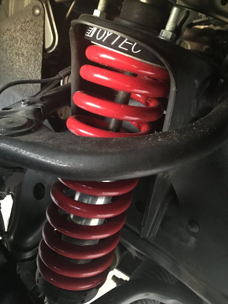

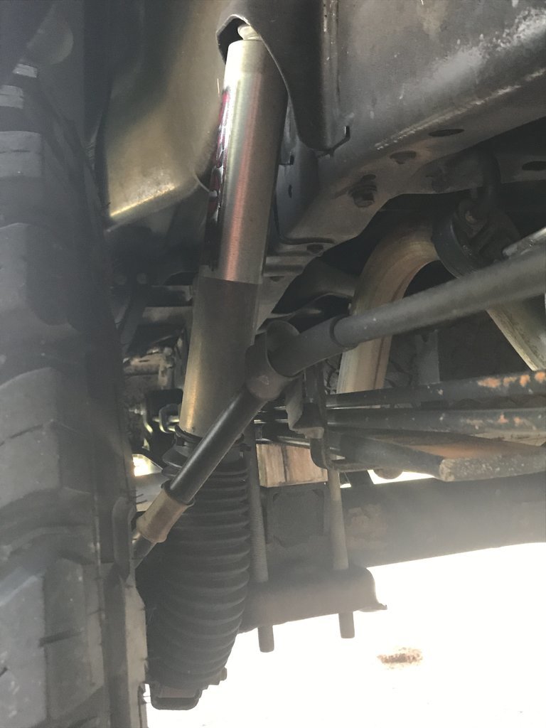

    Bought this truck 2 weeks ago. '12 DCSB OR 4x4 with Toyo open country m/t 275/70R18. Had a '08 prerunner purchased brand new and sold it last July. Loved the truck but wanted 4x4 and missed every second not having a Taco. These lifts and leveling kits are all new to me. Help me figure out what all has been done to it. From what I've gathered by reading threads it's got a Toytec Boss 3"? Complete Lift, coil overs and leveling kit. Not sure if a leaf has been added. Really love the truck and the look/stance. MPG caught me off gaurd14.5-15. The picture with the circle I'm not really sure if it is part of the lift or leveling kit. Thanks in advance for the knowledge. Great forum. The first 3 underneath pics are front passenger and the next 3 underneath pics are rear passenger.IMG_0671.jpgIMG_0665.jpgIMG_0664.jpgIMG_0662.jpgIMG_0663.jpgIMG_0661.jpgIMG_0660.jpgIMG_0659.jpg

    Is that a wooden block under your leaf springs??
    Hopefully it is steel and just looks like wood.

    You have toytech boss 2.5" adjustable from 0-3" coilovers with a 1.5" lift block in the back on stock leaf springs. The part you circled is a sway bar relocation block which move the sway bar foward 1" to clear the coilover

    What is circled in red is a sway bar lowering block. Used with lift kits when you approach 3".

    No not wood. Lol

    Nice rig I'd get rid of rear spacer if you off-road much get an aal it will ride better an maybe some UCAS to get the full benefit from your coilovers.

    Toytec boss coilovers and shocks with what appears to be a stock leaf pack and a lift block, as well as a brush guard that needs to be taken off:duel::D

    The brush guard is something that will be coming off. Myself I wouldn't have put it on there but was on it when I got it.

    Nice ride man. This is exactly what I want my truck looking like; including the brush guard. I'm in the middle of saving the money to get the lift, tires and rims all at one time instead of having it look like a gym-rat who skipped leg day. Also, I have a friend of mine who has always had a set up using 275/70R18's, he has just experimented with different brands. He claims that he noticed a pretty significant decrease in MPG running the Toyo's compared to others because they were so heavy? Idk, but just figured I'd share.
