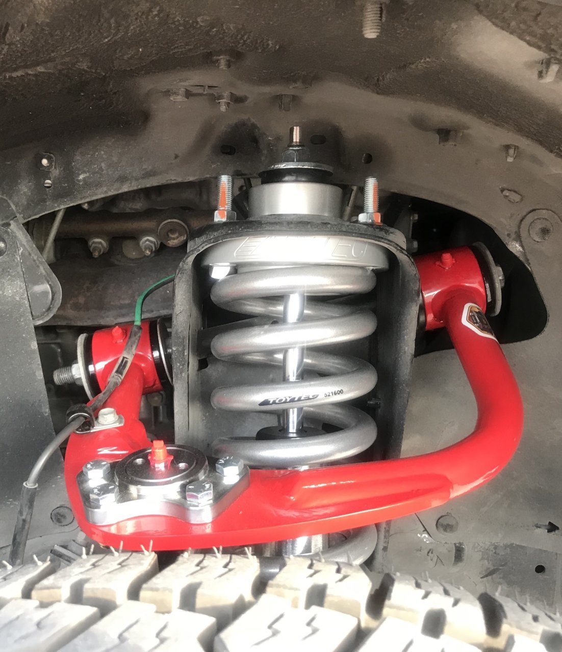

    I really like the Toytec coilovers(preassembled) just bolt them in. Th jba ucas come with 2* of built caster so getting the alignment where i wanted was zero issue.
  6. Sep 24, 2019 at 4:20 PM
    gotoman1969
    gotoman1969 Well-Known Member
    May 30, 2018
    #254966
    6,898
    Steve
    San Antonio, TX United States
    2015 Silver Tacoma PreRunner
    3" ToyTec coilovers, JBA UCA's, Bilstein 5100's
    Here a pic of my front set up. I’d go with the jba’s from a serviceability standpoint super easy. 1BE7FD07-388A-40E6-90EF-DA2AB733DAB9.jpg

    Love that, and sounds like theyve had them out for a while and worked out any kinks that the early versions had too. Thanks for the adivce, I think ill be picking up those UCA's first, and then soon after ill be grabbing those toytec coilovers.
