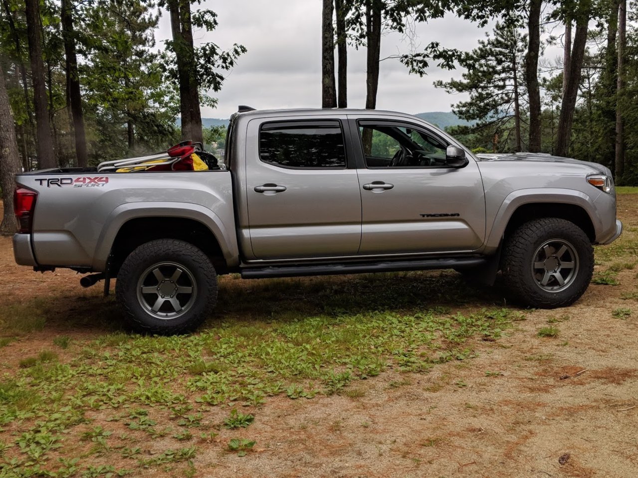

    Mine isn't 4x2 but I put:
    5100s all around with Rogue Offroad 1-1/2" AAL (bought as a kit from Rogue) $411.35
    OME 884 springs $174.99
    Headstrong 1/4" spacer for driver side $29.99
    Level 8 MK6 0 offset
    Falken Wildpeak AT3w 265 70 17
    No needle bearing issues.
    I am 85% on road, with some sketchy camping...
