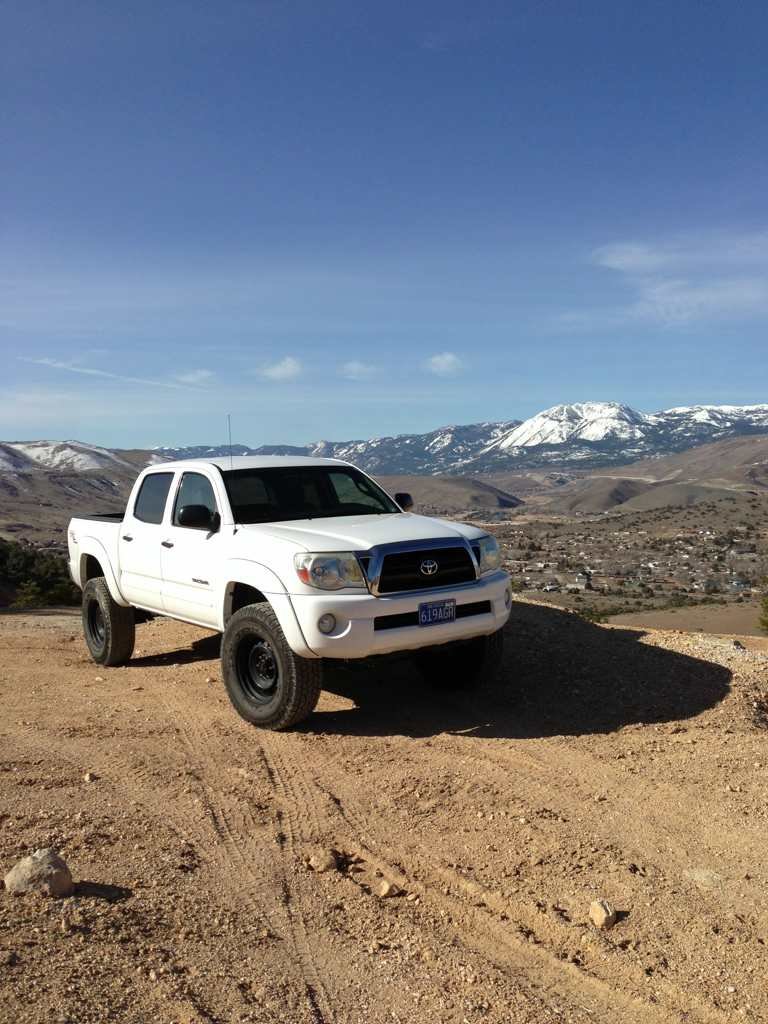

    Bilstein 5100 up front set at 2.5, tuff country Add a leaf in the back and 285/75/17 on Tundra black steelies.
    You can always go with tundra 17in steelies. I love the look and fit perfect, no spacers.u4esugyv_3f9a74a0c0e499fbae5e9e2c6a232f5ae0cb1a82.jpg
