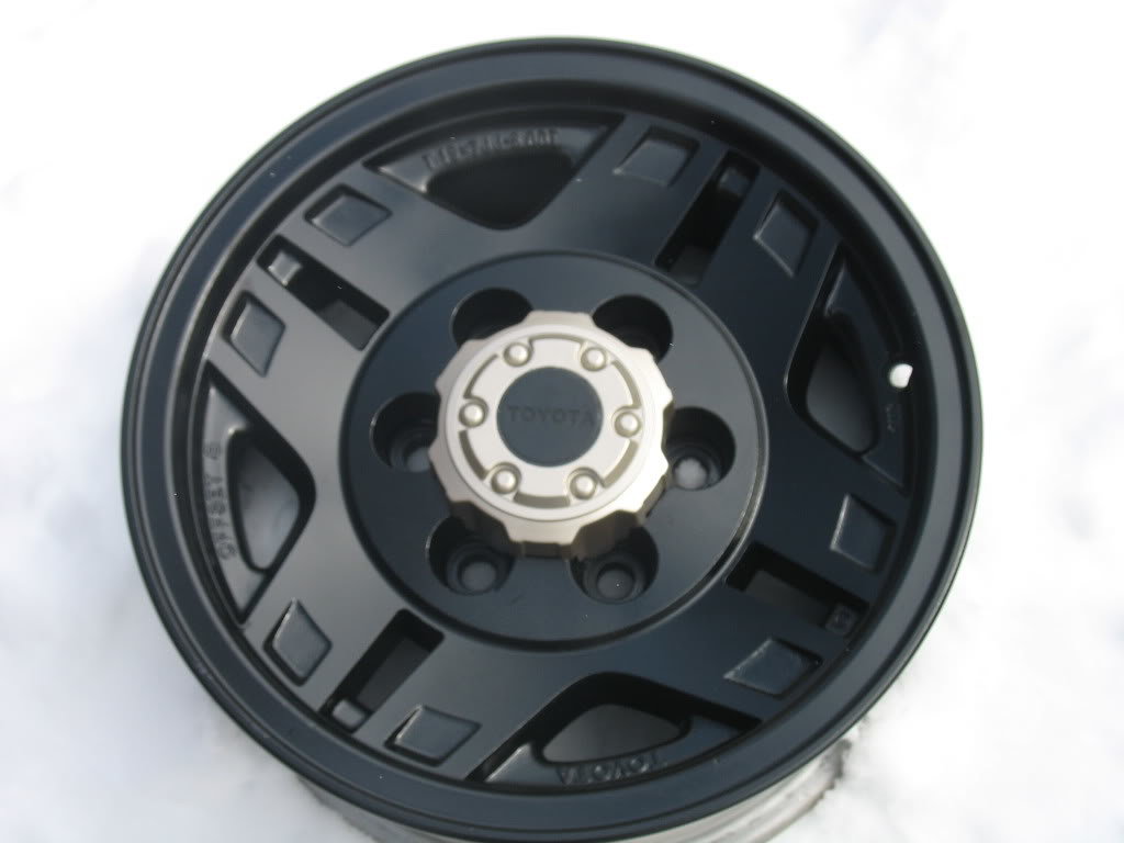

    Got my 1st taco (2001 4x4) 2 weeks ago....has 16 inch steel wheels.....will old 4runner alloys 15 inch (1990-1995) fit without issues???
    Thanks for your help...this is an amazing forum!!!!
    PS..I do realize that I will have to increase my tire size (height) for speedo, gearing etc

    No....figured it out on my own...funny you brought this up Boxrocket as this was one of my first posts ever on TW!!
    Running my summer tires on them after I sandblasted and painted them

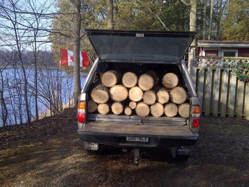

    Only trouble is the dakars will not settle with the D6XLs on....carrying 4 patio stones around and the ride is great but when I take them out the rear goes up 1.5 inches and choppy ride
    I guess I'll start carrying some gear around to weigh her down instead of the patio stones
    Put a load of wood on yesterday and she handled great!

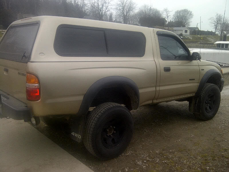

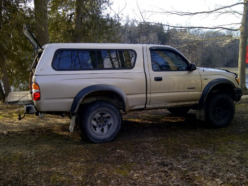

    Here it is with the patio stones and the wood
    Ashfield-Colborne-Wawanosh-20120205-0037_c179519773b29ebb4a185ce14925ddab5050513f.jpg
    no load at all
    just the 350 lbs of patio stones
