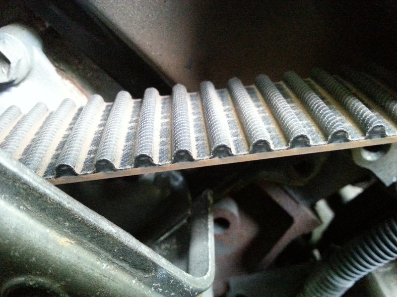

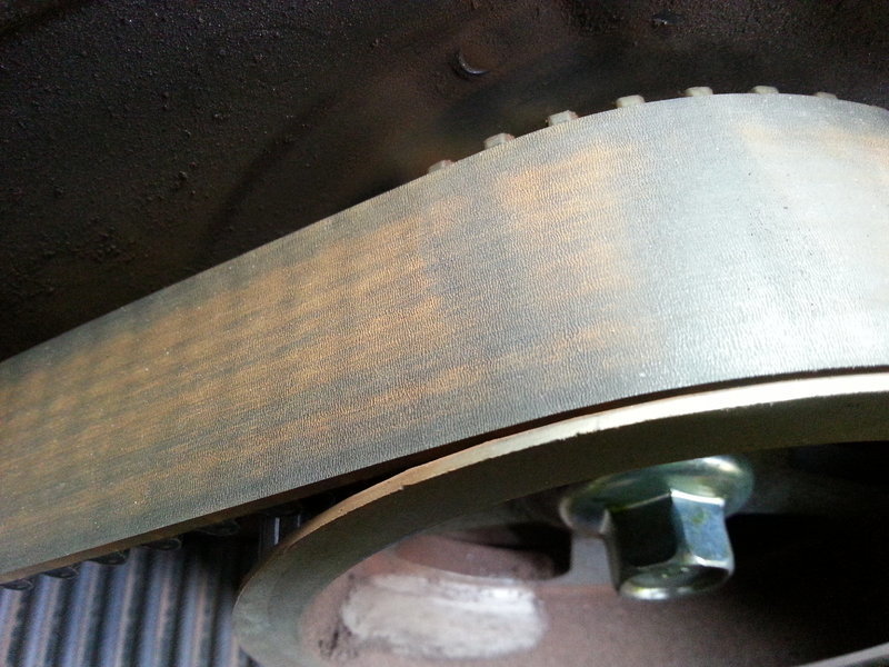

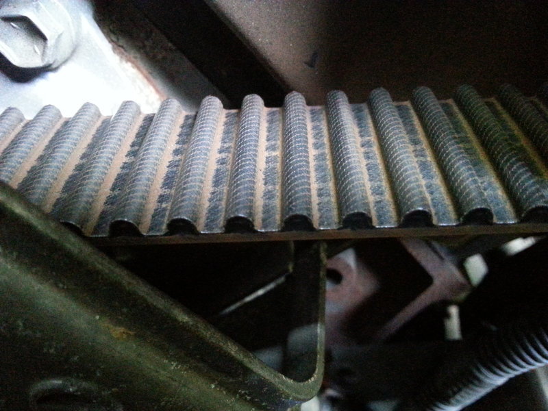

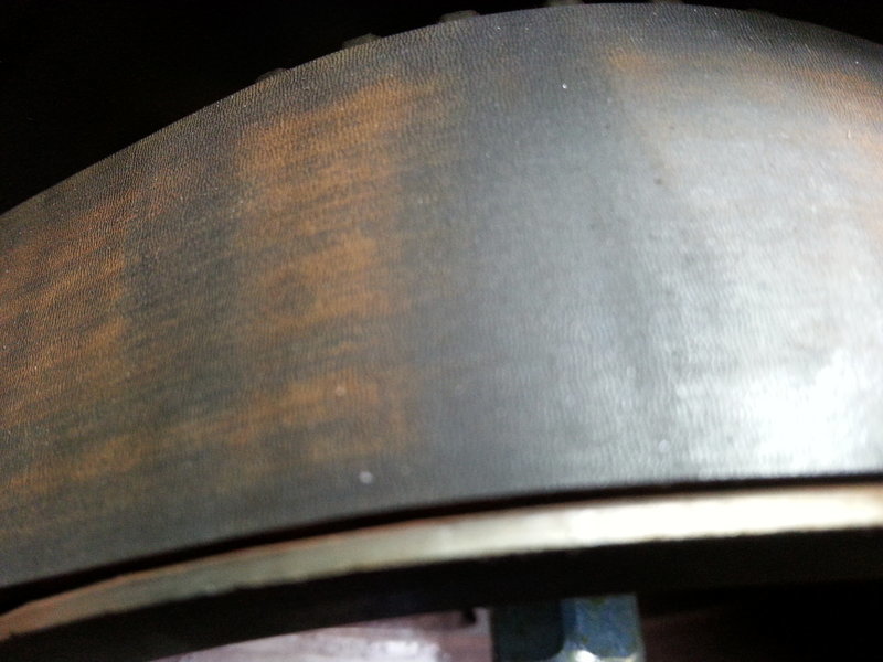

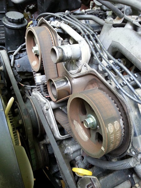

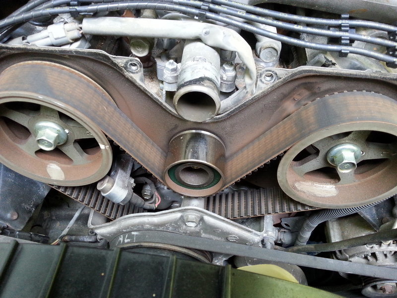

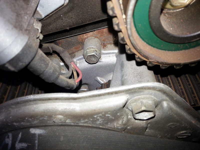

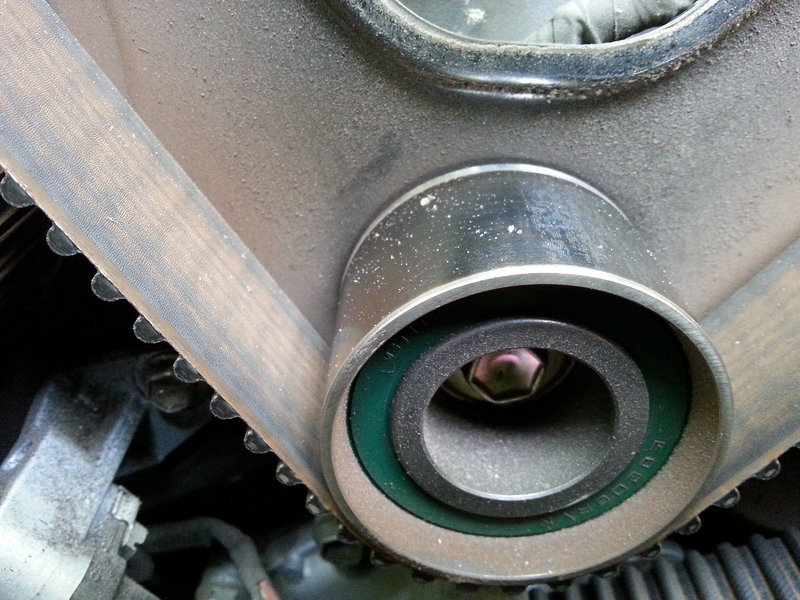

    Here is the story. I just bought a 2001 V6 3.4L 4x4 Dbl cab with 240k miles. I was ready to replace the timing belt, but I saw a gates timing sticker. It is blank, but the OEM spot is filled in at 94k in 2006. So I decided to pull the cover and take a look.
    The idler pulley looks great, but the belt and Cam pulleys are extremely dusty/dirty. No oil leak though, thank goodness. I know the previous owner lived on a dirt road.
    My question is, should I still have the belt and water pump replaced? Why put the Gates sticker on and not fill it out? Surely they did not fill out the OEM sticker instead of the Gates. Here are some pics. I wiped my finger across the inside cam pulleys and over the belt on the driver side cam pulley, to show the difference of dirt Vs. clean as you can see in pic 5.
    Thanks Guys!

    I believe the t-belt along with the water pump should be replace every 105k miles (though Ive seen the water pump seep way before its time to replace). hell, I didn't replace mine until 220k miles and it still look good beside the water pump seep lol.

    since we don't know when the last mileage was recorded (unknown mileage on gates sticker), it wont hurt to replace it since you'll know for sure that it was done and the mileage is noted. also you have 240k so the belt should of been replace twice already. Maybe the gate sticker was the second time around.

    Yeah, the belt looks great to me, so I am guessing it was the 3rd belt for this truck. I am just trying to decide if it has to be done right now or if I can wait a year or so.

    90K is the interval that Toyota recommends.
    Are you sure that Gates sticker wasn't filled out and the pen ink hasn't just faded? In the pic, it looks that way. :notsure:
    A new truck will not have an OEM sticker on it. When Toyota does the 90K service they will put the OEM sticker on it. At least that is the way mine is.
    If I were to guess, I'd say yours has been changed twice, at 90K and again at 180K :)notsure:), 270K might be the next time.
    As mentioned, it is typically the water pump that is most critical, not the belt. At 90K my water pump was starting to seep. A dried pink stain (or the color of your anti-freeze) below the pump in an indicator its time to change it.

    Thanks for the info. So they do not come with the OEM sticker when they are new and probably only put on when they have the belt replaced. I did not know that.
    I have looked around the water pump (at least what is visible) and see a bit of coolant sprayed on it from the radiator leak that was present a while back. No puddle or drip spots though. I think I may add some dye and check the water pump for leaks again tomorrow night. If it needs replacing, then I guess it all comes out, but I am hoping to delay that for a while ;)

    not from the top but from the bottom. the fan bracket needs to come off unless you can see the bottom of the water pump.
