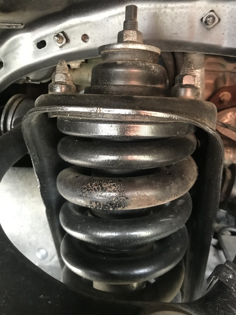

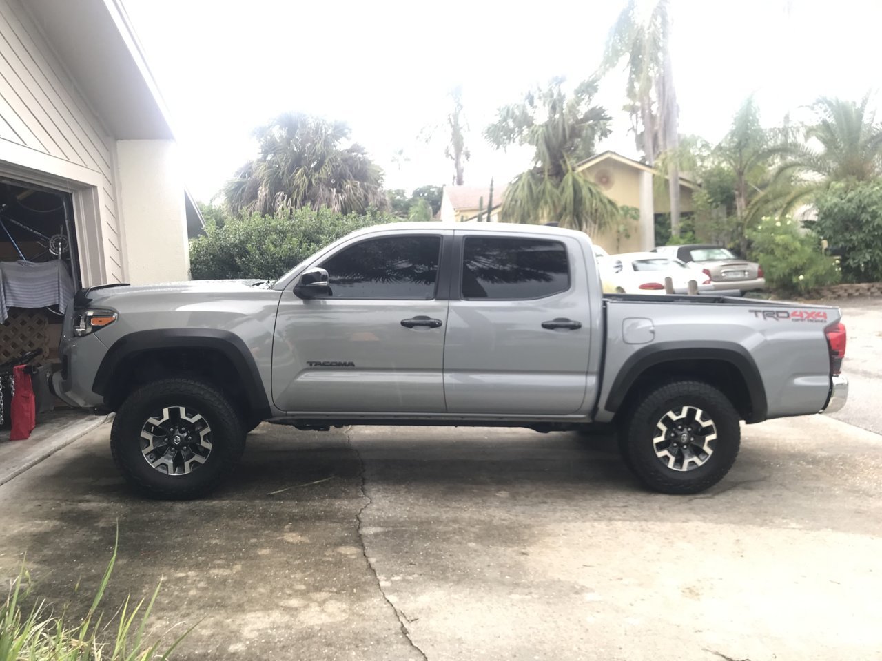

    Second, I have noticed that there is a distinct rake from front to rear and measuring from the center of the wheel to the fender edge I have 22.5" front and 21" rear. I do not see any lift or leveling components on the front strut or rear springs/shock. So what gives?

    That truck is lifted at least in the front but it was done by replacing the shocks/ coil springs so there is nothing that looks out of ordinary, but componets have been changed

    I thought that may be what has occurred with the front end. Same brand of Bilstein shock as stock TRD but no idea of the springs. So I guess this is great, I get to lift up the rear for 1/2 price of total lift?

    Welcome to TW..It’s got the Bro lean…

    MPGs are good. On the bright side, your on your way to the Carolina Squat.

    Thanks again everyone. Since it appears the front has been lifted (22.5" versus stock 20") and the rear is at the stock 21", I have the choice of replacing the fronts back to stock struts or lifting the back. I have read numerous comments against blocks in the rear (especially towing?) so am considering new leaf spring stack. If I go with a leaf spring stack for heavy load, will that handle poorly without the trailer? Also, preferences for leaf stack for 2"-2.5" lift without sag with trailer...........
