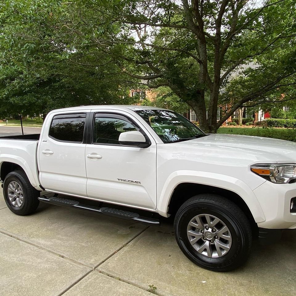

    Picture of factory rims and current tires:

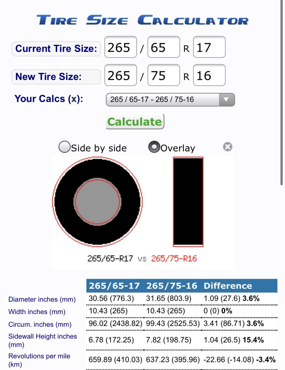

    Below is a chart indicating your tire size preference with your 17 inch rim size (in black).
    You’ll notice in the (red) overlay this is representing 265/75r16 tire size. That’s what I currently run on my Tacoma.
    With that being said, the tire size should not be an issue for the truck without a lift. I can’t comment on the -12 vs 0 offset for the following reason. The picture I’ve included below, is of my previous SR5 truck with no lift and with that particular setup it was just the 16” rim with 0 offset and 265/75R16 tires. I had no wheel spacers at that time on my truck so that’s why I can’t comment on the -12 offset for a stock truck. I had no issues with rubbing with my setup. There were maybe 2 times I noticed a slight rub when turning and hitting a large bump at the same time. But was VERY rare. So your son will be good to go!!

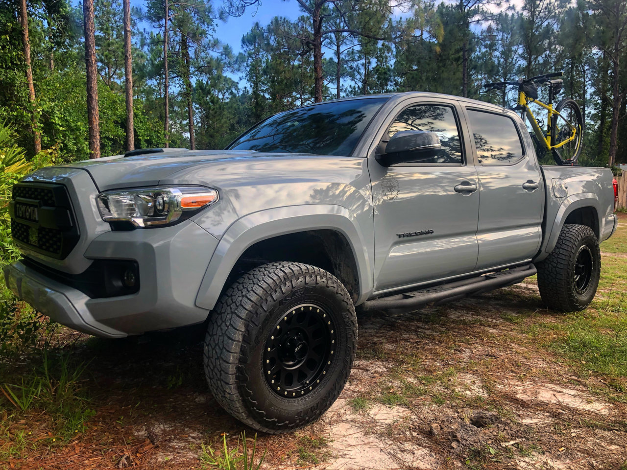

    Just so you are aware, my current configuration has me with the exact same wheel and tire setup as above 265/75R16 but with 1.25” wheel spacers. I also have a 2 inch lift on my Cement color truck and once I added the spacers it definitely rubbed even with the 2 inch lift. It took some minor trimming of some plastic to fix but wanted to let you know for future reference.
    Obviously it’s always better to purchase a wheel with the proper offset if he’s looking for an aggressive stance over spacers. But that was the option I had since I wasn’t gonna go out and purchase new wheels right away. Hope this all helps.
