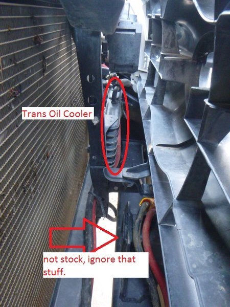

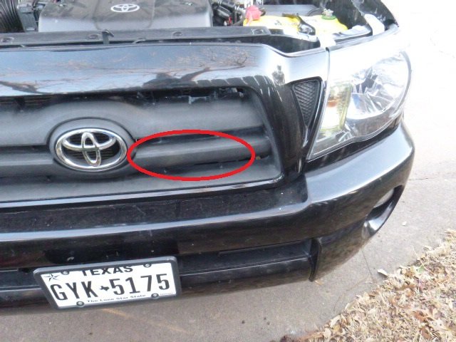

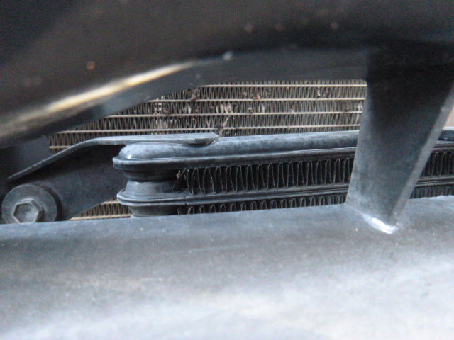

    If you get the 2nd gen version with a 4.0 it will have the same trans cooler mine has even though mine is older. It will be the easiest way to know for sure what the truck has. I can snap a pic of it if you like.

    Real tow-package Transmission Oil cooler:
    Same Drive-train as 13-15 Tacoma. Same part for transmission oil cooler.
