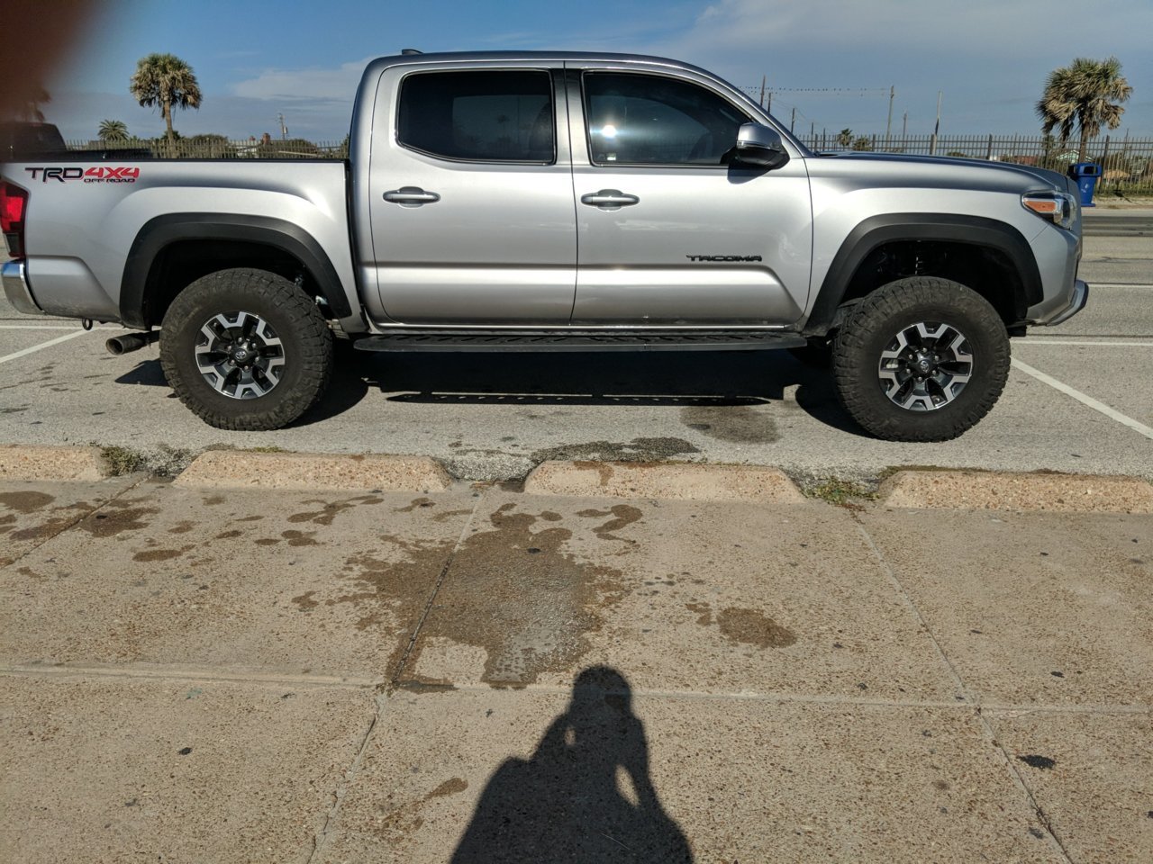

    Just have the 6112/5160 installed on my truck. I don't have bumper or winch though. Set the 6112 on notch 5 passenger and notch 6 driver. No add a leaf yet on the rear. So its a little higher in the front. Got an add a leaf coming next week to fix that. Tire size is 265/75 r16.

    Looks really good! How does it ride? Why are you adding the leaf instead of lowering the notch setting?

    Rides great! Adding the leaf so I can get the max lift out of it, and fix the bro lean.
