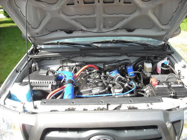

    Mod List
    Performance
    Alpine Supercharger
    Doug Thorley header
    Gibson cat-back exhaust
    Hellwig anti-sway bar
    PLX Wideband A/F meter
    Backwards helper leaf 'traction bar'

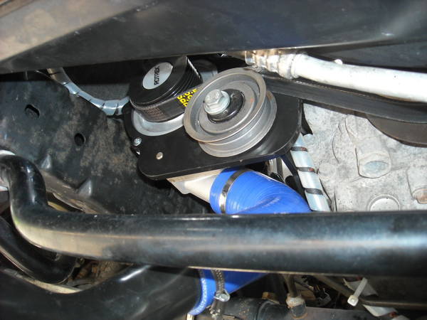

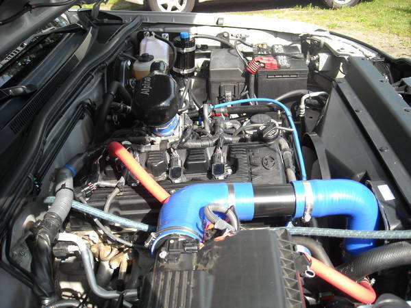

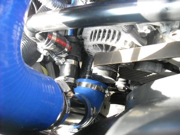

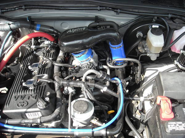

    Alpine Supercharger:

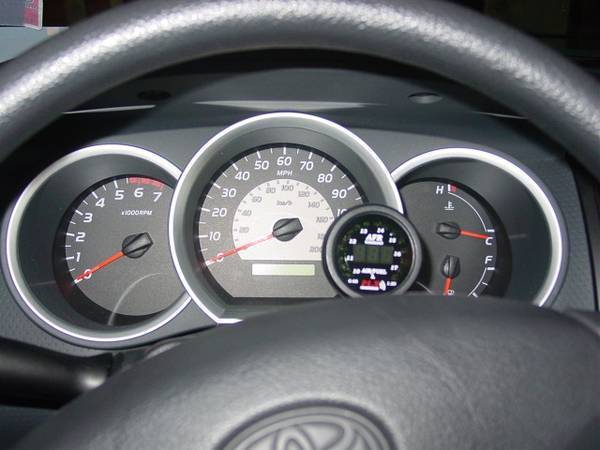

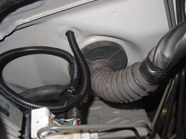

    Installing PLX A/F wideband, Stage 1
    I will be doing this installation in three stages due to time, mostly. Today, I ran the sensor harness through the firewall, and attached the gauge. I have a location for the "brains" of the unit and a power source picked out. I just need to find a place to ground it. The last stage will be having a shop weld in a bung for the sensor itself.
    Any tips on where to ground it? I may end up running the ground wire around the shifter assembly to the chassis, but it would be easier if there were a better spot I could reach in the cab itself.
    Cable through firewall:
    Mounted gauge:

    Nice! More NE tacos on here. Stage two is complete. I didn't take any pictures, though. Bringing the truck in Monday to have a bung welded in. Maybe someday I'll understand why I decided to spend all this money on a 4-banger pickup. Meh, you only live once, right! 4-5 weeks until Supercharger arrives.

    Installed the 'cheap traction bar' mod today. Went to Advance Auto and grabbed a $27 pair of helper leafs. Installed them backwards to hopefully eliminate axle wrap. I have the rivet on the highest tension setting. However, I am a little concerned that it will dig into the leaf and cause it to rust. Maybe, we shall see. Ride to work tomorrow will be the test run.

    Got a bung welded in. Truck runs in the low 14's normally, only derivates when in fuel cut while decelerating or for some reason mid 13's for a few seconds after coming to a stop. Looks great! Now I just have to keep my eyes off it and on the road!:rolleyes:

    where is the bung welded into? the top of the header?

    Bung for what? This is a supercharger, not a turbocharger (if that's what you're thinking of)

    I think he is talking about the afr gauge o2 bung.

    Oh, yeah, that makes sense. It's welded into the down pipe 4-6 inches downstream of the oxygen sensor. And I've been real curious about the X-Runner. Unfortunately, they don't sell them up here, haha.
