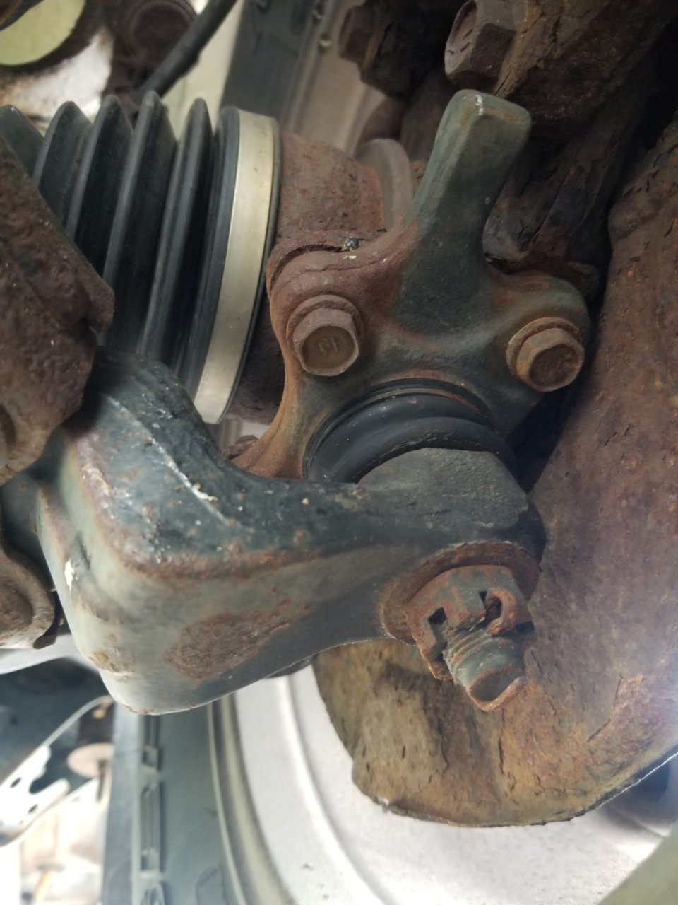

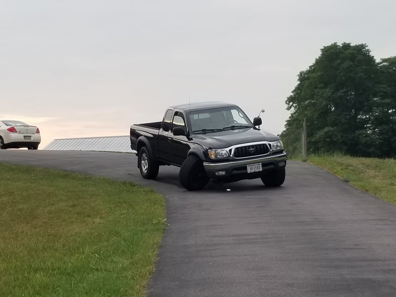

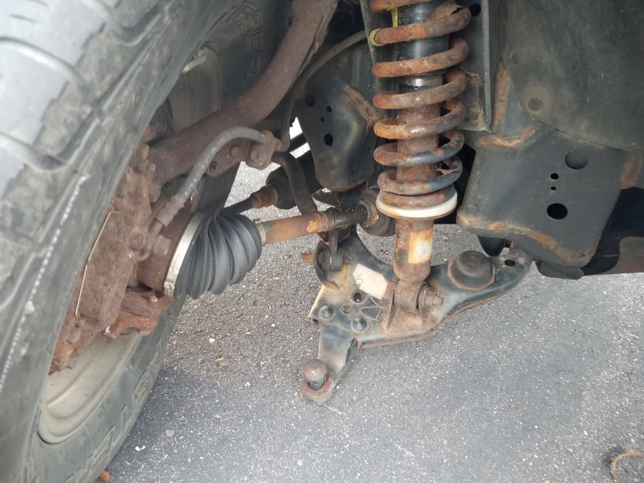

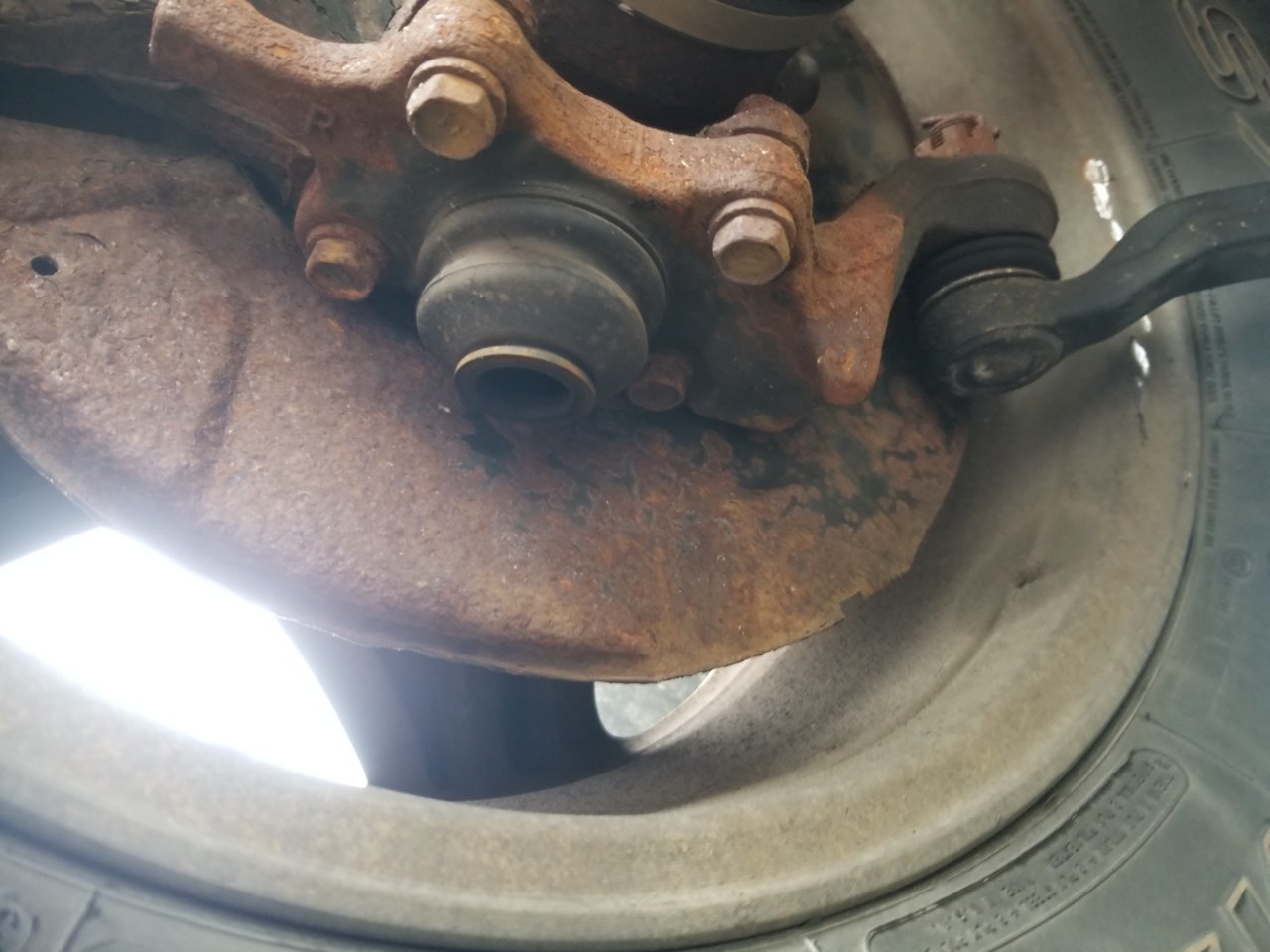

    First post here, on my way to the dump this morning and this happens. Glad it happened in my driveway. I was completely shocked as I had a bunch of work done last summer at my local Toyota garage including replacing both lower ball joints. After a closer look it doesn't look like they replaced the passenger side but I paid for it. I know this a common problem so I wanted to be pro active. I have attached a picture of the driver side for comparison. What are your thoughts??

    That ball joint is dryer then the Sahara desert. I can't see that thing being replaced just a year ago.

    It would've been a lot easier to tell a year ago. They seem to have similar levels of rust, which kinda makes it seem like they both are of similar age.
    How old were the ball joints that got replaced a year ago? Based upon how much rust these have in a year, you'd think the other one would be literal dust by now if they hadn't replaced it (assuming it was 5+ years old).

    Ball joint shouldn't have failed that soon.
    What does your invoice state as far as parts used? You should have everything itemized with a separate labor cost for the work.
    That aside, that's some nasty rust.
    How's the rear of the frame? Can't imagine it being safe if even your coils are that bad.

    Those are phosphate coated ball joints….the OEM ball joints are painted black.
    those are aftermarket junk.
    I used to be in the chassis parts business and I’ve cut apart every aftermarket Tacoma ball joint…with the exception of OEM…they’re all trash.

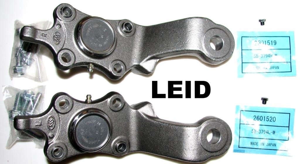

    The greaseable JAPAN 555 LBJs lasted me for 8 years and the non-greaseable OEM LBJs lasted me for 16 years. Same offroad abuse on both sets and I kept the 555s well-greased. You get more value for your money with the OEM LBJs, not to mention the peace of mind. So the 3rd set of LBJs on my '97 V6 Taco are OEMs.
    EDIT: I forgot to add that the boots on the 555 LBJs were not nearly as durable as the OEMs and both 555 boots had pin holes at 6 years which were patched with UltraBlack. At 16 years, the OEM boots were still very serviceable with no pin holes.
    OP: Good luck with your LBJ repair!
    These are the greaseable JAPAN Sankei 555 LBJs I installed in May 2013. I painted and sealed them with UltraBlack before installation and religiously kept them well-greased, probably after every 4 weeks of off-road use. Neither ball rotated smoothly after 8 years of use, so they were replaced with the non-greaseable OEM Toyota LBJs in the 04005-03235 "recall kit".
