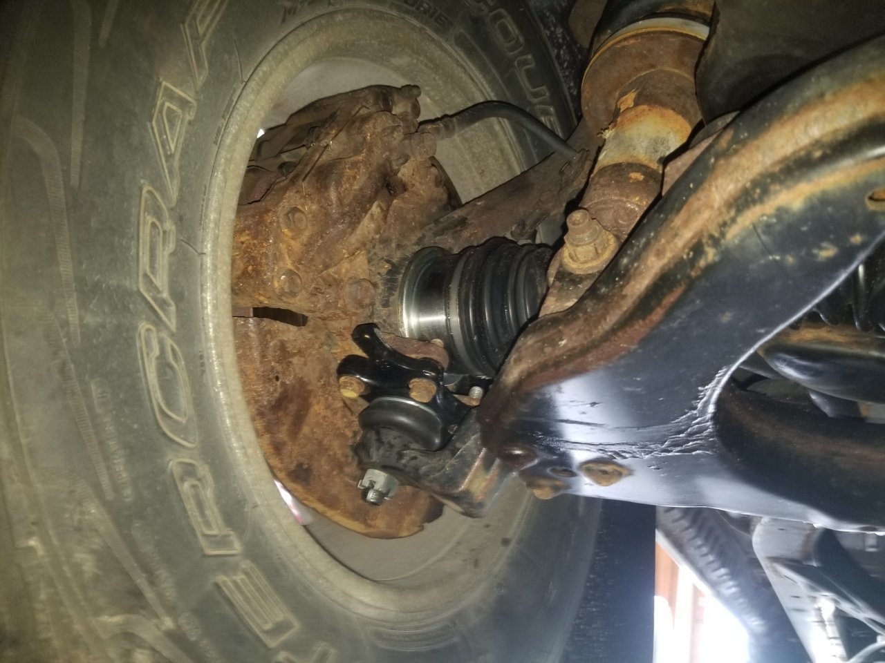

    Just to update as to how this story ends. The Toyota dealer installed new Toyota ball joints and repaired everything that got damaged under warranty. They claim that the ball joints were brand new last year but I dont believe that. I'll be looking elsewhere for service.

    It looks like they reused the four mounting bolts.

    Cocain 2003 3.4 4x4
    Unbelievable they reused the bolts. Good news is the LBJs should outlast everything else under that poor truck.

    Lol they didn't even replace the bolts, wow. Definitely don't go back there. I would just replace the bolts yourself

    Dude, buy some bolts and replace them yourself.

    That is some very sad workmanship, very half-assed IMO. Worth noting is that the LBJ bolts these "technicians" reused/reinstalled are the longer 90119-10933 black bolts used without the LBJ Protector. And who knows what value those reused black bolts were torqued to. If these reused black bolts were over torqued to 59 ft./lbs. (or more), this poor Taco may be in for another dive very soon. I would not be able to sleep well at night until replacing those used bolts with new 90119-10933 black bolts torqued to 37 ft./lbs. .02

    Yeah, I was shocked to see the old bolts in there too. The service manager I was dealing with left on vacation so I really had no one to bitch at. Those bolts will be replaced....total incompetence

    Sorry I'm late to reply, and you already got great responses regarding the bolts. As others said, the first choice would be the black bolts, torqued to 37 ft-lbs, or the ARP bolts torqued to 59 ft-lbs. I really dislike generic 10.9 bolts (including McMaster Carr) because they come with no pedigree and can vary a lot from batch to batch. My data shows that some generic bolts have 2X preload of others, not good.
    Most of these bolts can actually be torqued to 90 ft-lbs without breaking (except the black bolts), but they will yield at that torque. So if you torque a bolt to 90 ft-lbs, I'd replace it with a new one, not reuse it.
